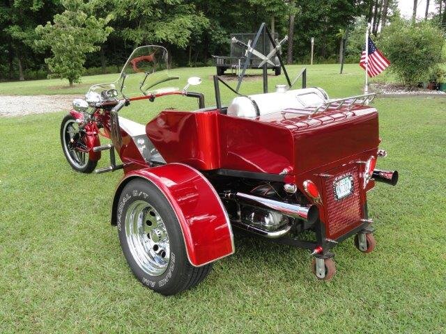

    Default Re: Post Your VW Trike Pictures HERE
    What it looks like today.
    [SIGPIC][/SIGPIC]Triker Walt

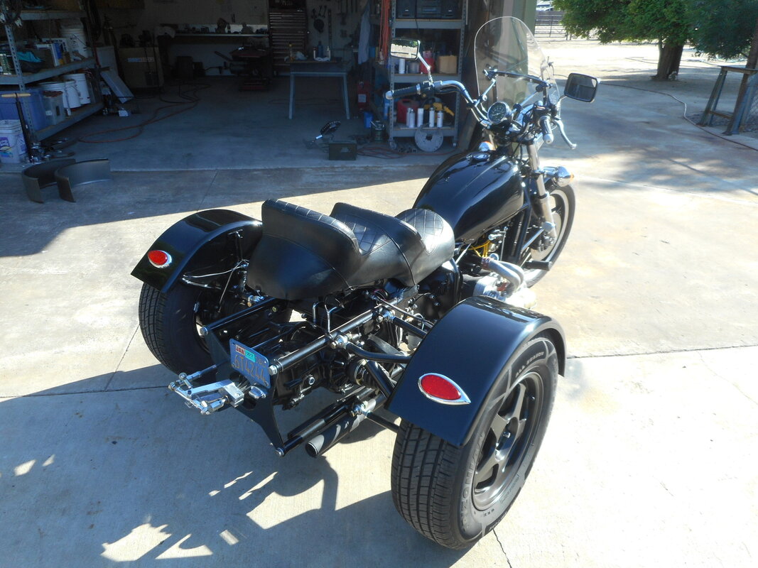

    A different kind of VW trike. 1.6L diesel.

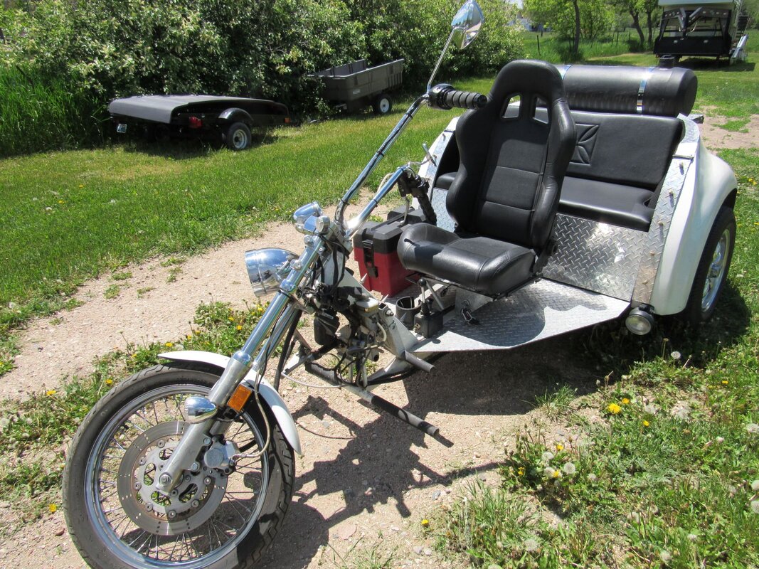

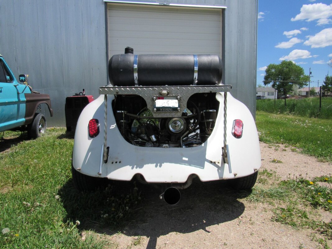

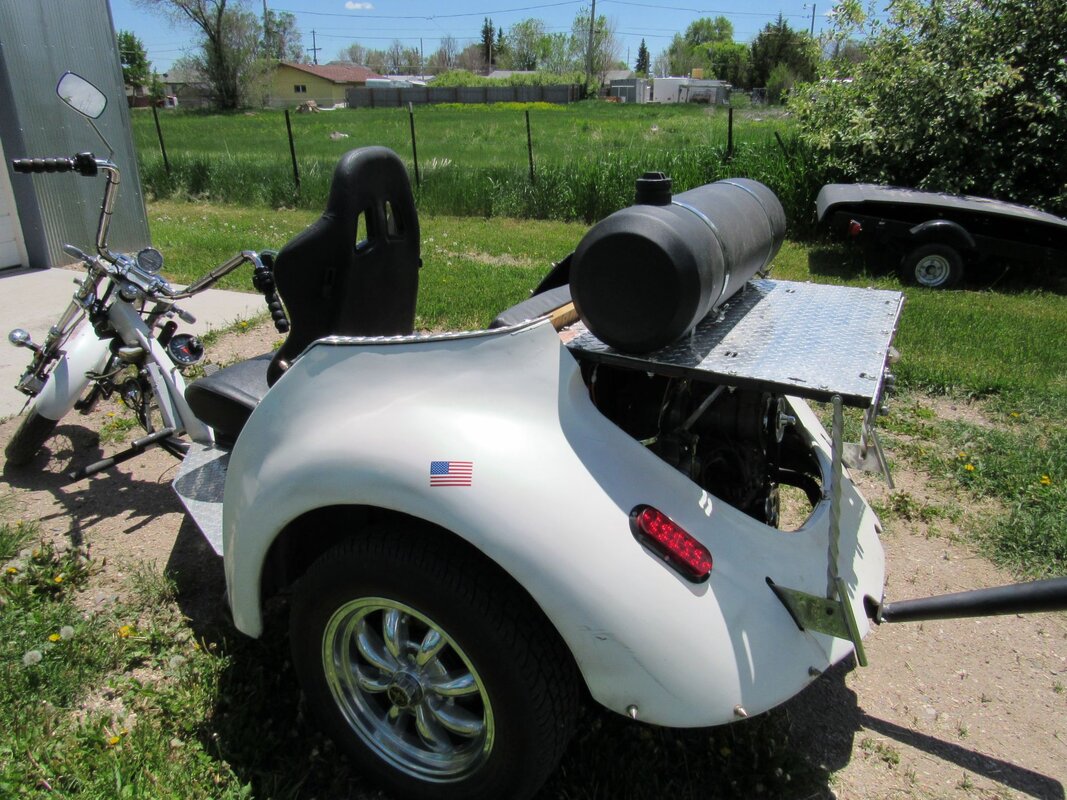

    Attachment 5237
    Front engine VW
  9. #79
    Old Redneck Motorhead
    VW Tech Contributor
    TrikeTalk Moderator
    DeathBySnuSnu's Avatar
    User ID
    7688
    Mar 2012
    Vicksburg MS USA
    1,069
    FT Author
    2 Threads
    Ok where to start. Engine is a 2110 stroker. 82mm super race crank. 90.5 Cima jugs. Eagle 2246 cam. Super case. 1.25 ratio rockers. 050 d-ported heads. 42mm in 37.5 out ss valves. 44 idf clone carbs. Somewhere around 160 hp. Trans is swing axle. Early (1965) short axle that is shortened 5 inch per side. Oiling and misc parts remachined to run upside down. Hd splined gear shafts. 1.26 third. 0.82 fourth. 3.44 Rancho ring and pinion. Billit side covers. Crown super diff. The chassis is a honda front end. Honda handle bars and controlls. Honda seat pan and trunk. The frame is water pipe frome home depot. Rear suspension is ss swing arms with cross mounted boat trailer spring. Fenders are axle mounted boat trailer units. Lots and lots of hand made pieces to make it all work.
