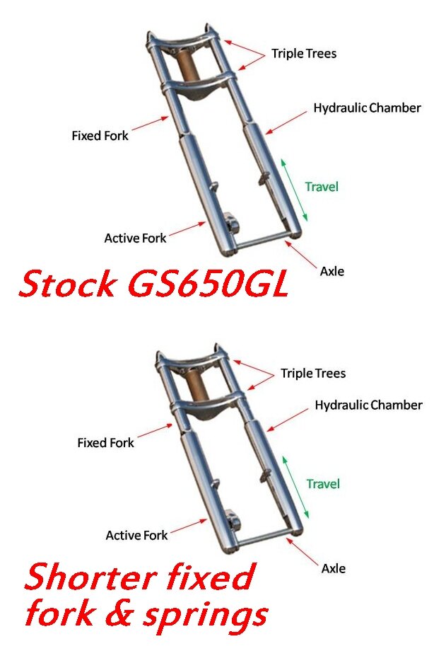

    Question Shortening forks on GS650
    What's involved in shortening the fixed (inner) fork tubes - and springs? How much can be removed before travel is compromised?

    No luck there - they said they don't remember ever seeing any, either.
    Still hoping for input on the OP: "What's involved in shortening the fixed (inner) fork tubes - and springs? . . ."
    I presume there's more to it than disassemble, cut 3" off bottom of springs, cut 3" off bottom of tubes, and reassemble. For example, any machine shop work necessary?

    I would be wary about 3" off the springs. I have lowered bikes using a Progressive Suspension lowering set of springs and t his lowers about one inch or 1 1/2 inches.... can't recall for sure. There is a piece of PVC pipe that comes with each spring that puts a bit of load on the shorter springs so they don't klunk going over railroad tracks.
    This guy has been in the fork business forever and can likely be a better source of shorter fork tubes and has decent prices as I recall:
    http://www.frankmain.qpg.com/
    If I were doing this project I would seriously consider cutting the fork stem and re-welding it for MORE rake to have the steering sit lower and it will also have the benefit of handling better. Not sure how a steering wheel would work or why you would want one.

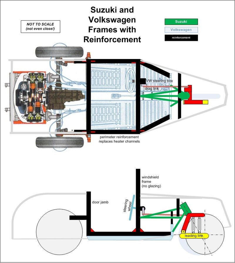

    My frame combines a VW bug pan and the front half of the Suzuki frame. Lowering the Suzuki neck is so it won't stick out the top of the replica's hood. Since my OP in this thread, I've learned about the Trimuter front end and, since it usually uses a VW bug wheel/brake (and speedo drive), I'm planning to build one:
    Looks like it will put the Suzuki frame's neck about as low as one could go.
    I don't know if any of the angles/lengths of the Trimuter design are critical, though, and the Trimuter's designer won't sell just the front end plans, so I'm open to input on that and how to best join the Suzuki stem to the newly fabbed assembly.
    More pix/text at http://www.carcentric.com/Les.htm

    Quote Originally Posted by carcentric View Post
    Not enough in the drawing above to give you any tips. How does the leading link arm keep from just colapsing? I assume the leading link moves up and down to provide some suspension? Does it have a spring? How is the steering mechanism connected to the neck? Seems to me you would have to have a supported steering stem so the neck could turn on bearings around the stem.

    . . How does the leading link arm keep from just colapsing? I assume the leading link moves up and down to provide some suspension? Does it have a spring? How is the steering mechanism connected to the neck? . . .
    In the original Trimuter front end (the drawing you included in your post), there is a single VW coilover shock between points 1 and 2 (top of orange fork to front of yellow leading arm).
    Making things more difficult in an effort to be different (and use parts I already have), my version uses two Suzuki rear coilovers set vertically.
    {Were you able to see all three drawings in my last post? One was a URL and the other two were attachments for some reason.}
    Either way, yes, the leading arm is hinged for up-down movement and the fork is connected to the neck stem for rotation (steering) movement (the Suzuki forks, triple tree, handlebar, etc.
    are not used). A steering drag link would be fabricated and joined to the fork via a Heim joint attached to the driver side fork leg .
    As to the lengths/angles I'd like input on:
    1. Is a 2" trail the goal with this sort of front end?
    2. Is level/horizontal the best orientation for the leading arm/link?
    3. Should the leading arm and fork be as short as possible while allowing at least 3/4" clearance between front end parts and tire?
    4. What dimension tubing would be light weight yet safe? Would 1" square, .125" wall steel be strong enough?
    If not, what do you recommend?
    5. Any ideas on how to join the neck stem from the Suzuki to the cross piece of the orange fork?
    Just weld 'er up or something more elaborate involving a paid-for machinist?

    Maybe I can help. Of the many trikes that I have built, one of them was a Trimuter. So i'll offer my recommendations to your plans and try to answer some of your specific questions.
    - Shorten hydraulic tubes at the top, not the bottom. Disassemble each fork tube, have a machinist cut the desired length off and rethread the inside of the tube for the cap threads. Then shorten the preload tube (like pvc pipe usually) an equal distance. You may need to trim a bit off the bottom of the spring(s) to get the desired overall shortened length. It appears that with your latest questions (below) you have now elected to fabricate a Trimuter style fork assembly, so I'll try to address those ideas.
    - 2" inches of trail will be great for whatever design you go with. For a vehicle like you are fabricating, I'd recommend a rake angle of 28 degrees from vertical. That would be achieved as you attach the salvaged neck to the new framework. That would make for some easy steering and stable driving characteristics.
    Level is good design but it needs to be a 'loaded' level. That can be adjusted as the shock mount points are determined. Shock(s) should be mounted at an angle similar to the neck rake, again that would be good angle measured under load.
    - No reason for them to be as short as possible. See explanation below.
    4. What dimension tubing would be light weight yet safe? Would 1" square, .125" wall steel be strong enough? If not, what do you recommend?
    - 1" @ 1/8" won't be strong enough. I would go with at least 1.5" @ 3/16" to feel comfortable. I used 2" @ 1/4" but I was purposely building a heavy vehicle.
    5. Any ideas on how to join the neck stem from the Suzuki to the cross piece of the orange fork? Just weld 'er up or something more elaborate involving a paid-for machinist?
    - If you are going with the Trimuter design, then keep the triple trees with the bare fork tubes from your donor vehicle. With the tubes bolted solidly in the triple trees, cut the fork tubes below the lower tree to a length that will go all the way through the cross piece (orange). With the bottom of the triple tree setting flat on the cross piece, weld those tubes into mating holes drilled through the cross piece. That way, the triple trees can be disassembled if needed and will provide a strong assembly for the front end using the original Suzuki components.
    Everything in this type design orients around the shock(s) specifications. Shock length, load rating, travel, etc. are all critical considerations to the fork design. And there are two approaches to incorporating those shock specs. You can design your chassis as you'd like it to be and let those design factors determine the shock specs that you need, or alternatively you can select the shock(s) that you want to use and alter the design of your chassis to accept the shock characteristics. You seem to be choosing the latter so you can use your Suzuki shocks. So to go forward get the specs on your shock, and that will determine whether you should use one or both shocks and how they should be oriented in your chassis.
    I hope I didn't ramble too much, but I do try to go step by step in engineering advice, and to explain the whys and whatfors as we go.
    And, as always, my advice is guaranteed or your money back!
