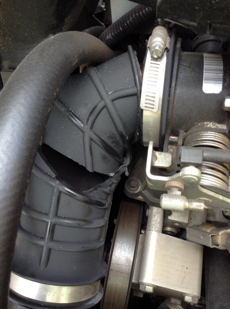

    Well here is a good one. MJ was riding her Stallion last night. We went to dinner came out and rode about 4 miles and stopped at a Publix for some milk. Came out started the Stallion and when we started to give it some gas it died just like it ran out of gas. we know it had at least 3 to 4 gallons so that was not the problem.
    It would start and idle even in gear but push on the pedal and it would die. We idled down the street for 3 miles in traffic to the motel. I figured fuel filter or maybe fuel pump. Got up made arrangements at a garage to look at it and called AAA to have it towed.
    While I was waiting I opened the hood to make sure I remembered where the data port was and noticed that the air intake plenum looked strange. Looked at it closer and it was completely broke in half where the air filter and plastic sectioned that the MAP sensor are mounted and attaches to the section of the plenum that goes to the throttle body.
    It appears that the plastic failed from getting brittle over the 7 years of heat and vibration. I had some repair tape wrapped it nicely to put the whole thing back together sealed. That fixed the problem.
    With the MAP sensor not being able to read moving air (the sensor was down line from the break) the ECM would not let the Fuel Injection work. No air No gas. Something to be aware of as our Stallions are aging. I will be looking into seeing if I can replace the plenum. Works great for now.

    Gorilla, MJ and all Stallion Owners take note:
    We Own Two 2008 Stallions and have had both of our trikes brake down from the same issue within literal DAYS of each other.
    We called Texas and were told we must first contact a local shop and have them call in the order for the part, which we were led to believe was a special "ROUSH" part and was on a three month back order at $ 100 each!
    I tried a hi heat glue to seal the splits and wrapped them over with self adhering black hi heat tape and they worked for just a short bit and began to fail in other places. I want to be sure we are both talking about the same part, I will include fotos of our parts and will skip other means we tried to repair the problem.
    Ours failed at the rubber "L" cold air intake tube which runs from the throttle body and takes an immediate 90 degree bend with very little room before it contacted the angular brace nearly in front of said tube. It plugs into another rubber tube which houses the map sensor, filter,etc.
    After much experimenting, I finally came up with a working fix, which has continued to work on both bikes with some adequate mileage and in our August-Florida-heat as tests. As it is early in the morning here, I will get all parts when the store opens and their respective numbers and those fotos taken ASAP.....BTW all were purchased at my Auto-zone stores.

    Roadbuz nice solution. Thank you. The tape I used is holding for now but as you stated the heat will get to it as it's not a permanent solution. Yours looks like you have the answer. I hope she enjoys Nat's trike. Knowing Mikey it was as well taken care of as possible. I actually looked to but it but you had all ready scarfed it up. Enjoy. I will get your recommended parts and fix MJ's.
