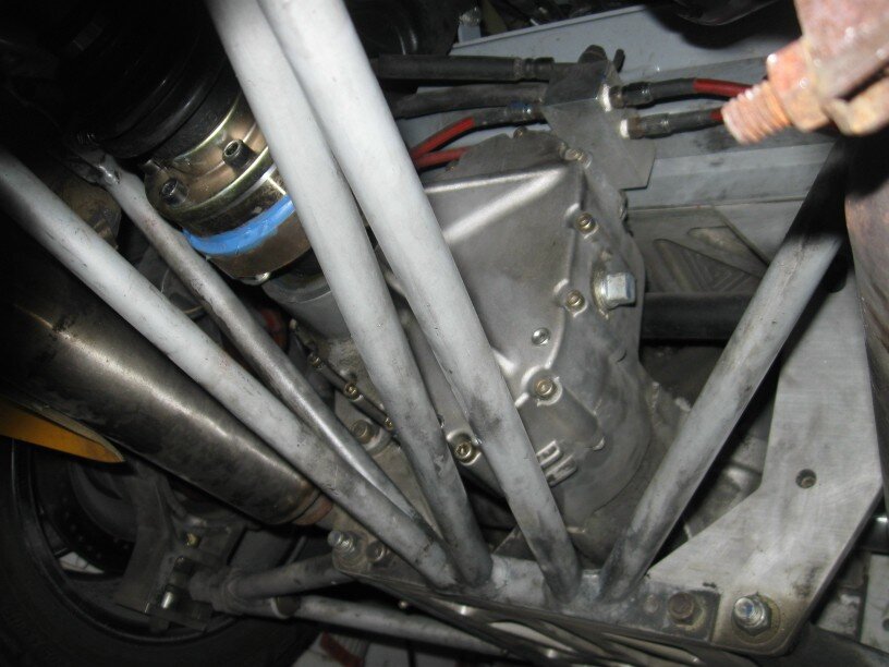

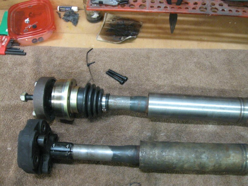

    Default Dreaded CSC Driveshaft Failure
    Well got underneath of my CSC trike degreased yesterday and inspected the driveshaft. Just my luck it does have 2 cracks on rubber donut. Considering the Mountain Trike shaft. I realize it could last another 1k miles or go another 10k or more. This is the 2nd driveshaft since kit was installed according to receipts that came with trike when I purchased it last Friday

    Better to find it now and repair it right. Winter down time is better than road down time good find.

    Since you recently purchased your trike and evidently plan on keeping it awhile, I would suggest you invest in the upgraded rear end which apparently resolves their problems. I think it's about a $1,000 but maybe someone on here who has had it done can give you more specific info.
    A friend here with a 2008 has his changed and loves it. Particularly loves not having to worry about it any longer.

    I did my 08 with mountain driveshaft , It was a lot better than the rubber donut ? But the drive line still had a lot of play in it , the gear box had about a 1/4 turn of play in it , I bought the kit from CSC to replace the drive shaft & remove the gear box, I did it myself it was a lot of work you have to remove just about the complete kit , they give you all the instruction , its winter you need something to do ? I paid $ 500. for the kit, they said its about a 8 hour job if the factory does it ? You can go to the CSC & look up the instructions.

    Replacing with upgraded kit is more than I want to tackle. (Done enough of them jobs past 30+ years) I'm 2 hrs from Neihaus in Lichfield. They quoted me $1400 for new upgraded kit. Driveshaft from Mountain Trikes is $520 shipped. Considering going with Neihaus if that price is installed.

    The cracked rubber was not the problem.
    The splines on the DRIVE SHAFT would strip.
    The front part was Honda and CSC made the rear half.
    The splines on the two parts were different hardness.

    Replace the drive shaft & remove that stupid gear box . that gear box weighs 27 pounds with 20 pounds of rotating weight , when I changed mine it rolls better, shifts better & gets better gas mileage. That's my opinion.
    The rear wheel bearings are 95 cavalier non abs .

    Replace the drive shaft & remove that stupid gear box . that gear box weighs 27 pounds .... etc .....
    You mean CSC uses a gear box between the trans output and diff ?????
    I looked using Google but must have used wrong terms.
  12. #12
    250+ Posts 07BlueCSC's Avatar
    May 2008
    Gasport, NY
    288
    Default
    Quote Originally Posted by CrystalPistol View Post
    The gear box is a 1 to 1 ratio.
    The only purpose it served was to have less of an angle on the universal joints.

    They did for a short time but eliminated it years ago. Not sure what years had it, maybe some one else knows.

    Your kit is based on a GL1500.
    The driveshaft problems were on the GL1800's.
    Quote Originally Posted by Bazooka View Post
    When mine was converted in July of 2007, CSC told me that I was getting
    one of the new drive shafts with the Gearbox.
    The drive shaft stripped about 2 1/2 years later.
    The GEAR BOX self destructed at around 55,000 miles.

    Quote Originally Posted by rhino65 View Post
    The latest version of the CSC driveshaft started in 2012. It is an automobile style driveshaft that is virtually bullet proof. The gear box and Honda driveshaft with rubber isolator was used from 2007 to 2011. The rubber coupler has carbon fiber belts that are encapsulated in it. The cracks that you see are very much normal. Only when the strands of fiber are showing do you need to replace it; which is rare.
    CSC has had both customers and dealers replace them at their expense, which according to the manufacturer was not necessary.
    As for the upgrade, it is well worth the investment indeed, and if you contact Dwight at CSC and mention this very post, he will get you a nice discount.

    Quote Originally Posted by California Sidecar View Post
    The latest version of the CSC driveshaft started in 2012. Itis an automobile style driveshaft that is virtually bullet proof. The gear boxand Honda driveshaft with rubber isolator was used from 2007 to 2011. Therubber coupler has carbon fiber belts that are encapsulated in it. The cracksthat you see are very much normal. Only when the strands of fiber are showingdo you need to replace it; which is rare. CSC has had both customers anddealers replace them at their expense, which according to the manufacturer wasnot necessary. <o></o
    As for the upgrade, it is well worth the investment indeed,and if you contact Dwight at CSC and mention this very post, he will get you a nice discount.
    The latest version of the CSC driveshaft started in 2012. It is an automobile style driveshaft that is virtually bullet proof. The gear box and Honda driveshaft with rubber isolator was used from 2007 to 2011. The rubber coupler has carbon fiber belts that are encapsulated in it. The cracks that you see are very much normal. Only when the strands of fiber are showing do you need to replace it; which is rare. CSC has had both customers and dealers replace them at their expense, which according to the manufacturer was not necessary. <o></o
    KUDOS to Dwight at CSC! I have talked to Dwight on several occasions and he is a stand up guy.
    He is a partner in CSC and has been with the company for a long time and knows the product.
    He's very service oriented and values his customers and monitors this site. If you have any questions, shoot him a PM or call him.
