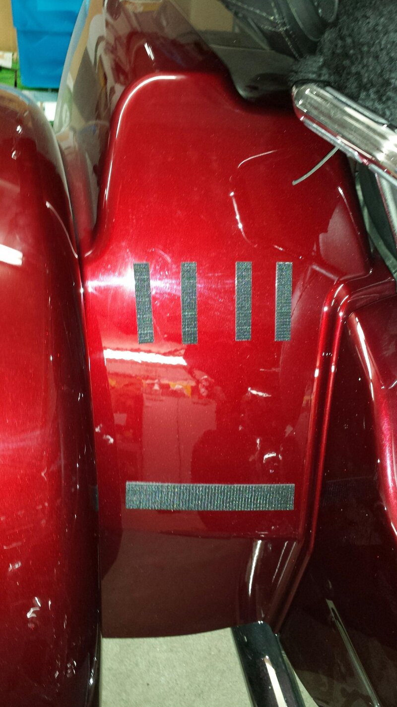

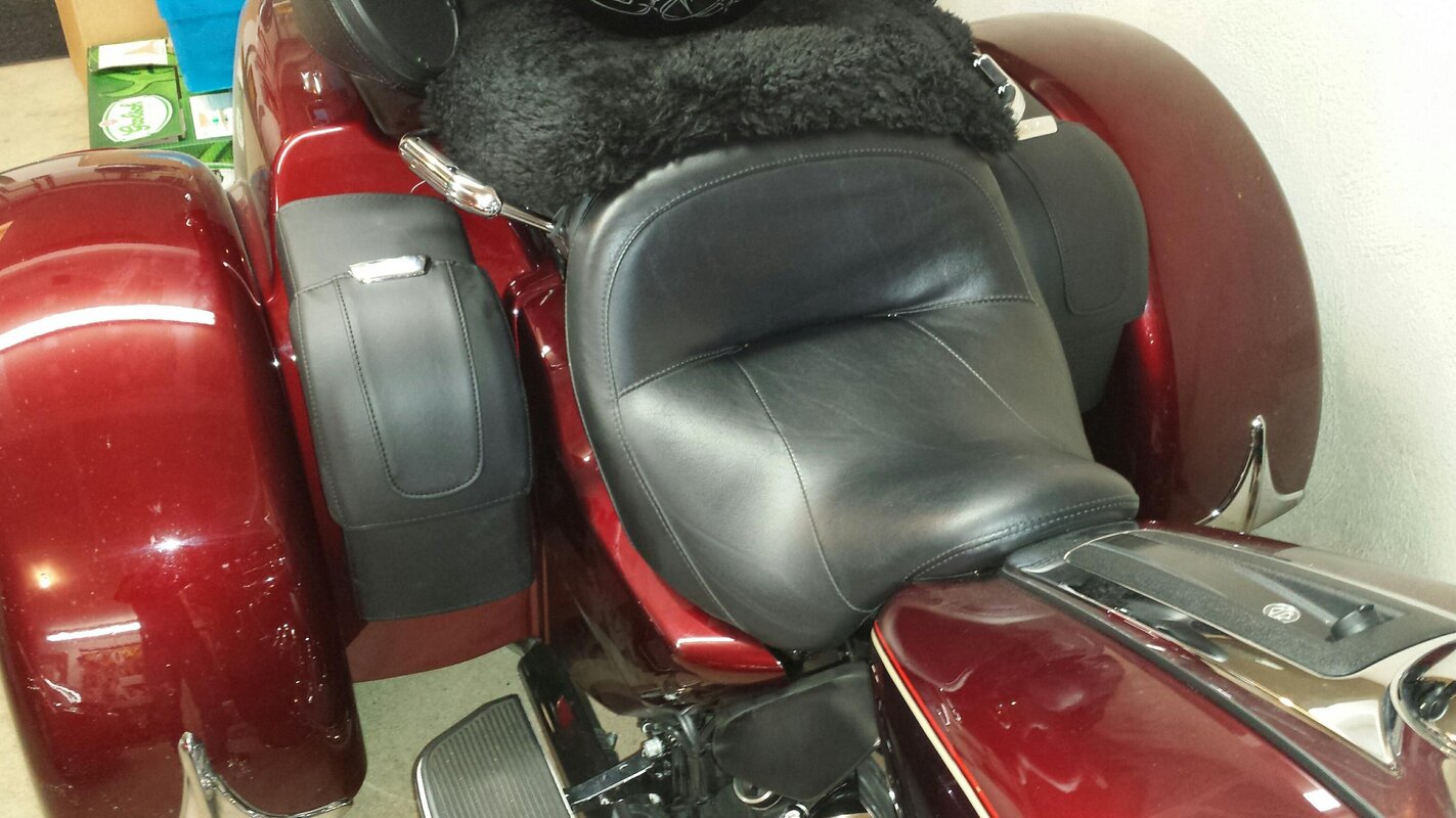

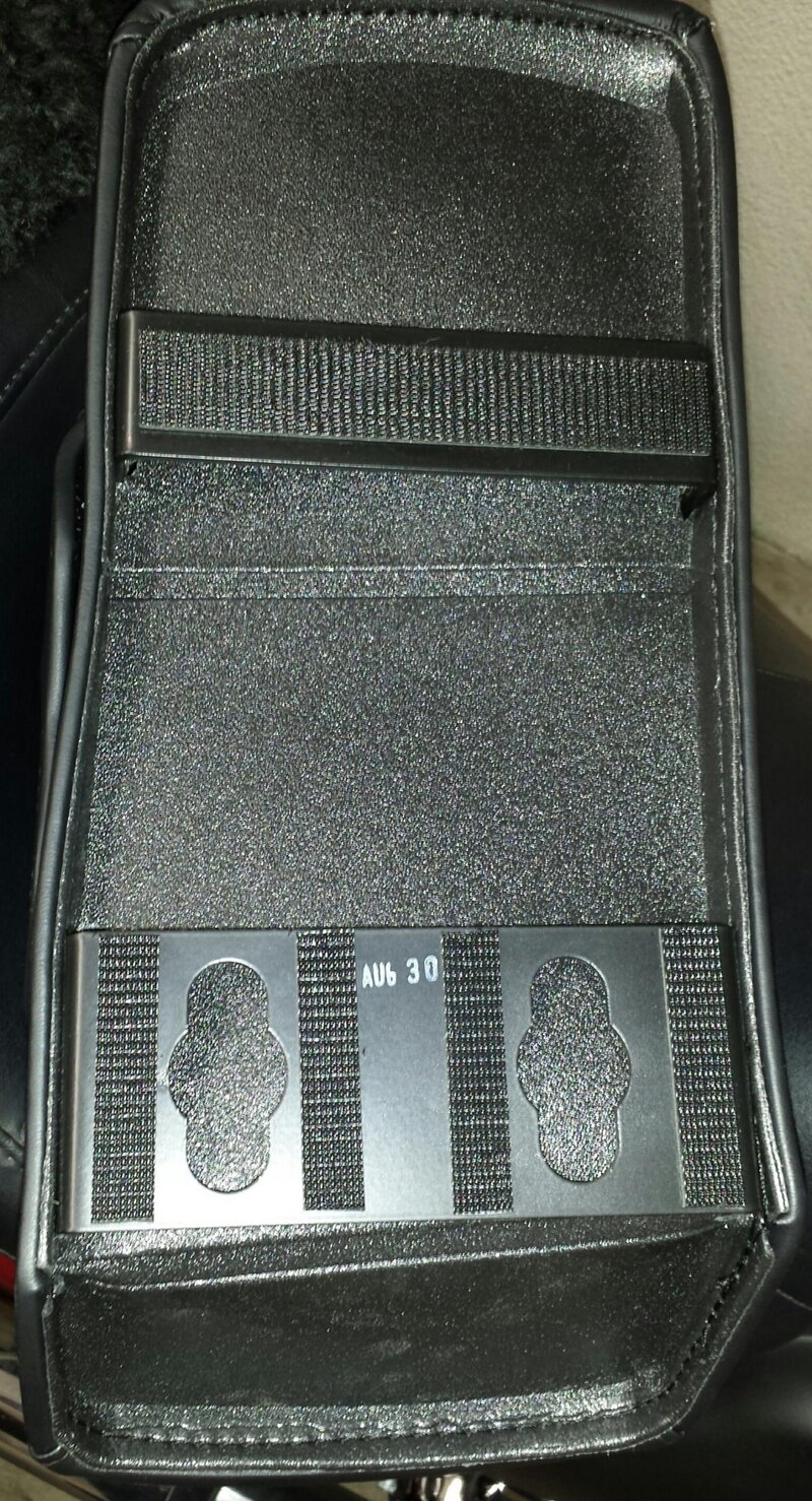

    I used 3M "Dual Lock" fastener strips. 10x stronger than velcro. Horizontal strips mate with vertical strips allowing easy placement .... full contact would be almost impossible to remove .... it's that strong a hold.

    I used the same as HDBOB, but I stayed horizontal on all strips...either way works.

    Note. I didn't cut the rubber grommet, a little pinch on the backside and they will push out. This way you can save them and if you ever want to mount permanent you have all the parts.
