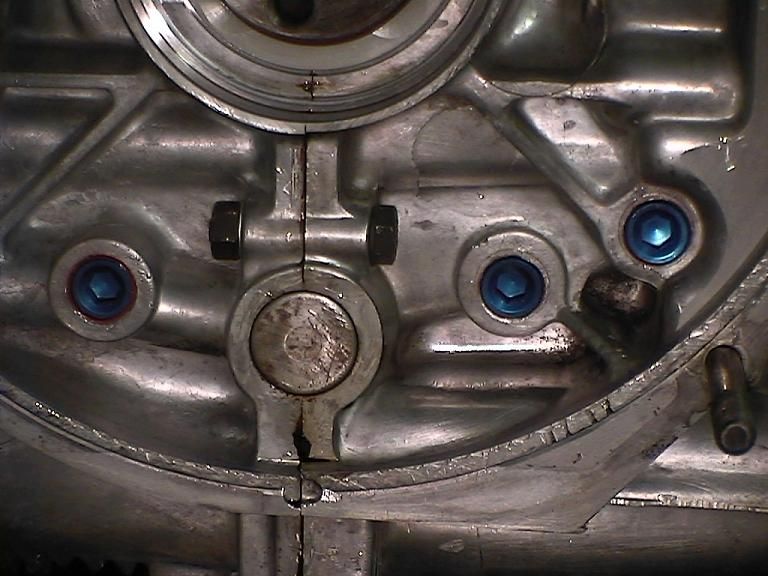

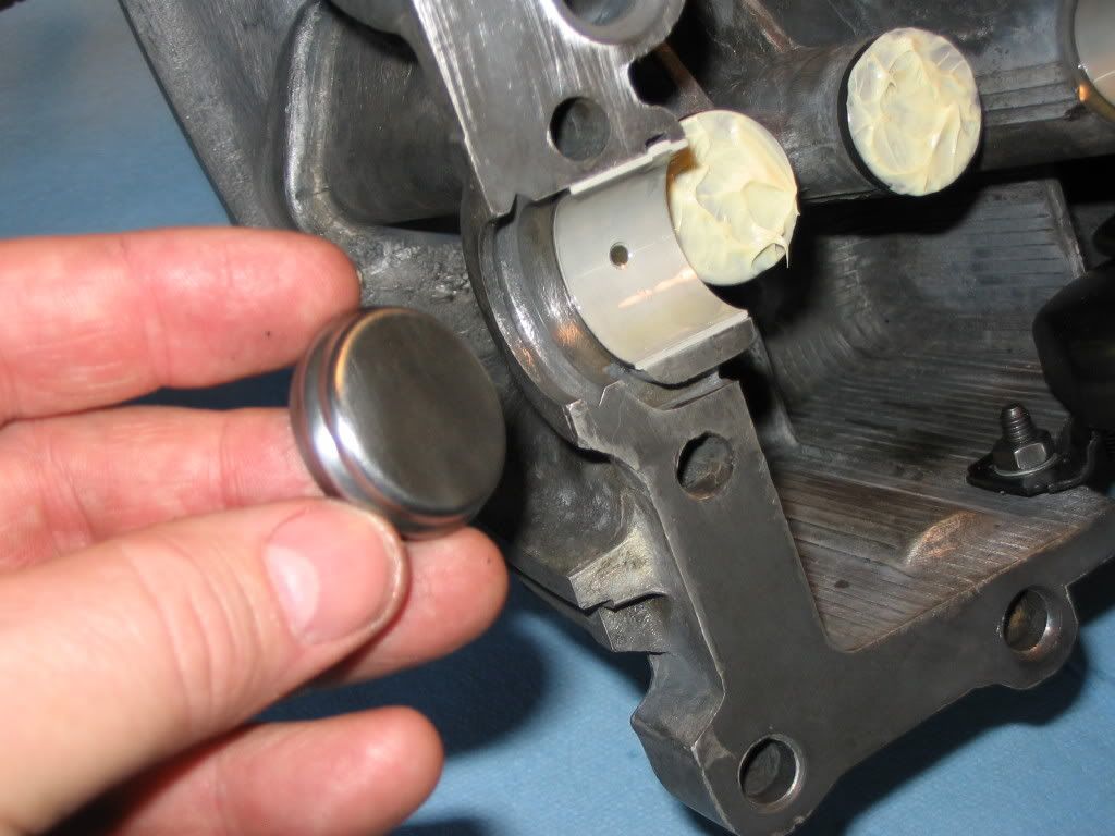

    First, welcome Trey!!!!! Glad you found us here.
    On the question of being a single oil relief or dual relief case;
    Looking at the very bottom of the engine where the oil strainer is: That is where you drain the oil.
    Now, look off to your left; At each end of the case, there should be a relief plug. It will look similar to a very large standard screw. Not Phillips.
    A dual relief case will have one on the front and back of the case (at the bottom as I stated).
    If that is the case then you can just run to your local NAPA and get the main seal.
    Thank you
    Bob

    Well I'm not sure about the oil relief, it is defanently the swing axle design. I have been doing some more looking and came across a post talking about the oil galley plus leaking and the way the poster described the leak it sounds a lot like the leak I have. is it possible to replace them without splitting the case? I have not pulled the engine out yet so im just going off speculation.

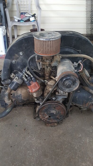

    Well that is progress of sorts.

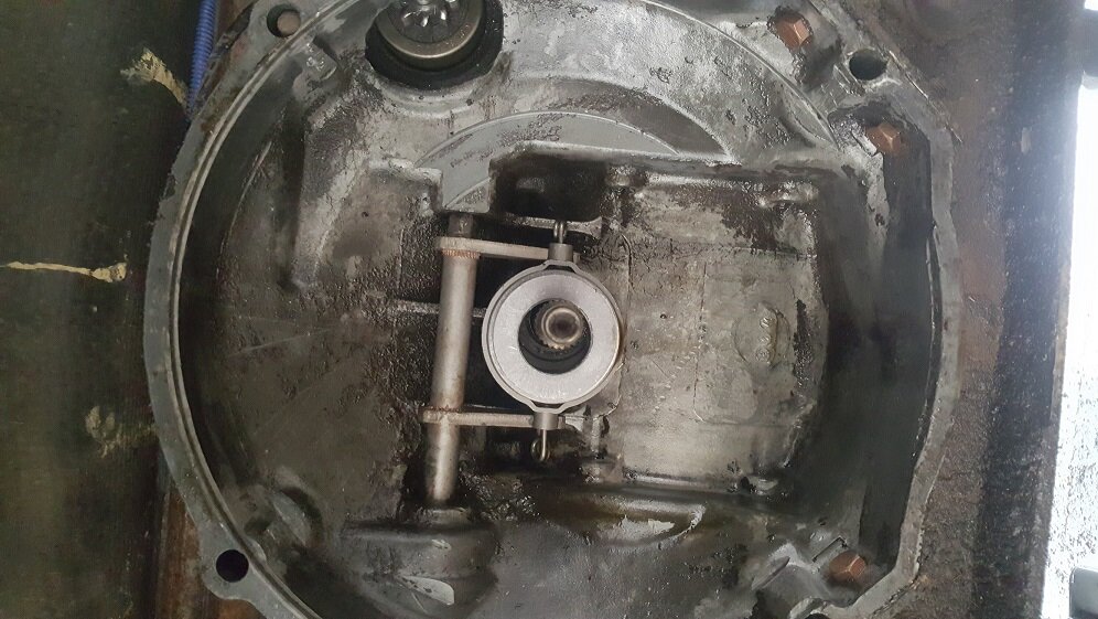

    That puts the trans in the 60's.
    Thats is before the 1600 dp came out.
    So if it is the 1600 dp then it is a mix and match put together of different year models.
    That is not a deal breaker, just the way it is when dealing with stuff this old.
    The oil galley plugs are presses into the case. They do not come out by accident. If they are ever removed you must drill and tap the hole for a pipe plug.
    Figure out the picture thing and post some up.
    You are learning the parts and terminology, have you looked at the tech thread? The pics there should help.
    So now do you definitely know the engine is a dual port?
    Is the trans a short axle swing or a long axle swing?
  9. #29

    Dual port 1600. 71 and up
    See where the intake connects to head.

    Single port 66 to 70.
    1300, 1500, 1600 cc
    This pic has an alternator conversion.
    But look at the intake manifold where it connects to the head.

    The 60 to 65 1200 single port looks the same from the outside. But is a completely different engine than anything after 66.
    The single port intake is smaller in diameter.
    And it had a smaller looking carb. Less cluttered looking.

    Now you have me second guessing if it a single port or dual port. i will try to get the picture thong figured out and get some posted this weekend. i plan on pulling the engine saturday morning hopefully i find out its just the rear main leaking.

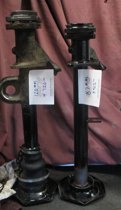

    Now that you know it is a swing axle there are 2 major series of them.
    Short axle and long axle.
    The short axle ones were with 1200cc 40hp engines. Lower geared and originaly fit the 6volt starter. 61 to mid 66
    The long axle came out for the larger engines. It has stronger and taller gears. Mid 66 through 68.
    Only the 68 had a swing axle with 4 bolt wheels.
    I am going to assume it is not pre 1960 as that trans is made very different.
    All this is usa models only.
    The swing was in production untill the end in other countries, as long as it is not a mexi or euro beetle we will be ok assuming a year model.

    We have almost eliminated that. If it was say....a 74 mexi, it would be a long axle swing with 4 bolt wheels.
    So now what we are trying to determine is what series usa trans it is.
    Early = short = 61 to 66
    Late = long= 66 to 68.

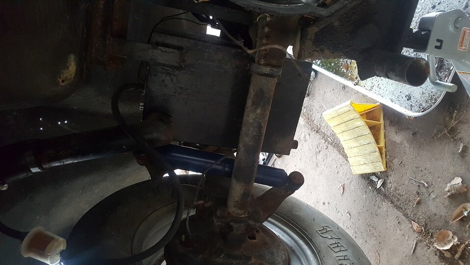

    It's kind of hard to see but this a screen shot the show the axle, it kind of looks like the longer one.

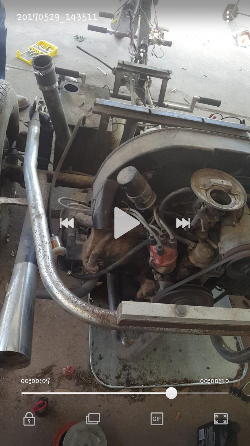

    https://www.facebook.com/trey.teague...0690460948133/
    Hopefully this works, this is a short video of it running right before i found the massive oil leak.

    Could not get the vid to work.
    But that is looking 66 to 68 model.
    That is a single port engine.
    This was the growth spurt years.
    1300, 1500 then 1600cc. They are all related.
    Same case and crank..
    Cylinders and valve size being the main difference.
