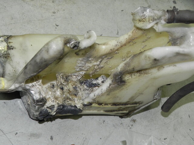

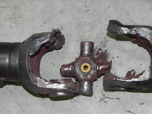

    Here's one that caught fire while on a trip. It was towed over 300 miles to get here. Fortunately, they were able to pull over to put the fire out. The drive shaft started rubbing in its swing arm creating heat which melted the reservoir tank. They are very lucky, directly above the small fire is the fuel tank.
    On some trikes, removing the drive shaft for a proper u-joint inspection is not part of the manufactures maintenance schedule. Although a visual inspection with the shaft still in the trike was done a few thousand miles ago, a failing front u-joint was not detected.
    The take-away ... trikes need to have their drive shafts pulled every 24k to have the shaft and u-joints inspected as PM. Unfortunately on this trike, doing so would cost about $200+ labor.
Size:  109.5 KBName:  DSCN9237.JPG
    Please keep in mind that anytime I share or give advice about a motorcycle, unless I state otherwise, I am always referring to GL1800's and no other.

    And looking at the pic it doesn't look like it has seen any grease and maintenance in quite some time.

    Had to be ignoring some noise and vibration for a while.

    Actually the rear u-joint and slip-joint were regularly greased though out its life. There is no zerk on the front joint. It was in for an inspection of the shaft 8,000 miles ago, but they only wanted a visual without removing the shaft. Basically, little can be inspected without its removal ... the front u-joint is not even visible.
    Quote Originally Posted by Sidecarbill View Post
    About 5 mths ago, they did have a complaint of a noise present when first starting for 2-3 seconds. No noise could be heard or duplicated when they brought it in.

    Didn't you insist on proper inspection???About 5 mths ago, they did have a complaint of a noise present when first starting for 2-3 seconds. No noise could be heard or duplicated when they brought it in.
    Again, would have been a great time to insist on proper inspection!On some, the final drive has to be unmounted to be able to get the drive shaft out. If so, it is a labor intensive inspection that could easily be for nothing other then peace of mind.
    Agree, on my Hannigan the whole rear end must be lowered to give clearance for the drive shaft to be pulled.
    It seems to me if the bike manufacturer won't step up and put U-joints with grease jerks in, then the trike buiders should insist on putting them in when building the trikes!!!!!!!

    Quote Originally Posted by GoldWingrGreg View Post

    visual inspection //// not the same as grab the shaft to see if there is any movement ..... inspectors bad... u joint dint get this bad in just a few miles as mentioned the absolutely had to be some bad vibration ..... operators bad
