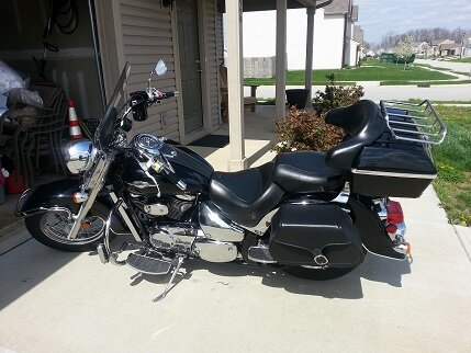

    I have a 2006 Suzuki Boulevard C50 that I would like to put a trike kit on. Since I can't afford to buy a bike with a kit already on it. My only choice is a Voyager or InstaTrike since Champion, Lehman and Hannagin don't currently or plan to make a kit for Suzuki's.
    Just wanting some advice on witch is better.
    Thanks Greg
