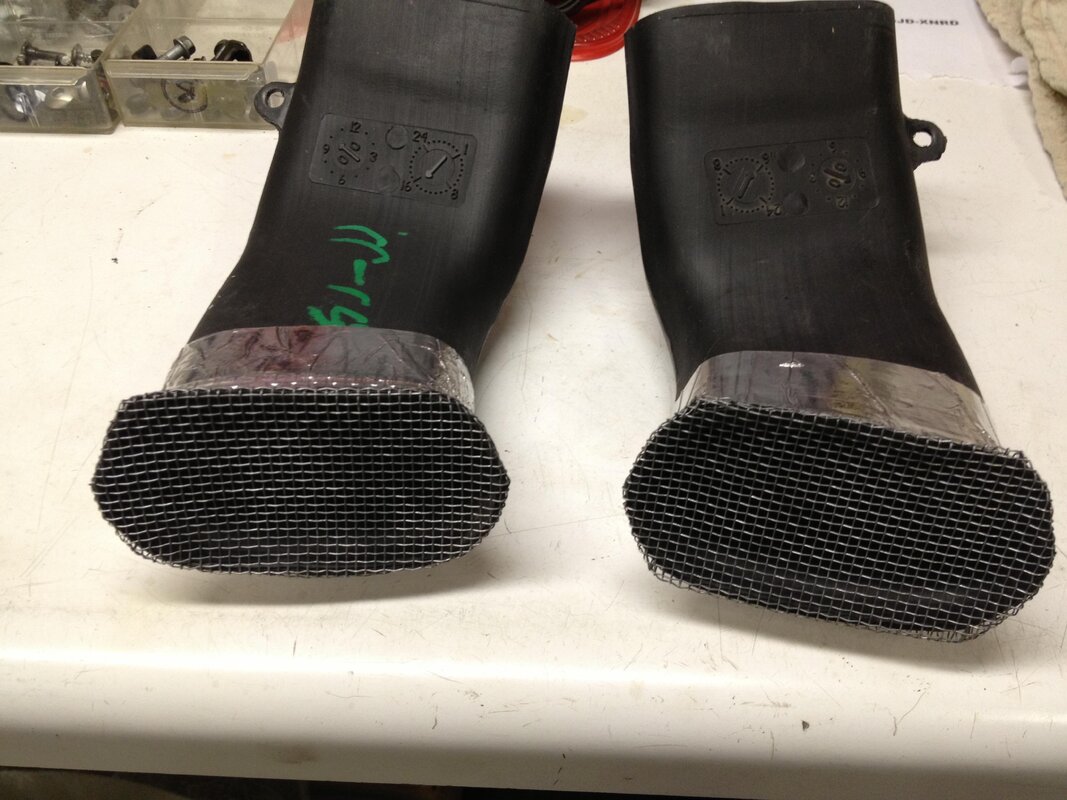

    Quote Originally Posted by trike tech View Post
    I'll add this to it also. Factor in how you store your bike also. If you store in a barn/shed/etc you should probably at least check it at the beginning of the riding season. I can't tell you how many times I've seen bikes with layers of insulation, crud, and even dead mice on top of the air filter (seems to be a popular nesting place for them, especially in winter).
    I ride pretty much all year around so mice in the air box has never really worried me. That said, the first time I changed air filter on my 2001 GL1800 (around 30,000 miles) I did remove the mesh from the filter and wrapped the air intakes. Here I a picture. I have done this to the '06 and now '15 GL1800 as well with absolutly ZERO ill effects. Never hurts to have a little insurance..
