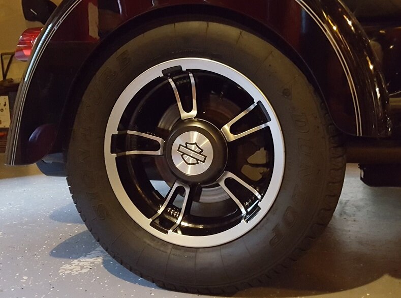

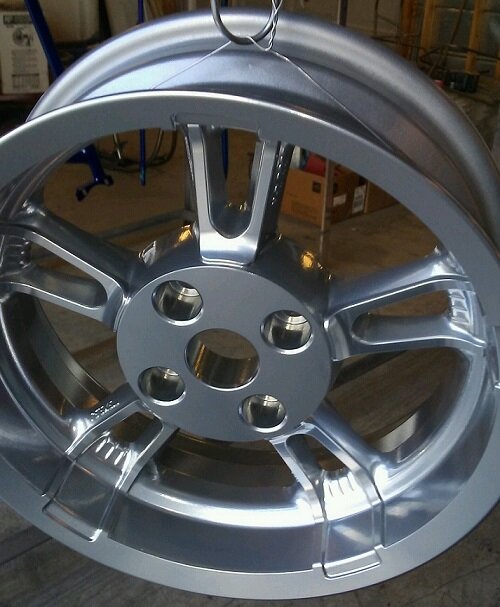

    So....after powder coating the original rims to all black...then deciding it was too much black for me.....then replacing the rears with the Free wheeler rims thus adding the "Chrome" and Black look with less spokes. Liked the look, but the same issue of brushed aluminum and the constant Loosing battle was again a problem. It's gonna be hard to see, but found a powder Coat guy that did them first in Powder Coat Chrome {Almost an aluminum look}.

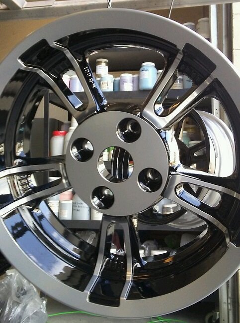

    Then laid down a second coat in Gloss black and before baking, removed the black where the Chrome was supposed to be:

    Clear coated the rims....And this is how it turned out. Looks almost exactly like the originals.....but you can hose them off! Yeah Baby!
