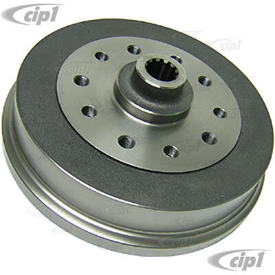

Thanks for suggesting this as I was thinking the considering the same route. IF, not an issue (experts please chime in), I'd like to move away from the LUG BOLTs to LUG NUTs as more configuration options are available.
The drums are more like a cast iron and are not as malleable as the steel flanges that serrated press in studs go in.
Like this.

It can be done, but with a very carefully sized hole and little crush fit. But it not the preferred way.

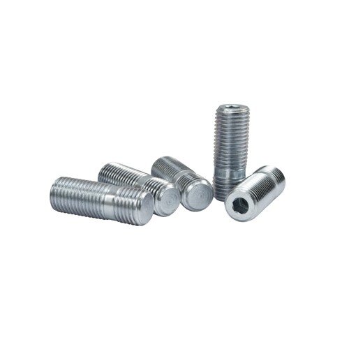

The preferred method is to drill and TAP the new pattern and lock tight in threaded studs.
Like this.

Brake drums and rotors are readily available that already have the other bolt patterns. Much easier just to buy them if you do not have open access to a machine shop.
Like this.
