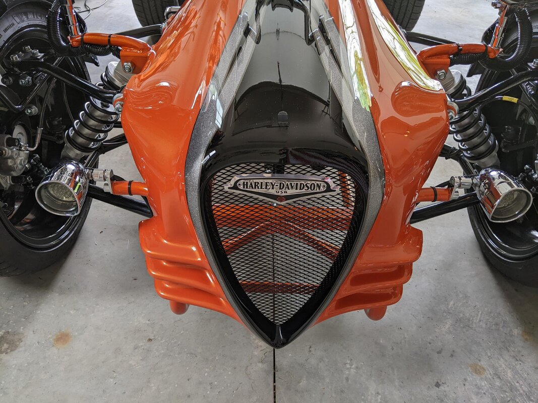

Glued the front and rear grill screens in place.
[ATTACH=CONFIG]107868[/ATTACH]
