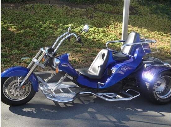

1 Attachment(s)
Here is a photo of my TrikeTek Trike
[ATTACH=CONFIG]30548[/ATTACH]
Lucky to have her fixed so I can ride again!
