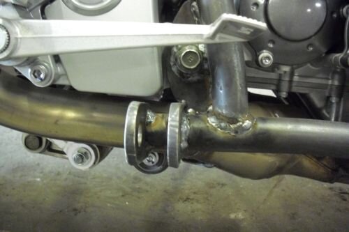

Soon as the Car is installed I will. Dealership has done it several times All the do is move the Engine guard forward a bit. A bracket for any mounting position can be made.
While visiting Hannigan had a chance to see where the make mounts and customize anything they need to.
two of the mounts for the Street I made, while so many were saying it can't be mounted.
They have mount hack on Liquid cooled head Rushmore both after market and Hd one that had been restored.
read this thread shows one for a Champion.

[QUOTE=ragsflh;586203]then show me pics of top and bottom mounts[/QUOTE]
Yesterday I placed the order for the Classic twin sidecar. We had a long conversation about the mounting, because I am having a local dealer install it .
Hannigan assured me it will be a direct bolt on and there will be no issues with the hard lowers and radiator in the lower. I requested delivery no latter than first week in October , however they said it may be ready by August. When it is installed I will provide you with detailed pictures of how they made the Brackets.
The Dealer that will be installing mine has done custom installs on other wet heads. In those cases they were refitting older HD cars to newer wet heads.

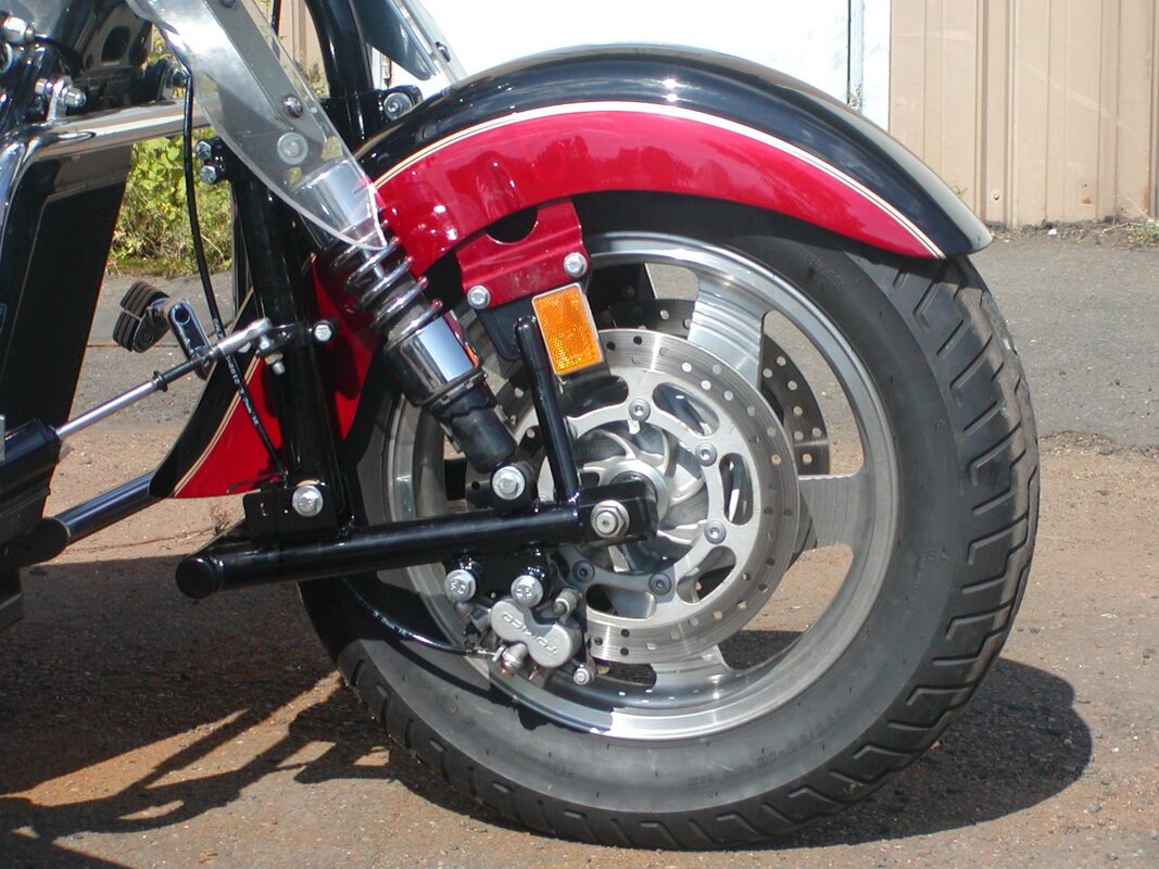

Trike looks interesting, is that all build or a kit? Down the road the Street 750 may get a Frankenstein kit .

no kits here everything is 1 off
