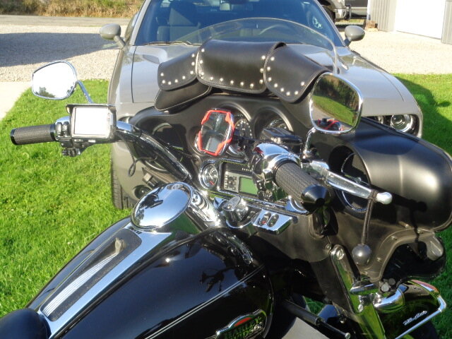

[QUOTE=Fearless;823445]when you get time post a picture of the new bars. I would like to see them. Congratulations I know the feeling the 2+2 wide sweepers worked for me ride safe Fred[/QUOTE]
Kinda lousy picture, been cloudy and sprinkling here, so took the photo in the bike barn, but you should be able to get the idea.....
[QUOTE=Teufelhunde;823820]Kinda lousy picture, been cloudy and sprinkling here, so took the photo in the bike barn, but you should be able to get the idea.....[/QUOTE]
Good job look like they will be great
