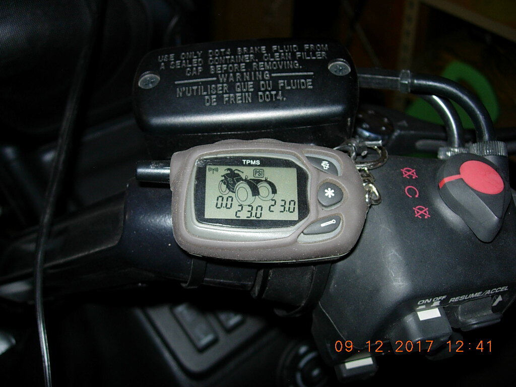

I no expert but, TPMS systems are like a "mini-radio" system. The transmitter in either inside the tire/wheel or "external" - part of the valve stem. The "receiver" is located elsewhere and is part of what you are looking at on the dash (or wherever). After the rear wheel is removed during trike conversion, say goodbye to the rear wheel transmitter. Unless the 2 new rear trike wheels are fitted with compatible transmitters and the "receiver" is now capable of receiving 3 channels, rather than 2, it seems unlikely that [B]ANY[/B] trike conversion, [U]not just MotorTrike[/U], would have "built in", 3 wheel TPMS.
My TPMS system uses an enternal "key fob" type of receiver/display and the sensors are externally mounted on the valve stem rather than the usual valve stem cap. Works great.
