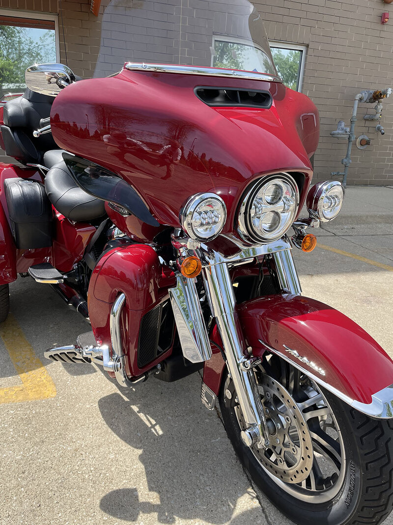

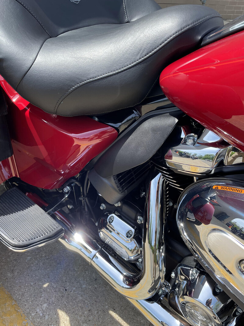

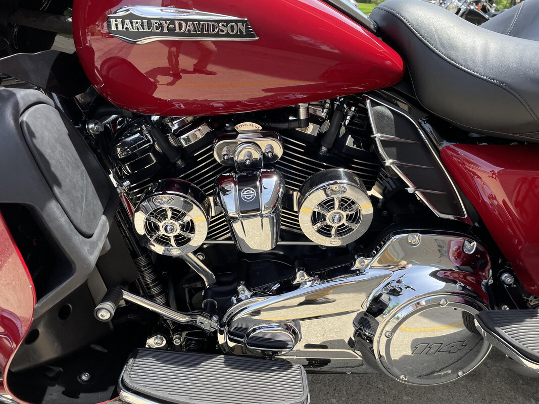

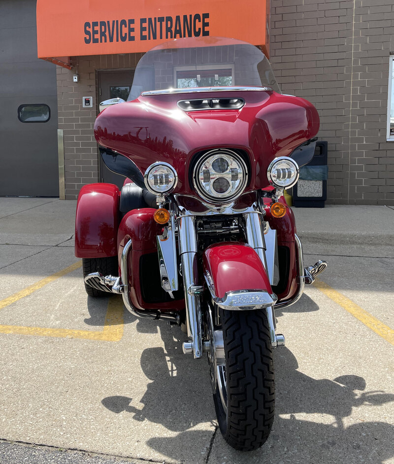

4 Attachment(s)
Some pics of the Fangs and Fans...
Here's a few pics of the upgrades I added (JES Fork Fangs, Love Jugs Cool Master Fan and Harley Cool Flow Fan)
