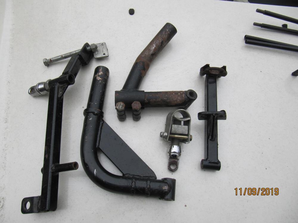

1 Attachment(s)
Here's what the sidecar owner has for us. The bent pipe thingy has already been straightened. The curved 1 with the 45 deg brace he said he modified, so we'll either hav to fix it or replace it. (Is that part of the sidecar or the mounting kit?)
[QUOTE=Koalabear747;712348]Here's what the sidecar owner has for us. The bent pipe thingy has already been straightened. The curved 1 with the 45 deg brace he said he modified, so we'll either hav to fix it or replace it. (Is that part of the sidecar or the mounting kit?)[/QUOTE]
Those parts may come in handy. They will need to be adapted to the current setup. Mounting the rig right is a science and an art. There are some rules but they must be viewed in the over all mount.
