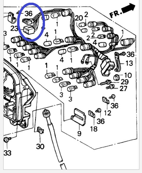

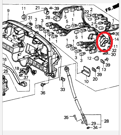

This is behind the meter panel that plugs into the harness.
Circled in red is the connector. The connectors circled in blue go to the LCD display (unless you have an Interstate).
