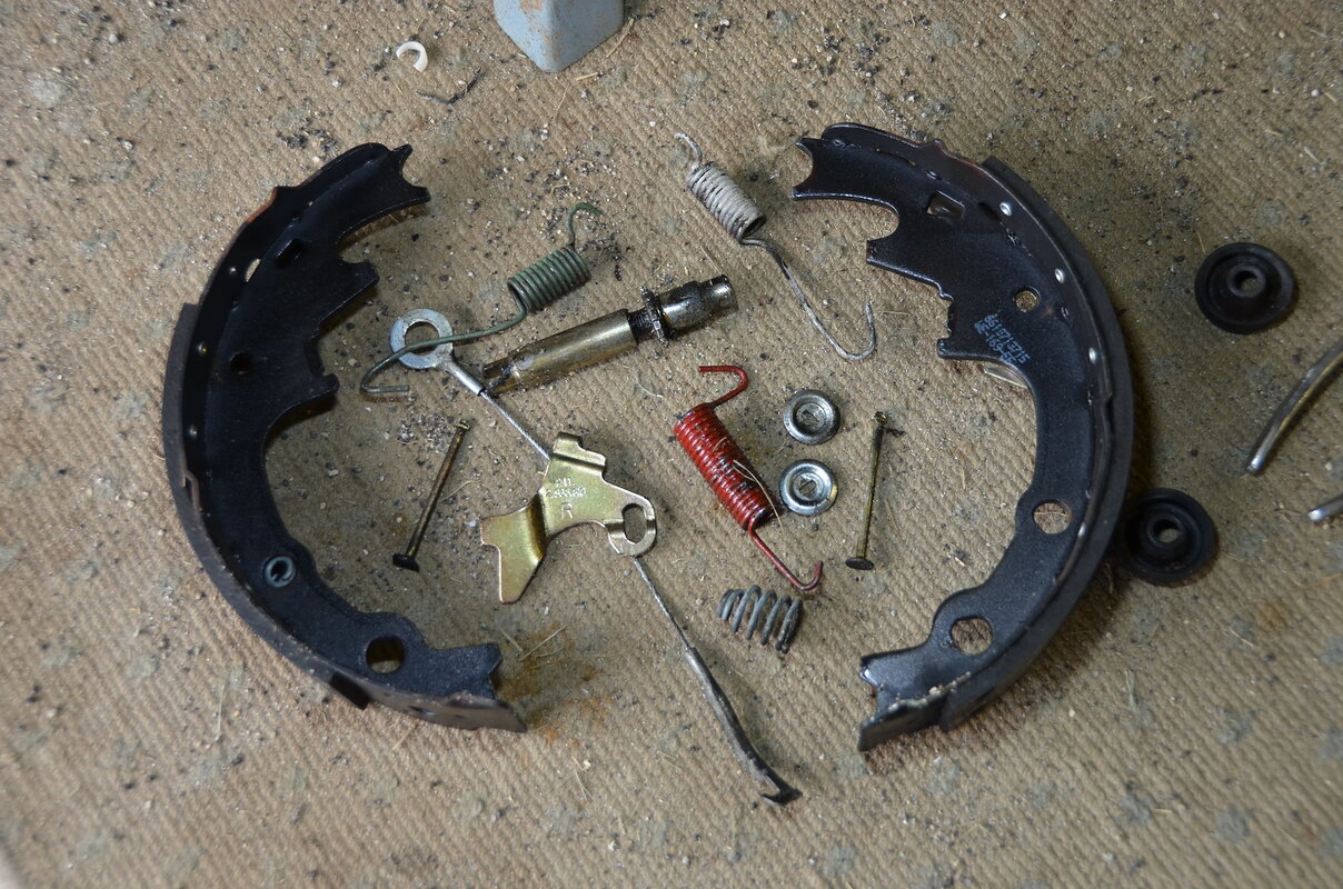

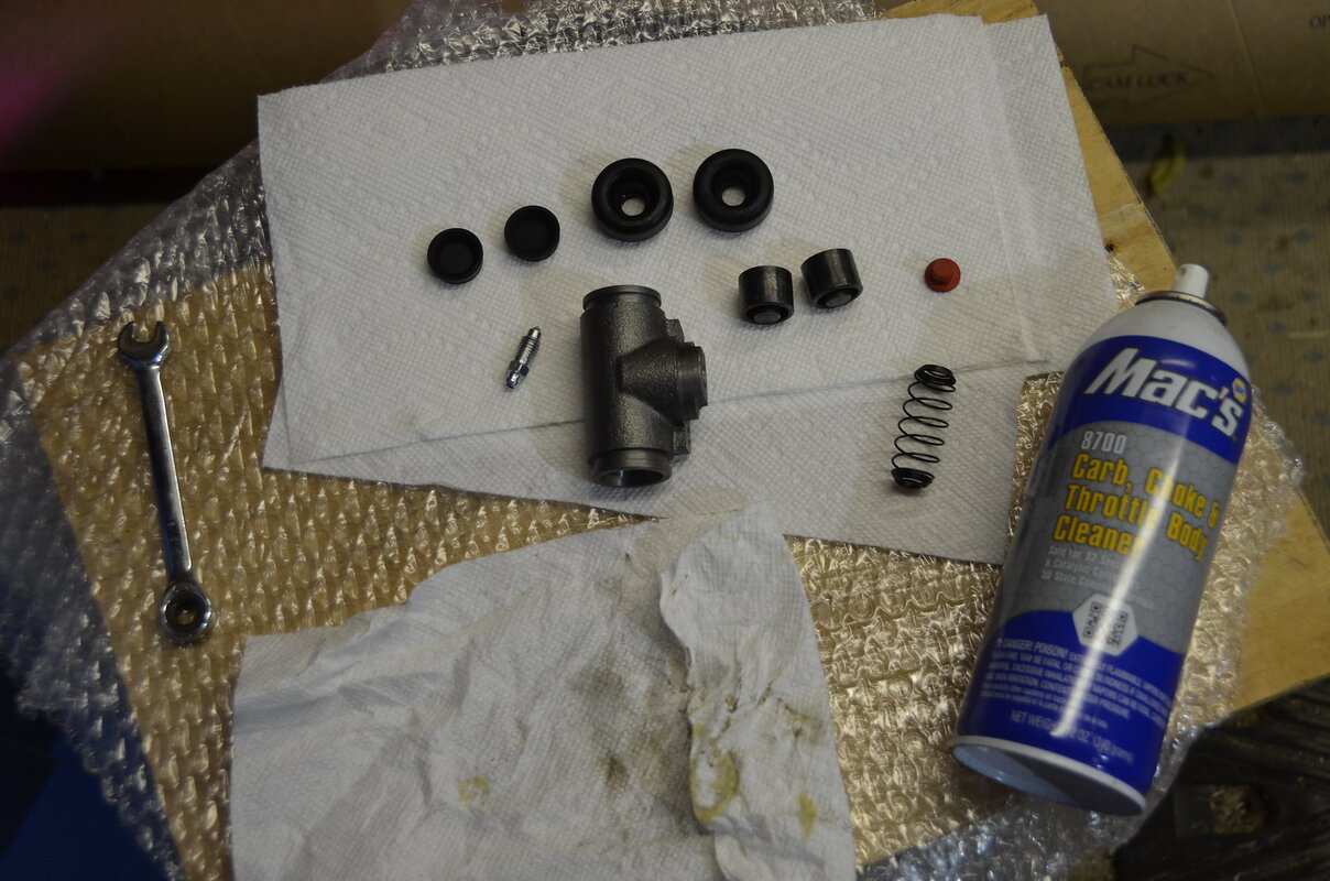

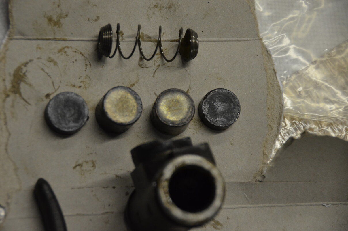

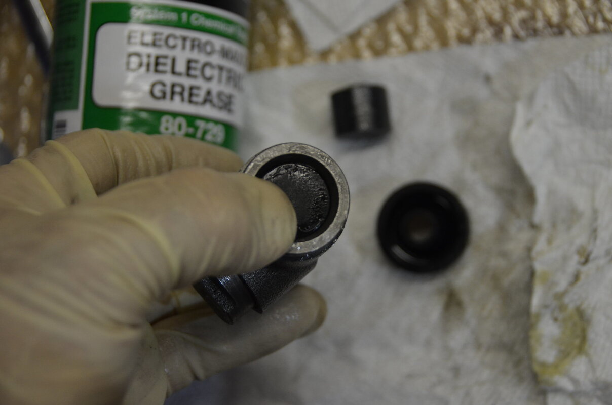

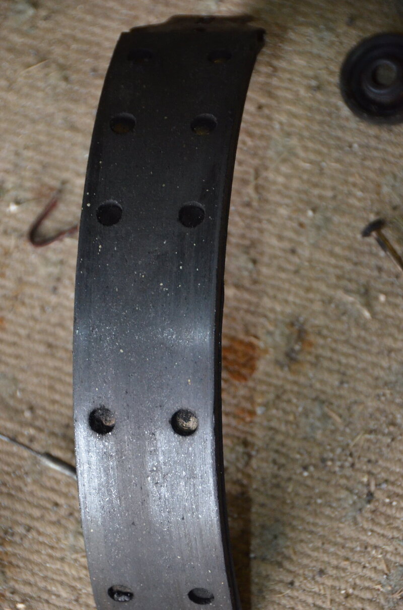

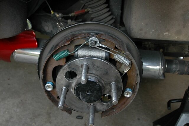

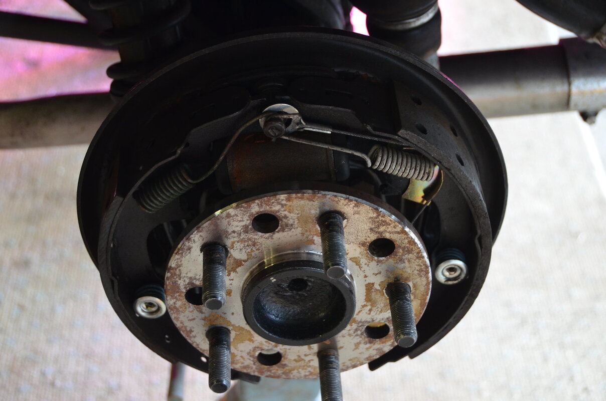

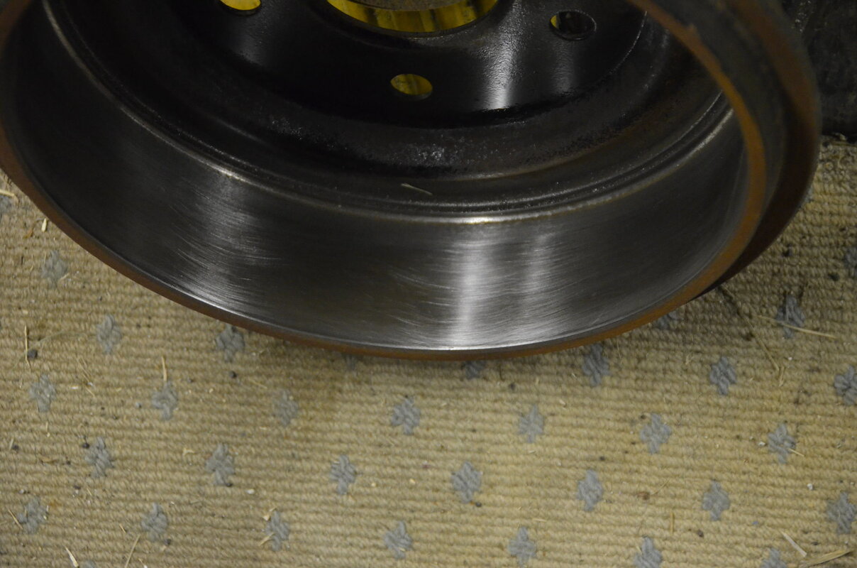

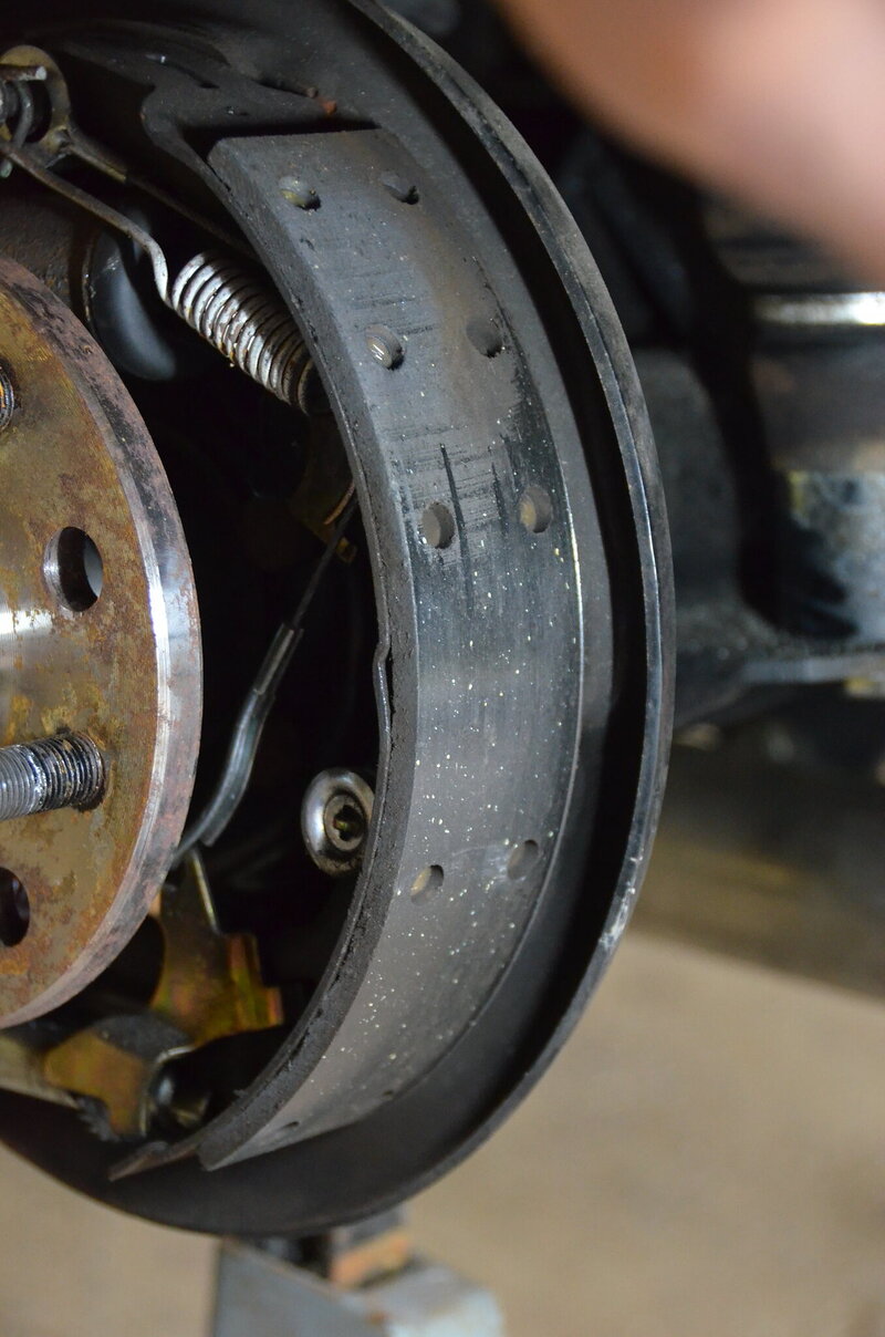

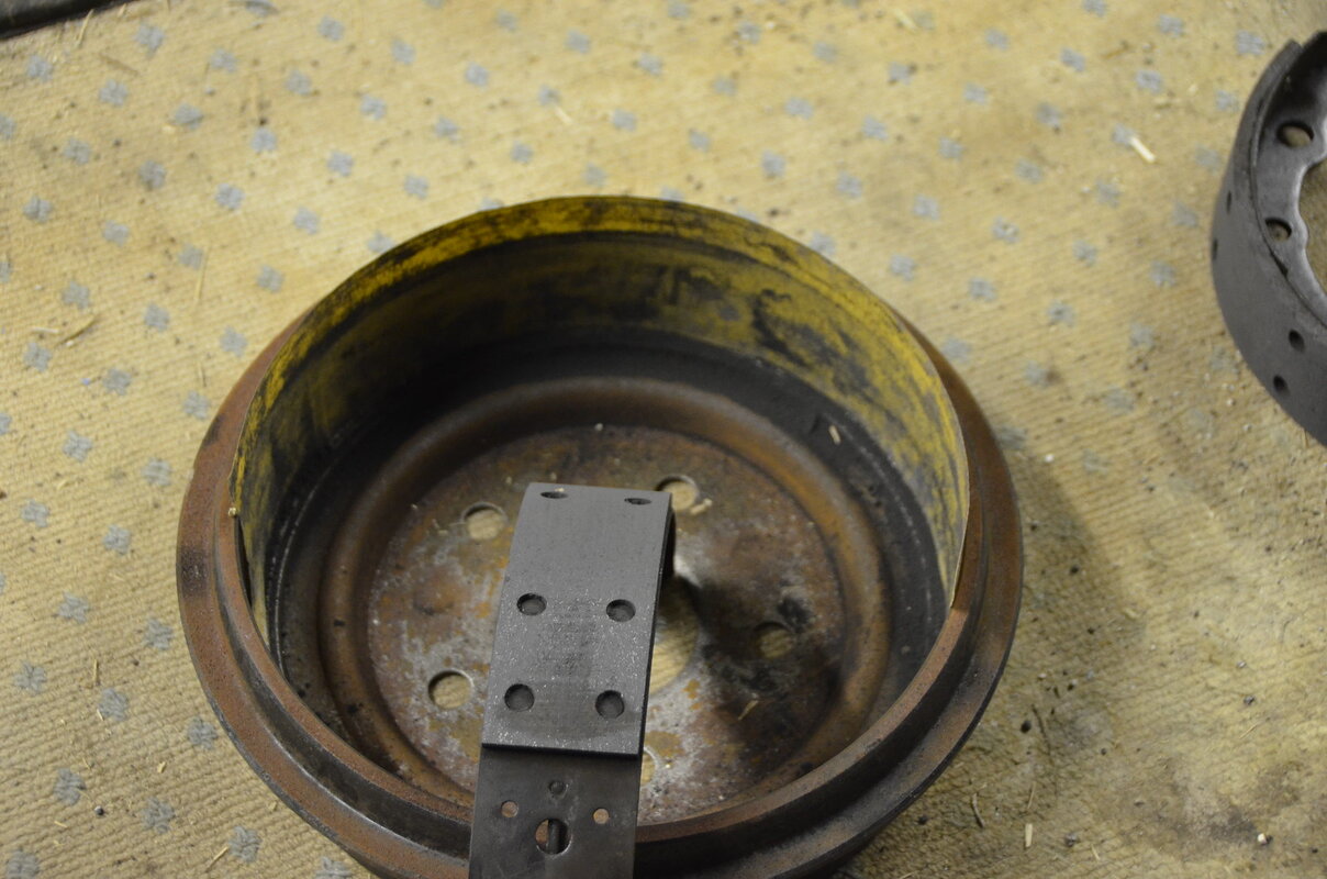

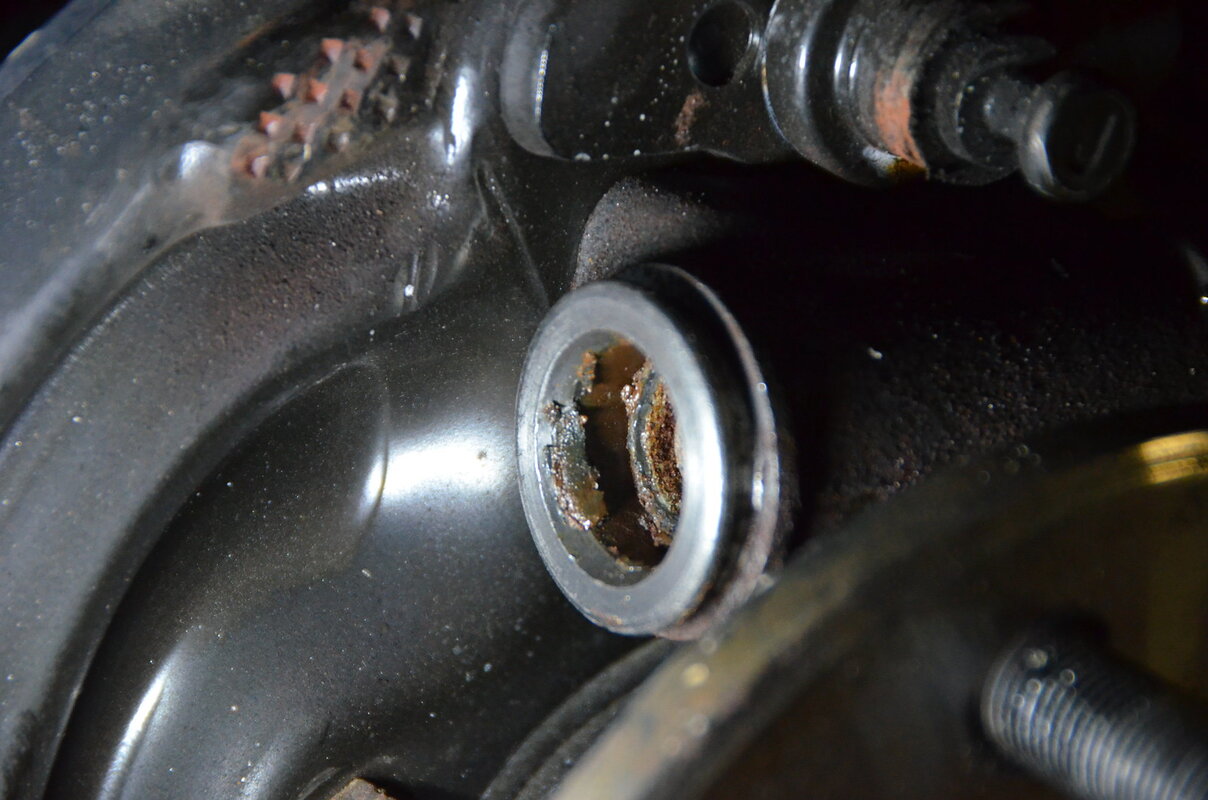

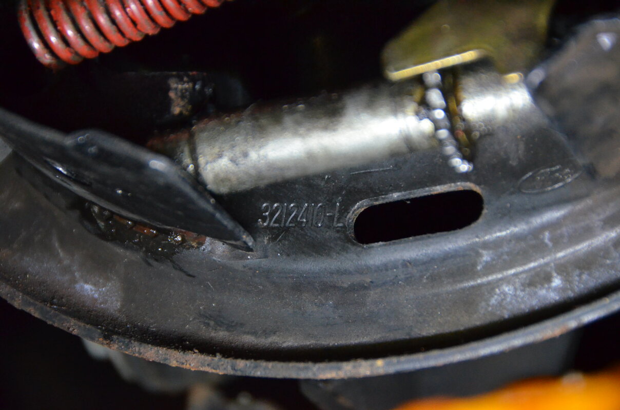

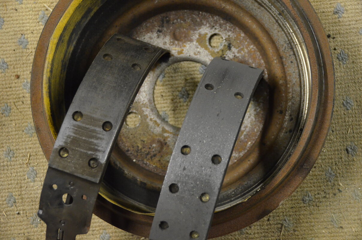

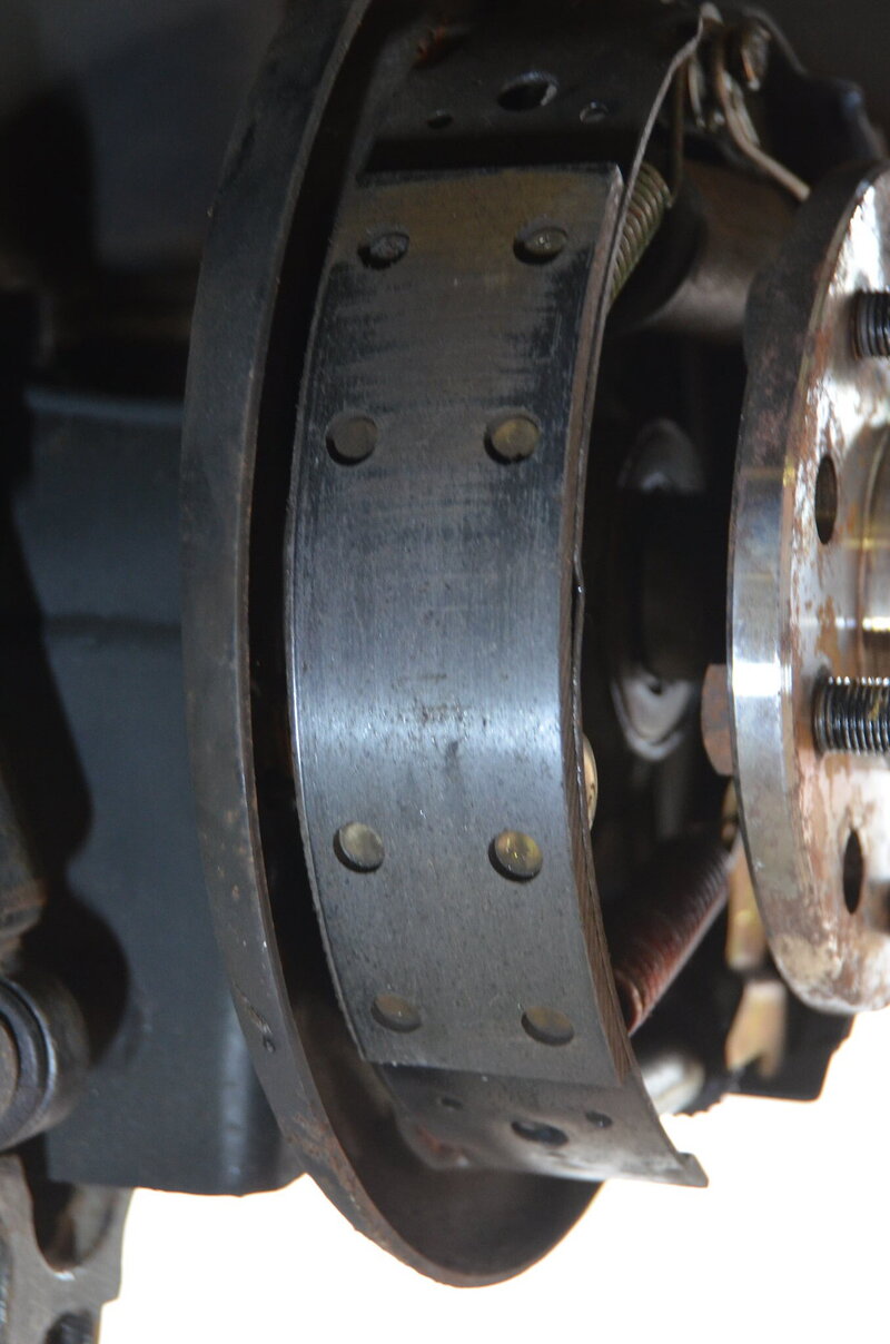

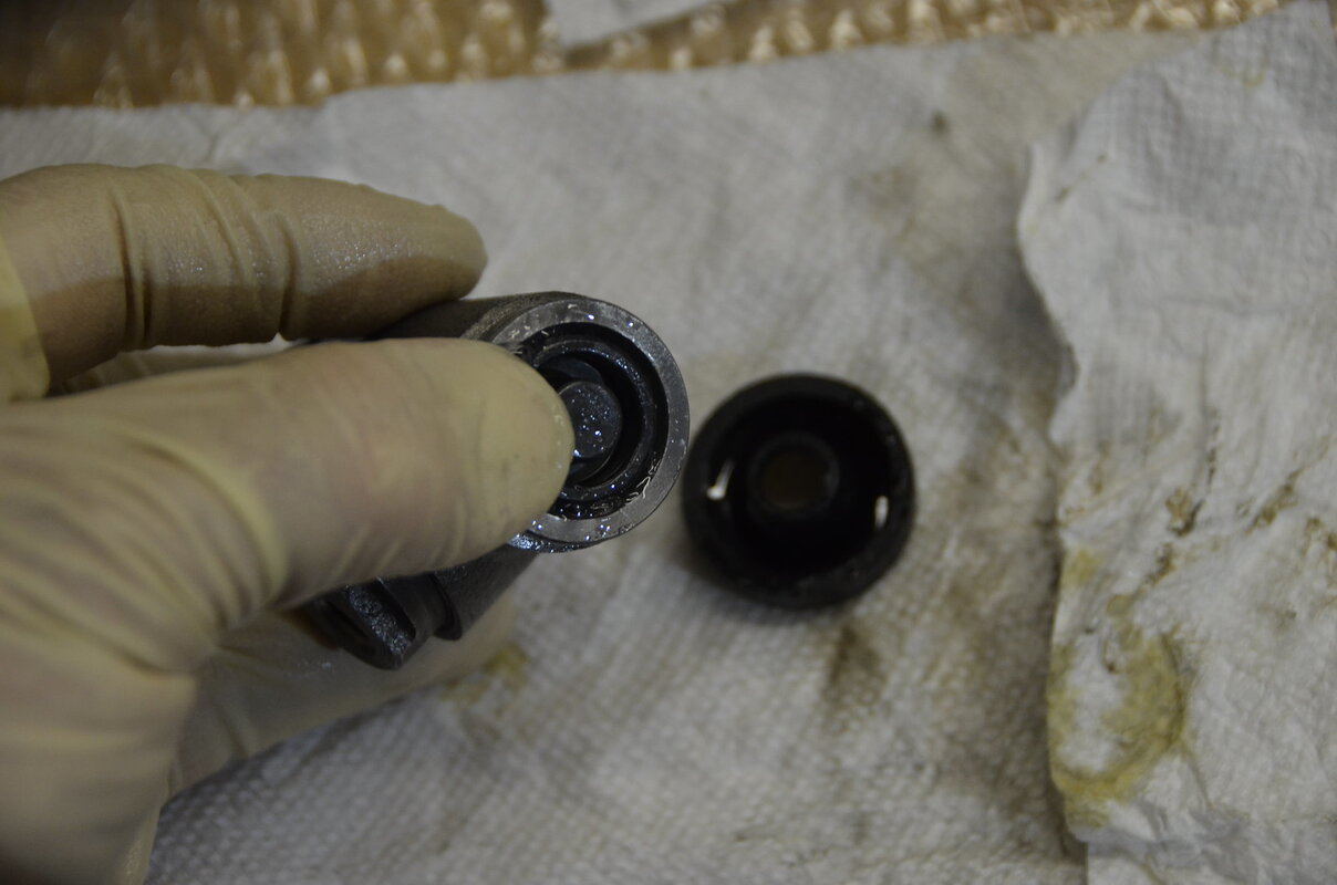

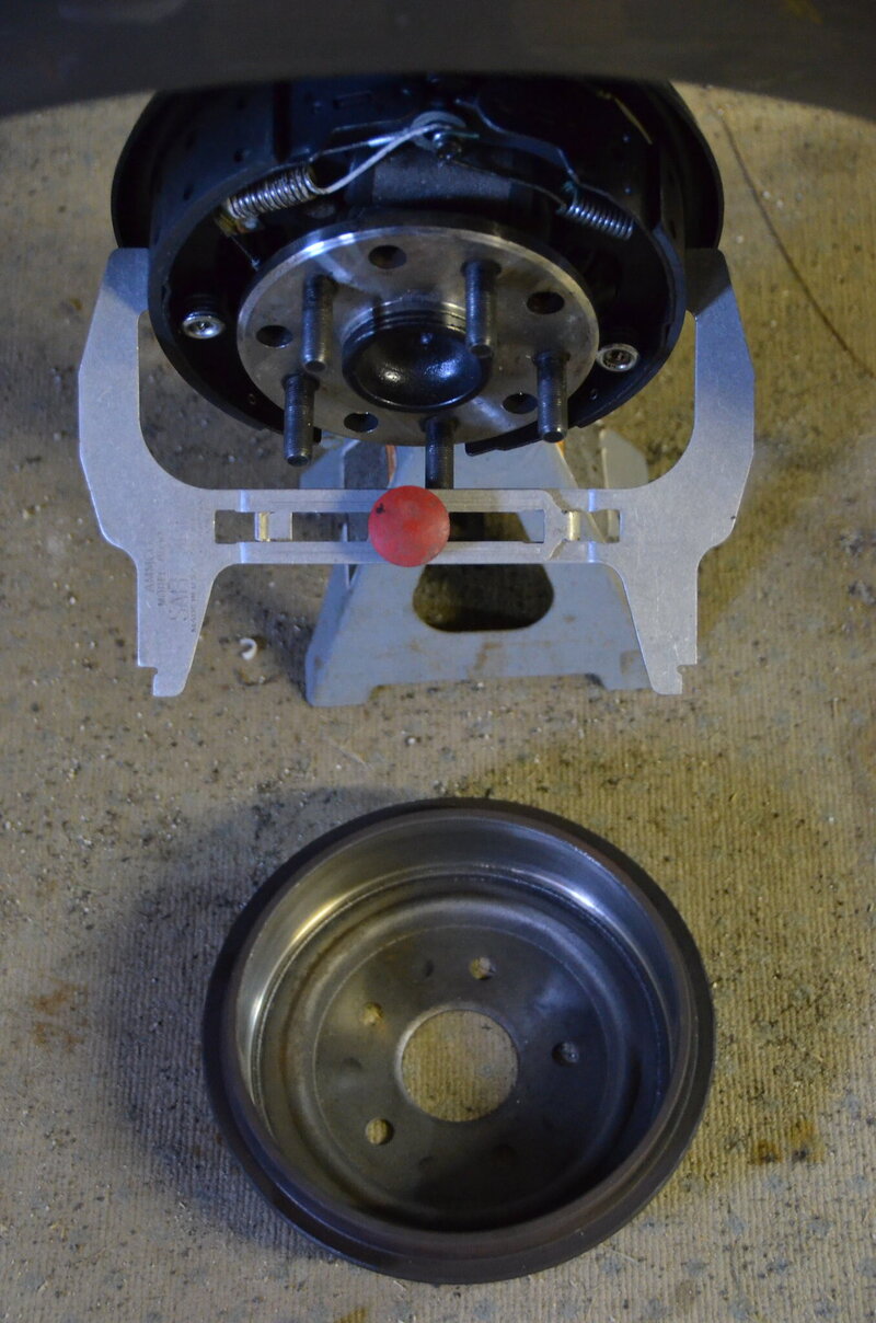

Now I do know I need to replace the rear cylinders. I was a dumbass and IDIOT for even riding until they were 100%. Parts are going on before next ride. The leading shoes are not activating, only trailing.
BUT... I still dont like idea that the brakes are linked. The service manual shows the rear master cylinder is 14mm bore, and that should be great with the two rear cylinders. There also is (per manual..) a proportioning valve also.
