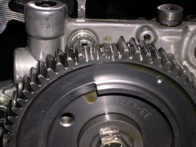

    Has anyone had any trouble with the wear pads on the cam chain adjusters? I just turned over 40K mile on my '11 TG and was going to pull the cover this winter and check the wear pads. I changed the cams at 20K and they looked pretty good. I've had quite a few Harleys in the past but have never kept one past 50K miles......

    50K on my '10 TG. Running synthetic oil. Not aware of any issues with tensioner.

    the newer tensioners are hydraulic if I remember correctly..should be better than the older versions for shoe wear

    The only time I've seen the newer style shoes wear quick is when some have been assembled wrong, the plunger and spring gets reversed. I replaced on on my dads just shy of 20,000 that was assembled wrong. I'll be inside the cam chest of his this winter checking things, so I'll have a chance to see how the tensioners are wearing.
    The new style are very much heads and tails better than the older ones. The old style had quite a high failure rate which Harley knew about yet took 8 years to acknowledge and rectify in the 06 Dyna and 07 and later twin cams. They also offer a conversion kit for those who have the old style and want to switch to the new style, of course it will cost you.
    http://i1347.photobucket.com/albums/...pswnuweejq.jpg

    I have used stock replacement shoes, SE hydraulic cam plate and gear drive. Stock shoes should last another 40K. I had one in 2 weeks ago with 50K and they had virtually no wear at all. On my own at 30K they were ready to split at the pin. The stock replacements are the inexpensive route to go, but if you are a mileage rider and your shoes are showing the average wear at 40K you might take the plunge for the hydraulic cam plate with the high volume oil pump.

    Default Re: Cam Chain Tension shoes
    Quote Originally Posted by Krautster View Post
    I have gear dive cams in mine..
    Gears are great as long as the crankshaft run out doesn't get much past .003 and some can still run them at .005. Get much more than that and you'll have something like the picture below. People think gear drive is install it and forget it, which isn't the case unless you address the crankshaft by having it trued and plugged, or plugged and welded. Without addressing the crankshaft you still have to pull the cam chest apart from time to time and inspect it and check the crankshaft run out.
