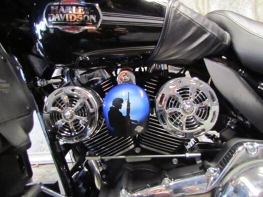

    Ok I don't want to start a bashing of fans, but I am on the fence and need advise. I am considering the LuvJugs, or the Wards fans. Please help me understand the benefit of each, lets just start and say the thermostat on the Wards is not and issue any longer.
    I would like to understand the following:
    LuvJugs basically states, use when at low speed in and around town, turn off when on highway.
    Wards I believe states leave on at highway speeds or let the thermostat control. Are both equally effective at highway speed, or does one have an advantage of higher velocity to push more air, therefore better at higher speed?
    Any other comments of comparison welcome.

    Quote Originally Posted by Fusionfool View Post
    I have the Wards fans. I have the manual switch...just a personal preference over the thermostat controlled ones.
    I have somewhere around 20k miles on them, including lots of rain, sleet, snow, 110* temps, and all the dust and crap from the trip up to Alaska and back. No issues, still working fine.
    I switch them on when my head temp hits 200-210 degrees.
    I have played with them quite a bit, and they are good for lowering head temps (and oil temps as a result) anywhere from standing still to up around 80 MPH. Between 60-80 mph they do not lower the head temp as much as at lower speeds.
    Just yesterday I was doing some work in the garage (ambient temp 65*) and after idling for awhile the head temp was up to 246* and still climbing. I then switched on the fans and within a couple of minutes the head temp had dropped down to 204* and still dropping.
    Last week I was running down the interstate for awhile and decided to play a bit. Ambient temp was 55*. I had the fans on and head temp was fluctuating between 202-208. (speed was 70-85 mph) I switched the fans off and over a few minute period the head temps rose to 230*.
    I have never used the Love Juggs, I just have not gotten past the look of them. I do like in their video how they submerse them to show how impervious they are to water. I did wonder why in their comparison they do not include the Wards fans.
    If the Wards fans did not exist, or if they did not cool sufficiently, I would bite the bullet on looks and get the Love Juggs.
    Wish I could give you an apple to apple comparison, but hopefully the above info is somewhat helpful.
    I have a set of Ward's fans, I liked the looks & smaller size and the reason behind the size, the Ward's fans have worked great. I did a lot of checking before buys Ward's, many already had Ward's & loved them, some had the HD fan & had mixed reviews most wish they had something else, a few mentioned a Lenale fan, but not good reviews and one person told me about some other twin fan set-up, but his comment was that they were so big that he might as well mount a leaf blower on the side of his trike.
    I also liked the fact that Jason, of Ward's fans, was a current member of our Armed Forces, so besides helping a member of our Military, he had a great product.

    Thanks all for the reply's / comments. I am leaning toward the Wards for two reasons.
    1. Size, if they do the job, I like the smaller size compared to the Luv Jugs.
    2. Thermostat, and the fact people such as Kevin have stated facts that even at highway speed they do cool.
    Keep the comments coming I am still interested in hearing the Luv Jug side if anyone has them please help.

    Just curious, to those who have fans of any kind on their trike, Does the fan blow the air onto your leg?? Just from the pictures it looks like they would, either brand, big or small.

    Quote Originally Posted by screwball View Post
    Yup, it blows on the right leg but it's still not as bad as the heat from the cat was at low speed.
    I thought I would really feel it. Not so much...it's there but not bad at all.
