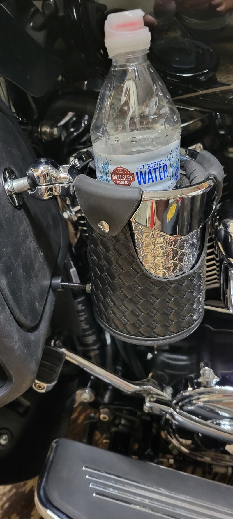

    Red face 2 new things
    1. cell phone mount
    2. drink holder
    https://www.getlowered.com/ciro-drink-holders/
    https://www.jpcycles.com/product/240...B&gclsrc=aw.ds
    Mounted the cell phone on my right and drink on left
