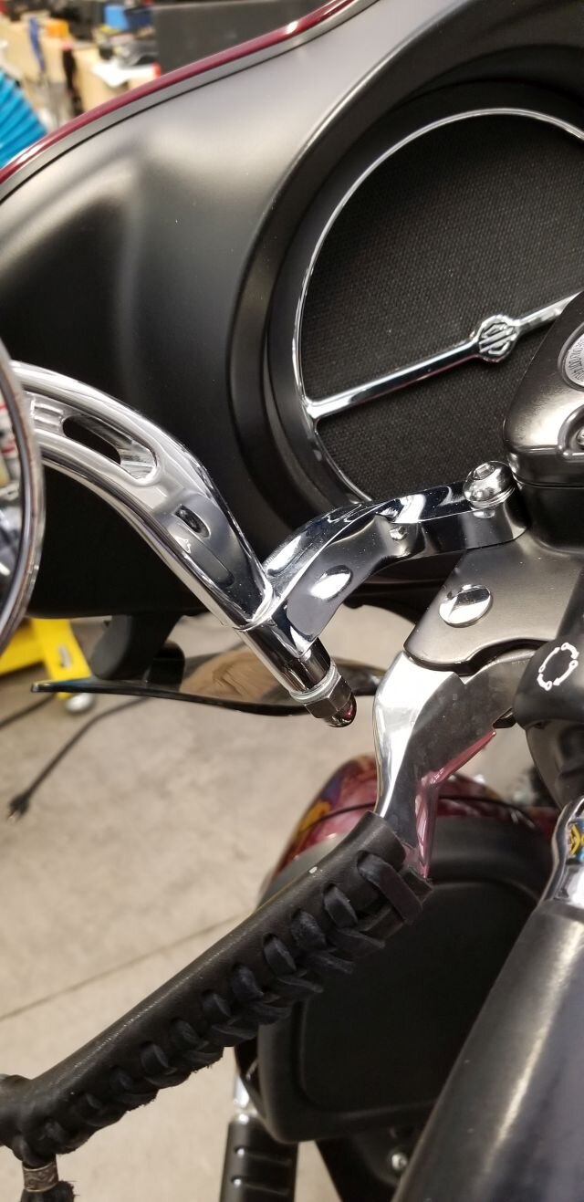

    I installed my new handlebars and grips that I received as a Christmas gift (had carpel tunnel surgery on both wrists over winter and had to wait on them to heal before I tackled this). I put on Sweepers 2+2 and Kuryaken Iso grips. My trike is a 2017 and i had to get the wire extensions (69200034). The clutch and brake lines were really tight but I was able to get enough clearance for them to work. The hardest and most troublesome part was running the wiring inside of the handlebars. I finally had to do some Dremel work on the holes at the grip areas to get the wires control wire connectors to pass through. I know some folks have depinned the connectors but my eyesight would not allow me to do that.
    So far, I like the change and I am able to sit in a more relaxed position and am even able to lean back some. As others have stated, turning does seem easier and for me especially the intersection starting out turns feel much easier.
    I am not a mechanic but I can tinker about with things so, if you are debating changing out your bars, I believe it is doable for most folks. Watch the videos on YouTube and read what others have said in the forums and you can do it. I easily saved over $500.00 by doing my own.
