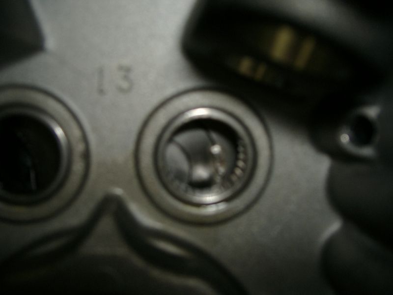

    Problem is 90% of the Harley Tech's only know to open boxes and install parts, I'm not sure if they even clean them before assembly. IMO there is no way I'd be busting open a box and straight up installing parts without checking the clearance, cleaning the part, chasing threads, etc.
    Score in the cylinder wall may have come from dirty assembly habits, these idiots need to know they have to work clean. The rod side clearance is an odd one, it has to have some sort of clearance, just might be tighter than spec. Only way to fix that is pull the engine and split the cases, of course Harley doesn't rebuild crank shaft assemblies they just chuck them and replace with a new one. IMO if side clearance is the only problem I'd send it off to Darkhorse Crank works and have them rebuild it, and plug it while they have it. The plug will help keep it from shifting, they can also plug and weld which is what I had them do when they built the crank for my 120.
    The picture is kind of crappy but you can see the plug in the center of the crank pin and the bead of weld on the crank in my 120.
