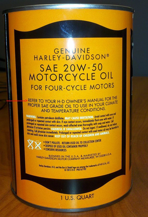

    Default Re: Mobil 1 15w50
    I wouldn't run the 15w50 in a Trike, I used to run it in my 2 wheel Ultra Classic when it was a 95" engine. Since building the 120 I sold all the jugs I had stock piled and moved to Amsoil 20w/50, like others have said, Mobile 1 V-Twin would be my choice from the 2 Mobile oils.
    http://i1347.photobucket.com/albums/...pswnuweejq.jpg
