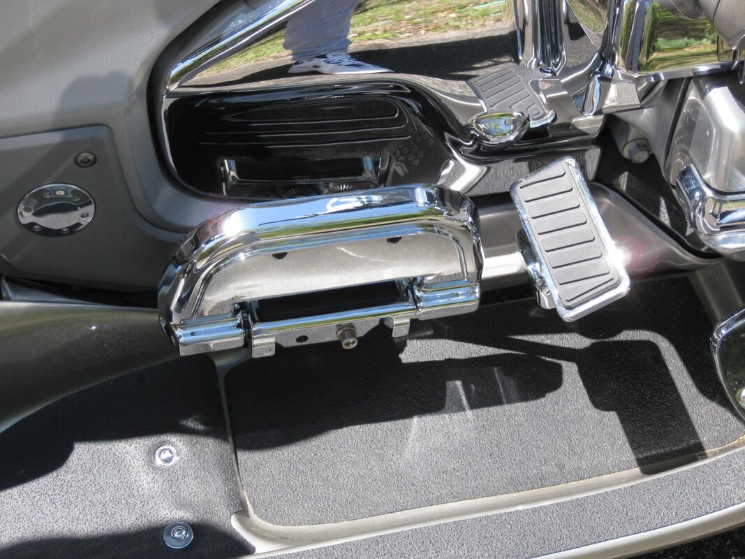

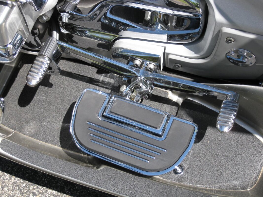

Actually, I removed them just long enough to build new mounts that allow me to flip the foot pegs straight up out of the way. Here is a picture. You will notice I use Kuryakyn ISO Pegs instead of OEM pegs. The second photo is a sided by side comparison of the two different mounts. The little tab you see between the peg mounting points is a bumper to establish level when the peg is in the lowered position. This system has kept me riding. I seriously doubt I could have continued if I had not devised a way to get the pegs out of the way once I was in the saddle.

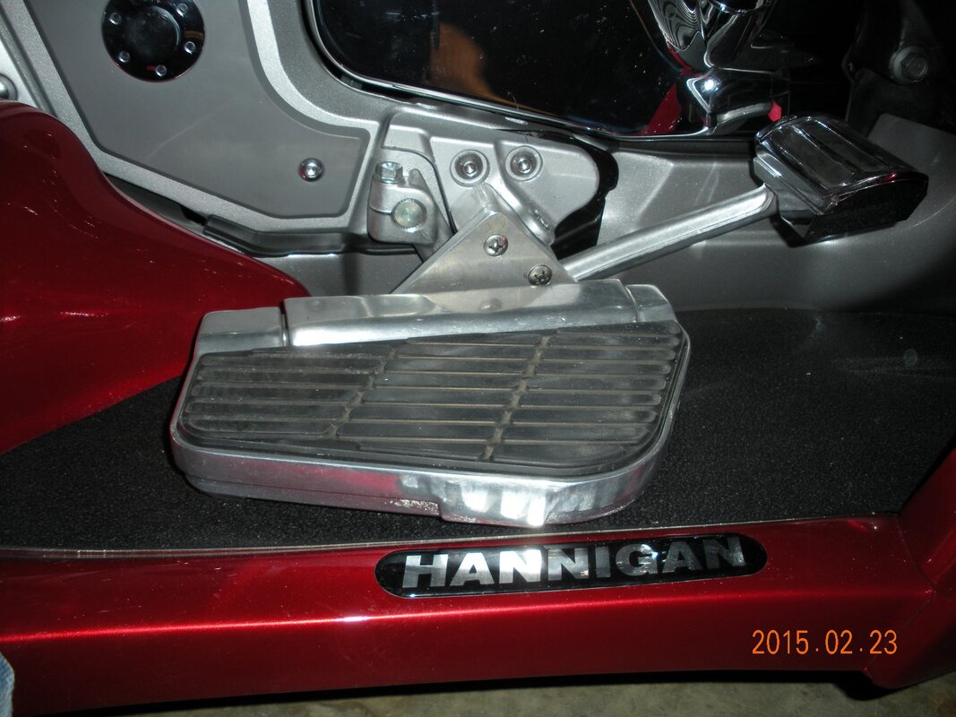

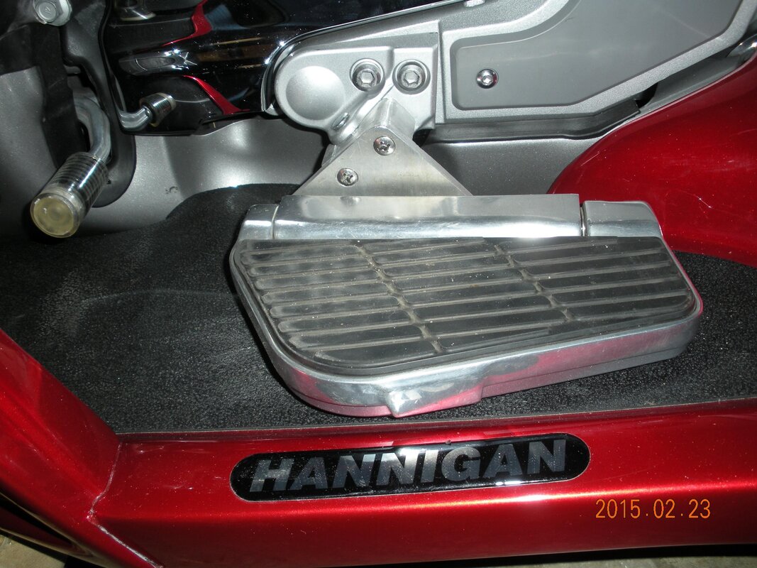

I did something similar to what Gold Rush did back in 08 on my first Hannigan trike only I used foot boards and the existing peg mounts. I made an adaptor to lower the foot boards until they were about 3/8" above the Hannigan running boards. The foot boards hinge up and out of the way allowing me to rest my feet on the Hannigan running boards for variation on long trips. The foot board allows for a rocker motion when up-shifting and is much easier than trying to up-shift with my foot flat on the Hannigan running board and they are low enough to be comfortable. Also the foot board height is better for braking as well. They work great for me and I love them. You can see them in my sig pic of the 08 on GL1800 Riders Forum or TheGLFORUM in the Trikes Sections. When I got my 2014 Hannigan I made new mount adaptors and kept the foot boards from my 08. Hope this helps. Ride Safe. Doc
P.S. I'll take a close-up pic of the mount on my current trike and post asap.
I could not up-load or attach pics with an edit so here are the foot board mounts. Ride Safe. Doc

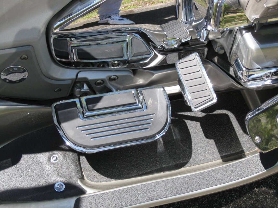

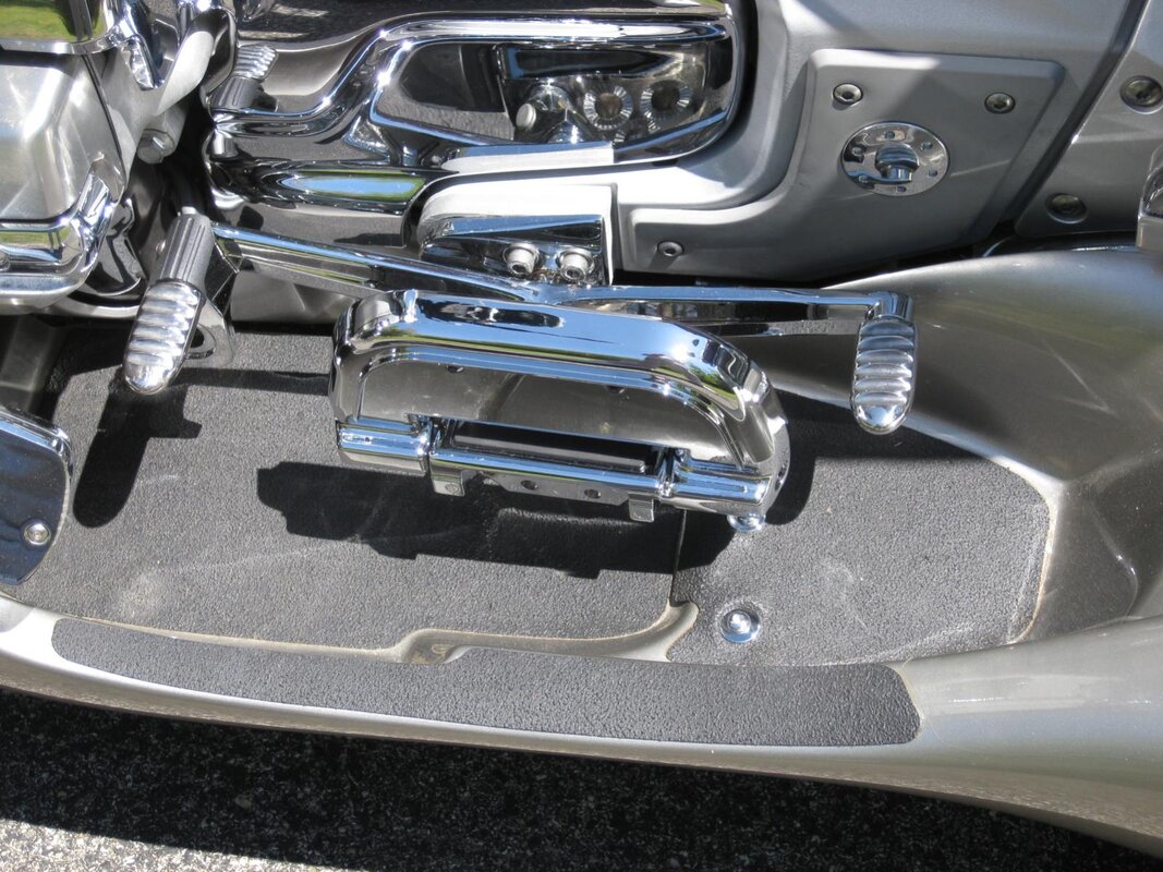

Took it all off and started over...... Kuryakyn Premium Floor Boards that fold up with their splined adapters for mounting.... and they have 5 mounting locations and fold straight up to use Aqua Shields.... #KY- 4351 Chrome Mini Boards with #KY- 8818 (2 sets) Note: 2 sets are required to get two correctly splined adapters...otherwise one board is flat when down and the other side is angled... not sure why this occurs but it did - Just FYI<br />
On my installation it also required a 5/8" thick spacer be made and beveled 3 degrees front to back that matched the mount pattern to move the heel toe shifter out to clear the Roadsmith body.... aluminum is your friend along with new longer Stainless Steel bolts and Blue Thread Locker.<br />
<br />
Photos for your pleasure....
