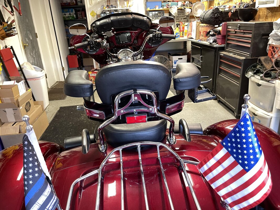

    Just added passenger armrest to the Freewheeler. These are from Graber Enterprises in Indiana. Www.motorcyclereararmrest.com

    Those are cool. Are the armrests separate or do they come with the backrest?

    Arm rest are separate and fit Any sissy bar

    Now that you've had a few months with this, what do you think? Sturdy, well built, etc.
    Do I see this correctly: the curve in the armrest back piece vs. the curve in the sissy bar defines the mounting height?

    Yes, I think it is a sturdy, well made armrest. My wife loves it. As far as the fit, you have a little leeway as far as height. You can move it up a little to use all 3 screws that go into the backrest or lower it slightly and use only 2 of the screws.

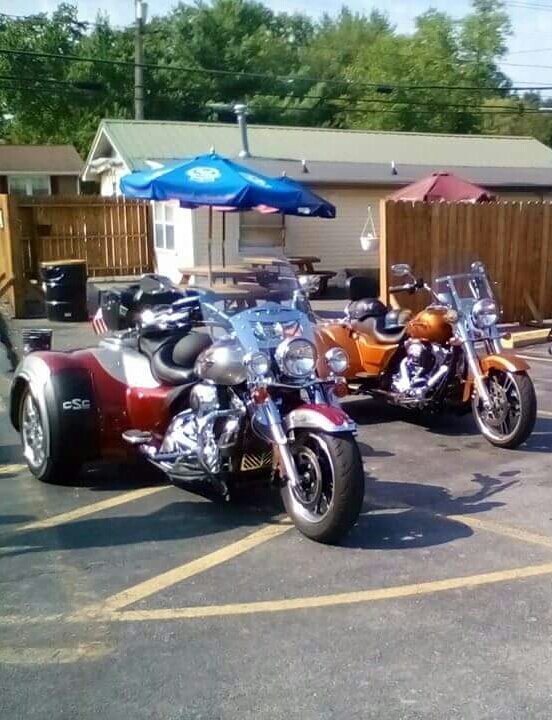

    I have one of Graber Enterprises armrests on our 2012 Kawi 1700 Nomad CSC Kruze trike and the wife loves it. I added a Bike Bike Parts cup holder. My buddy plans on ordering one for his Freewheeler.

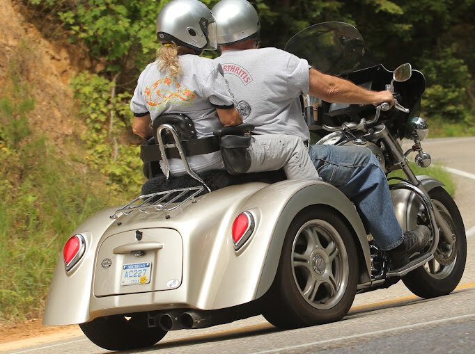

    I bought mine off Ebay for just over $200 - New version has extra meat that extends above the bar - I mounted the arm rest to the sissy bar an mounted the pad to the arm rest plate - Honey poo is very happy with it .

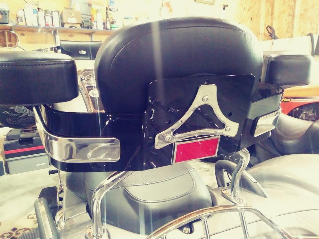

    My wife likes the new armrest. More comfort and security.
    I had to mount it with the sissy bar sandwiched between the factory backrest and the armrest plate to keep it locked in place. Looks good though.

    I had some issues with the plate moving around myself - I decided to drill a hole threw the bar at the 12 o'clock position and the use horseshoe clamps around the bar at the 4 an 8 position - once done it was solid as a rock - Then you can drill the plate and mount the pad directly to the plate much higher up for better comfort............
