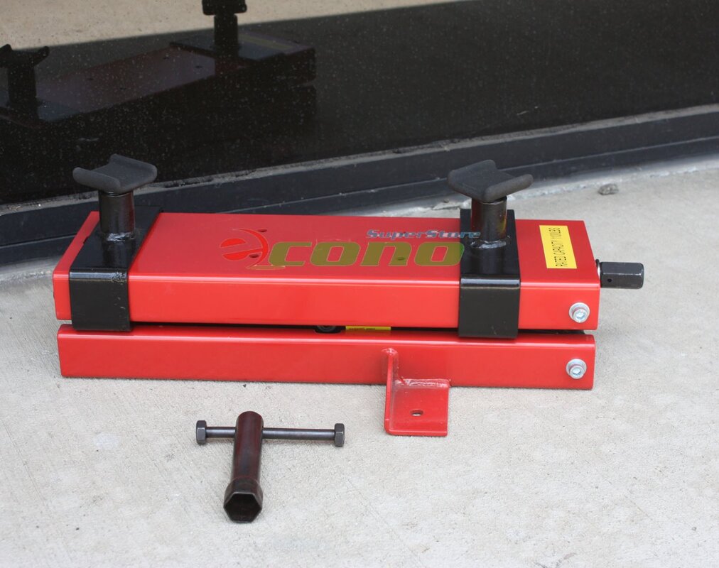

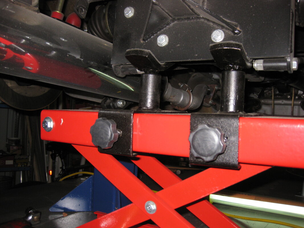

    I use this flat scissor jack and place a piece of 2x4 or 2x6 between the jack and the engine case so the weight is distributed...
    I also use it in the rear with the two adapters that came with it.... bought it on Ebay works well!!

    I have a similar flat jack.
    But it still wont fit under the front supports for the floor boards. I have to use a scissor jack from my car then I can slide it under there and get the front off the ground.
    Next time I might just try riding it up on a 2x6 1st.
    Oil changes are a PIA too as my oil catch pan doesn't fit under it unless I jack up the front also.
    I only have about 2 inches of clearance under there. The floor board support tubing must be at least a inch in diameter tube.
