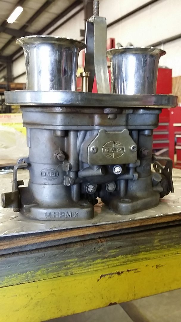

    We might could identify with a pic.
    I will take a pic of a 44 idf, a 40 idf would look nearly the same.
    I just noticed you are in pineville. That's near Alexandria right? Not that far from me. Maybe when I get mine back together we could take a scoot together? Maybe meet up at natchez.

    44 idf clone.

    Actually that is an EMPI HPMX model. Basically a clone of the Weber IDF. On Youtube there is a great EMPI carb set up video tutorial.......
    Here it is:
    It is a great beginners tutorial for initial set up and tuning. You could give your fella that link if he isn't quite sure how to approach it.
    Hell, ya might give it a shot yourself man.

    Yes that is an empi clone.
    I don't think there has been a real weber idf in a long time.
    But copies are made all over the place and they are called a weber by us but actually are not.
    Real Italian weber
    Spanish weber
    American weber
    Chinese weber
    And prob a few others.
    My pic is a Chinese weber, the empi hpmx.
    They are all so much alike the parts interchange.
    But if your engine is actually still a 1600 then I would guess it would have 40 idf carbs (or a clone of) instead of the 44's. They look the same from the outside.

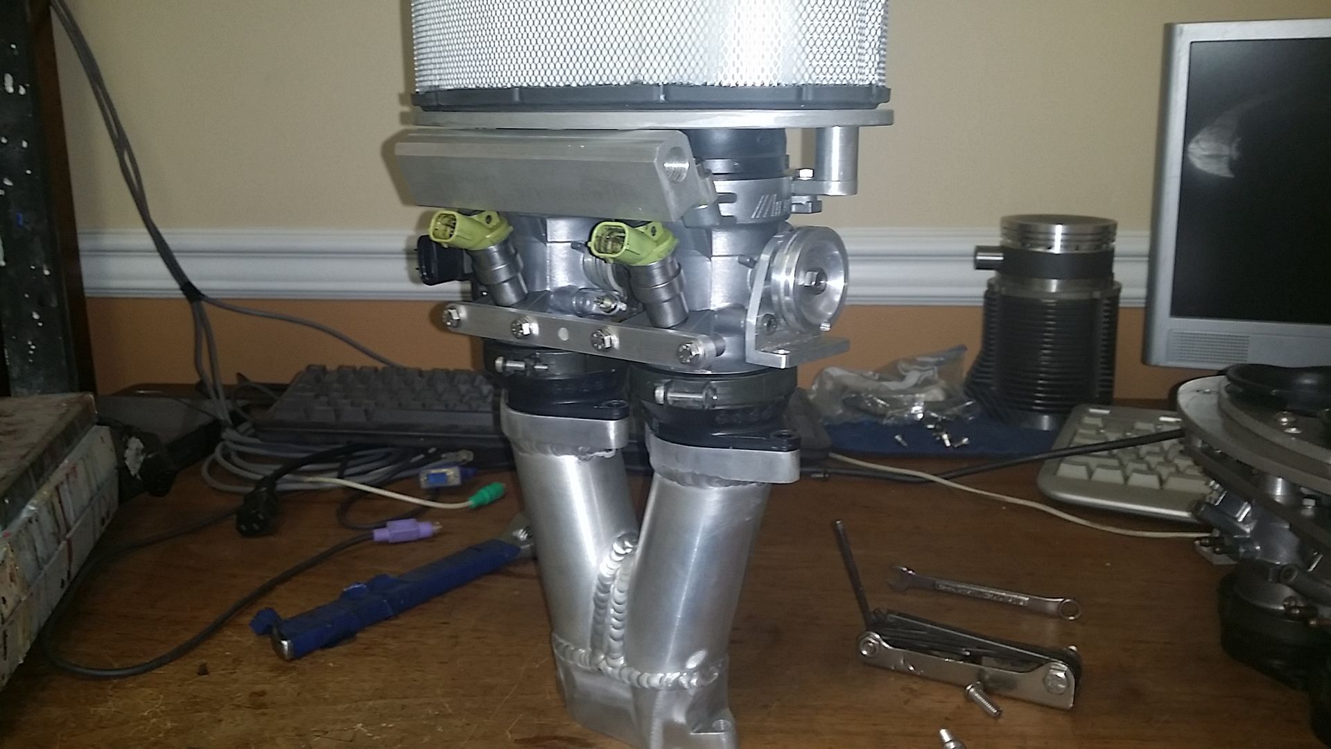

    That is one of my carbs.
    I am not going to have carbs anymore.
    I have mikuni throttle bodies with automotive injectors in them on hand made intakes.
