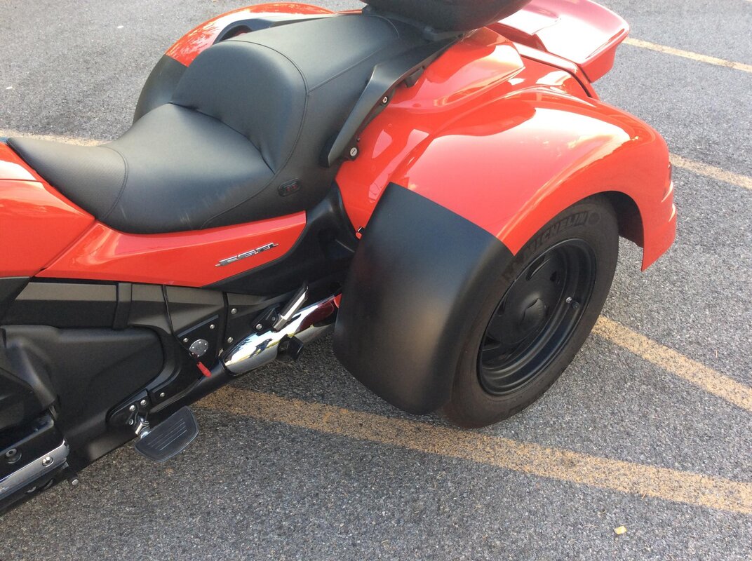

    Thought I would try this, if it doesn't hold up I can peel it off and try truck bed liner, etc. It has been on two days and about 400 miles. I have cleaned them with plain water, so far so good.

    Looks good. Heard a lot about the plasti dip, haven't tried it out yet. Will be interested to hear how it works out.

    I have used it on wheels- bike and trailer, forks and other parts, it's pretty tough. Good news is it only takes a minute to fix any scrap or dig.

    That looks good, and it's a great idea. I'm very interested in how this works for you. I'm on the verge of doing something with my rear fenders, and I may steal this from you!

    Cool idea, I just used plastic dip on the silver panels on my black 93 GW . Now its pretty much all black and chrome! I like the way it turned out.

    How did you apply it? Spray? Roller? Brush?

    From a spray can.

    Now that's something I hadn't thought of. Need to do something as I keep getting black scuffs on my left fender. From what I hear about it is it's easily removable if it doesn't work out.

    I would think this would be great for rocks too ... the rubber will absorb the impact, rather than just chip ... curious how it holds up.

    I Plastidipped my saddlebag covers on the Harley after I lost one on a ride. For now it is a lot easier and cheaper than paint, though to match I probably will get them painted this winter.
    I put 5 or 6 coats on according to tips I found on line, they lood like the matte "denim" finish on some Harleys. It has held up to being dropped and by boots rubbing against them. I had some runs (my own fault) on one of them, and I just peeled the stuff off and sprayed some new coats.
    I tried the clear glossifier stuff that is supposeed to make it shiny, but it seemed to collect more dust and stayed a bit sticky. Interesting stuff - you can get a few different colors in rattlecans and also comes in bulk that can be sprayed with a HVLP paint gun. The bulk is a little thinner to be sprayed with a gun and the hues can be mixed to create different colors.

    How did you get the tape line to stay down?? I did mine yesterday and could not get the tape to seperate from the Plasti Dip. Other than that I think it is a great product. Went on fine and pealed of just as fine. I used the clear and it was a matt finish. looked good.
