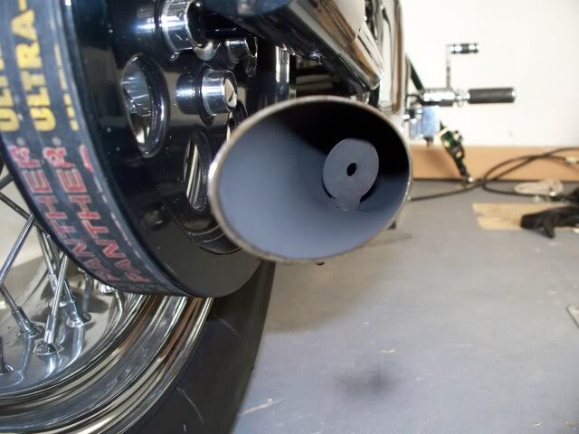

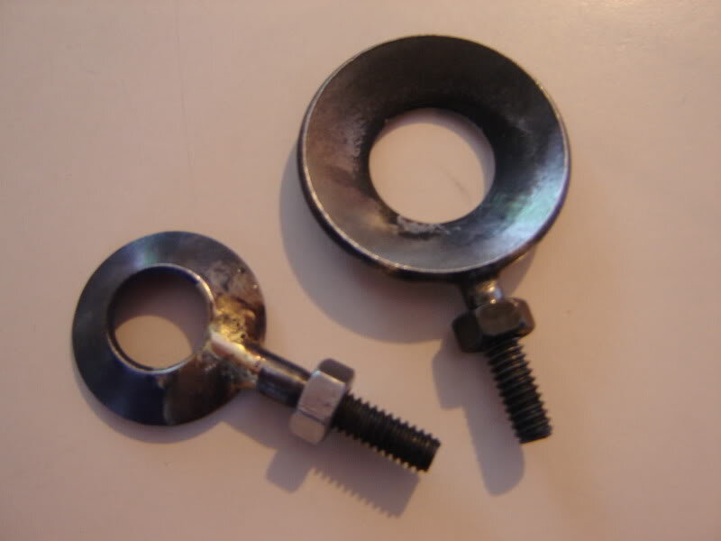

When I choose exhaust I do so based on how well it will meet my performance expectations, sound is secondary, I can't ride sound. I tried true duels one time and hated them. Yes I could have fiddled with mufflers to help quiet it, I could have installed what some call a lollipop to get some of the low end torque back.
