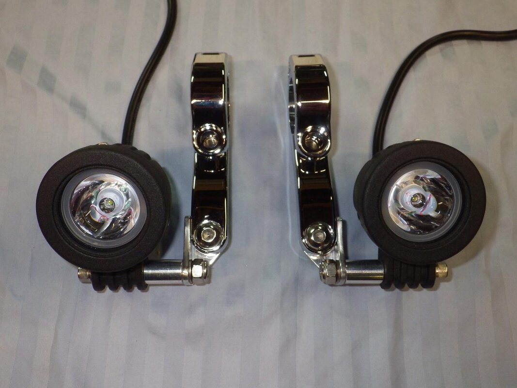

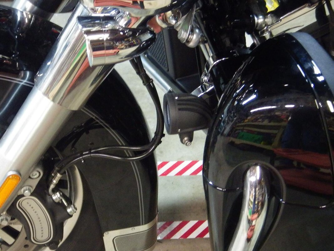

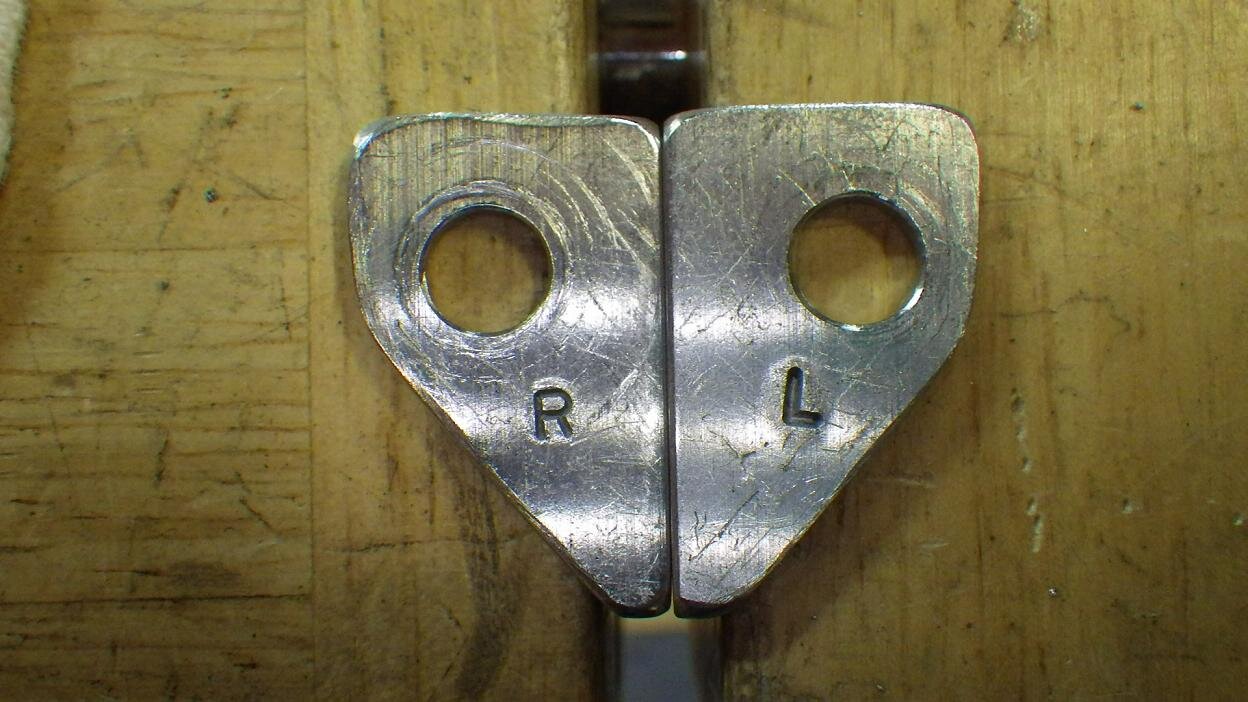

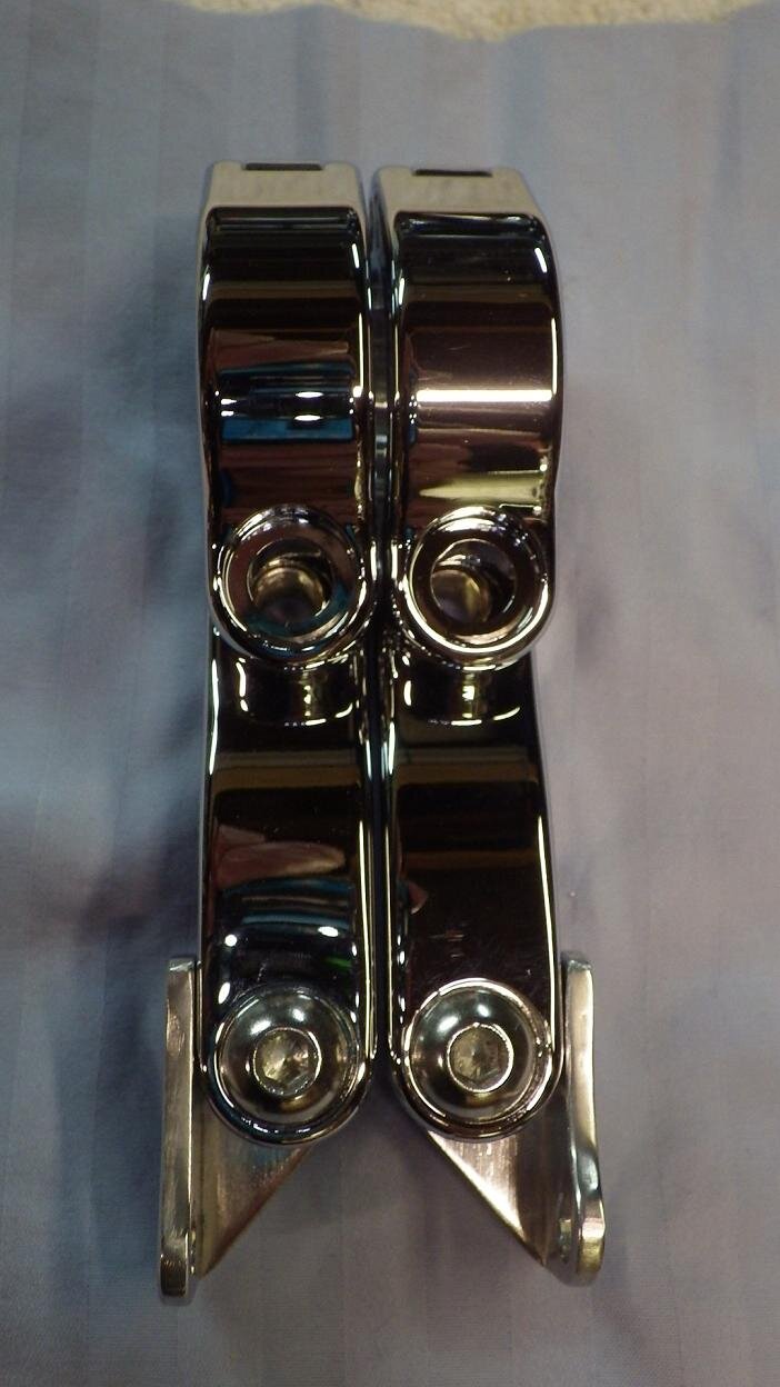

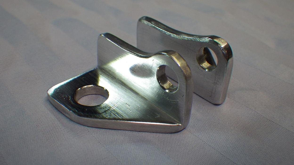

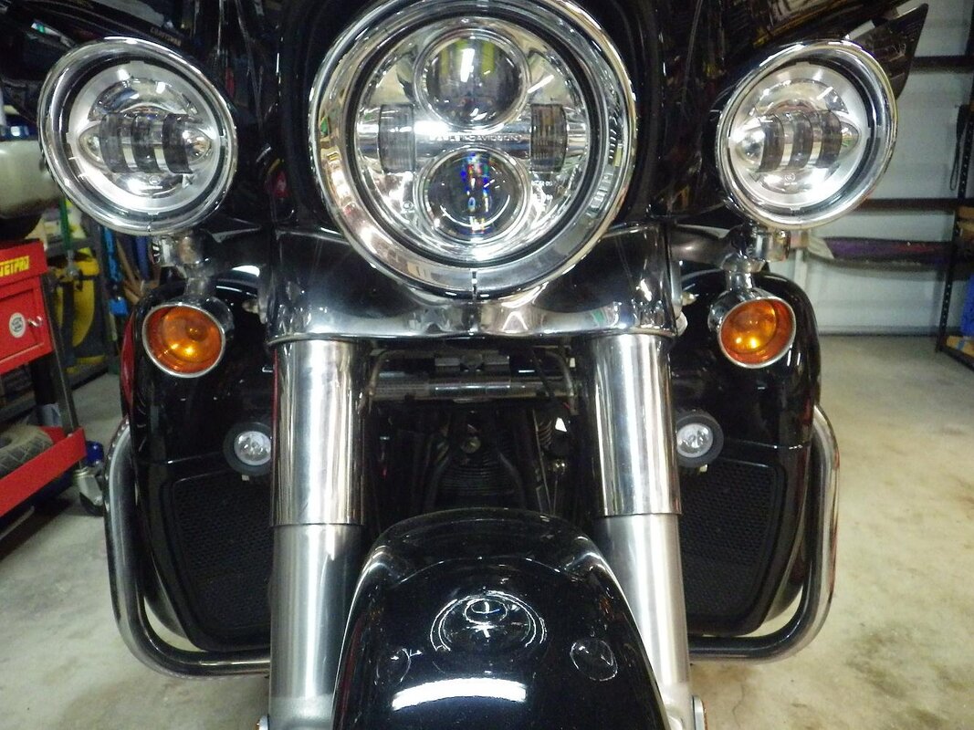

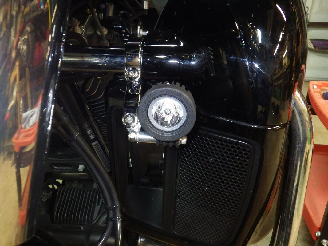

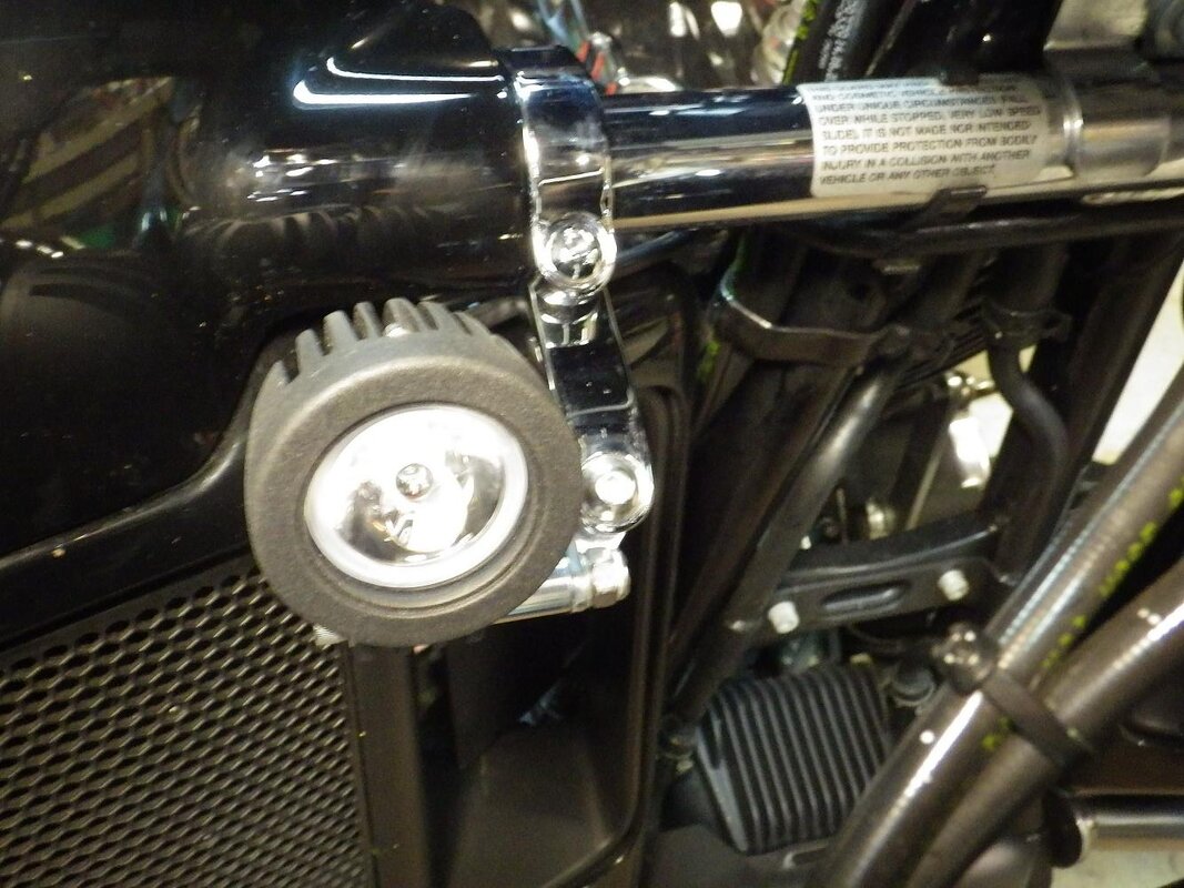

    I took advantage of the 10% off SALE and got a set of the Stealth Driving lights from DK Custom Products, and made a couple of brackets out of 1" x 1" x 1/8" angle aluminum to mount them to the top of the engine protection bar using a HD Bullet Fog Lamp mounting kit (long chrome) part # 68000170, plus a couple of spacers and longer bolts.
    I do not have them hooked up to power yet, as for me that will be more of a challenge. But I got the brackets made and mounted, and they fit in this position like a finger in a glove.

    Nice mounting

    Nice, I have been thinking about adding these lights on the triglide. Jim

    I just might steal that mount for myself.....Nice fix - jc

    Nice and clean.....

    Great Job ... Like they were made for it ...

    Those lights are on my list. Just have not settled on a location yet.

    That's some nice work there!
    I have mine mounted down low, for doing some testing for mounting on Freewheelers with no engine guard, but have decided to go back the the engine guard mount.
