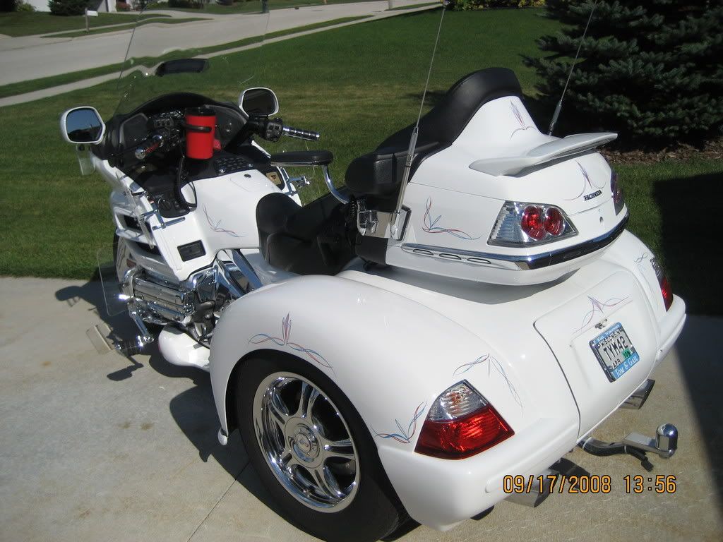

    My Champion has the square stock insert with a piece of flat stock where the ball is attached.
    This is the factory one that came with the kit.

    I can see why we are all confused. I own an '04 CSC conversion on a GL1500A, and the drawbar in that last pic is completely different than mine.
    Mine uses the 1 1/4" square bar that slides into the receiver.
