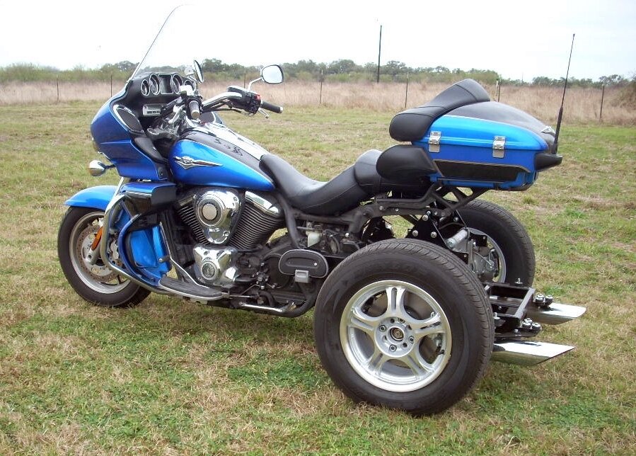

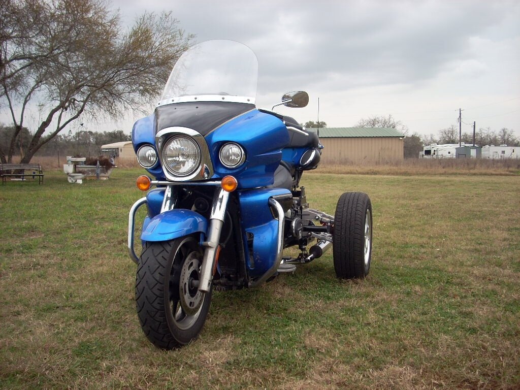

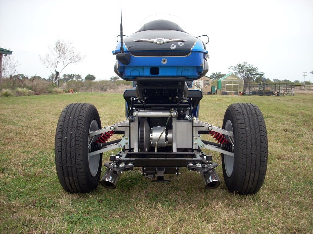

    I posted a while back about the progress on my Kawasaki Voyager Champion conversion, and how it was unrideable, with the front end flopping hard left, or right.
    Well, I found the stupidly simple solution; drop the rear tire pressure from 35 pounds to 20 pounds. Yep, that's all it took. Lowered the rear end by a 1/4" and now she's a dream.
    Me n Mama went for a little spin, sans the bodywork, and it was a pleasure. Still waiting for the rear brake residual valve. Once the rear brake system is done, it will be time to put on the bodywork, and wrap things up.
    Easy to back out of the shop, and U-turns are a breeze. I'm gonna like this, for shore.

    Looking good so far!!!
    Glad you found a simple solution!!!

    Are they stock pipes? Does Champion replace the exhaust?
    Tryke Flyer!
    2010 GW 1800 with 2010 CSC Cobra kit
    2010 Kawasaki Voyager ABS with 2016 CSC Kruze Kit - Gone but definitely not forgotten.
  7. #7
    60+ Posts trikerbiker634's Avatar
    Jul 2015
    sun prairie, wi
    69
    Default
    is the exhaust fairly quiet? and champions own exhaust for trikes?
  8. #8
    850+ Posts Rmitchell55's Avatar
    Dec 2012
    Santee
    893
    Default
    Stock pipes for the 2009 Kawisaki.
    Ray
    2017 Harley Triglide
    Tijuana Border
  9. #9
    250+ Posts 2Paps's Avatar
    Jan 2016
    W FL Panhandle
    255
    Default
    Hmmm, interesting. CSC changes out the aft end of the exhaust and replaces it with "theirs."
    Tryke Flyer!
  10. #10
    250+ Posts Dirtydan's Avatar
    Jul 2015
    San Tan Valley, AZ
    262
    Default
    On my Champion they sent new intermediary adapters for the exhaust. They go between the muffler and the head pipe. Stock mufflers on mine also. Although they are gutted.
    I had the hardest time bleeding the rear brakes. I had it together once bled and done. But I routed the line incorrectly coming off the master. So took it apart, re routed and put it back together. Couldn't get an air bubble out to save my life. Even with a vacuum system. We finally took it all apart and with low pressure and the aid of some plugs forced fluid through section by section. Brakes bled finally. Phew!
  11. #11
    60+ Posts KWSchin's Avatar
    Oct 2015
    Cuero
    62
    Default Stock Pipes on the 2009 Voyager
    "Are they stock pipes? Does Champion replace the exhaust?"
    Champion's conversion for the Kawasaki Voyager uses the stock head pipe, and mufflers, with extensions. The left muffler pipe has to be cut, but the right is used, as is.
    The stock exhaust is not quiet, but it's not loud either. It's got just enough noise for both my wife and I to be happy. :-)
