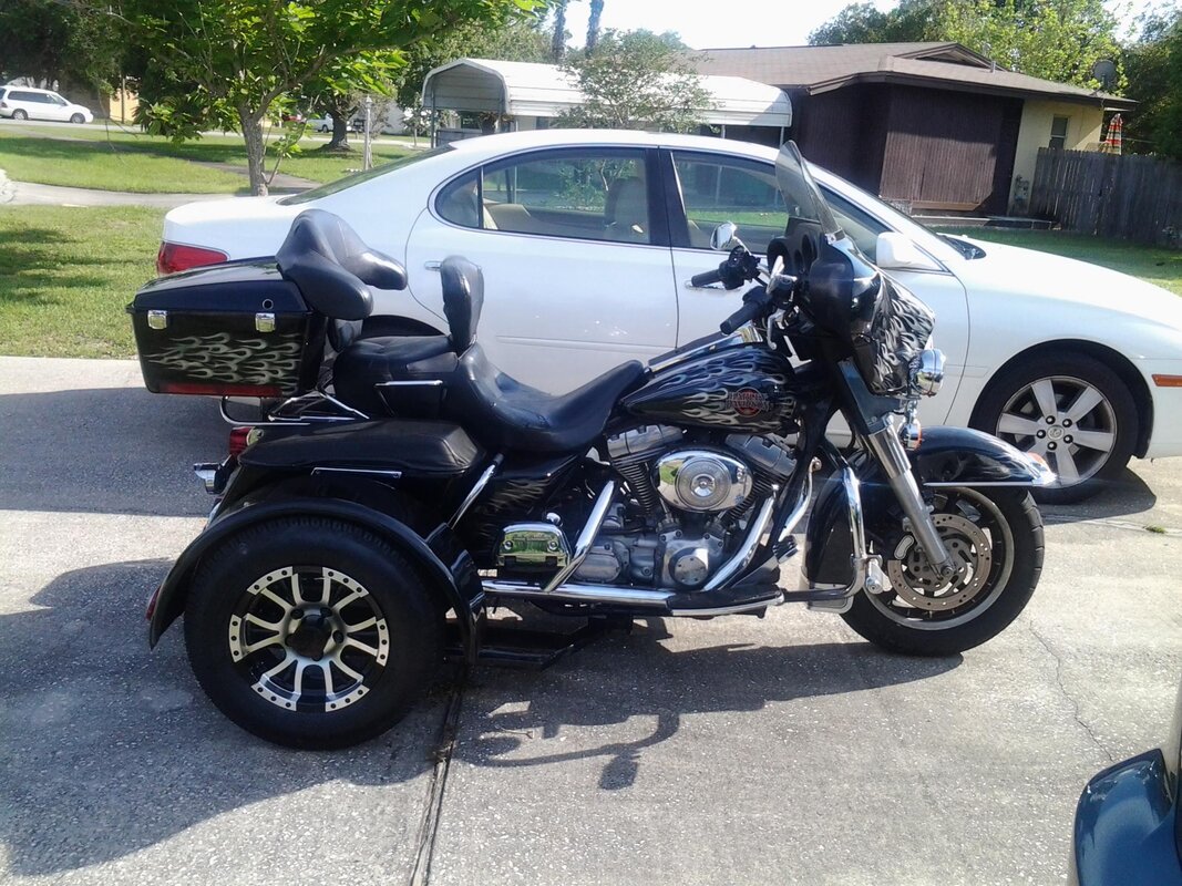

Im running an 80" evo with a E-27 (mild cam) I seldom find a wish for more power. The mild cam is ALL I have done with my engine because I am of the school that the more you do to an engine, the more you will have to do to an engine.
The Harley motor has lots of torque. Top speed 90 mph.
I pull a small trailer also, don't let anyone tell you, you HAVE to hop it up.
If your not into go fast all the damn time everywhere you go your 88" will work just fine.
sending you a private message ok?
I'm not a member of trike talks staff or a sponsor who you would buy from, I make no profit from this at all ok?
Just another rider and builder of my own trike.
You can trust what I tell you.
Check out the build threads if you wish?

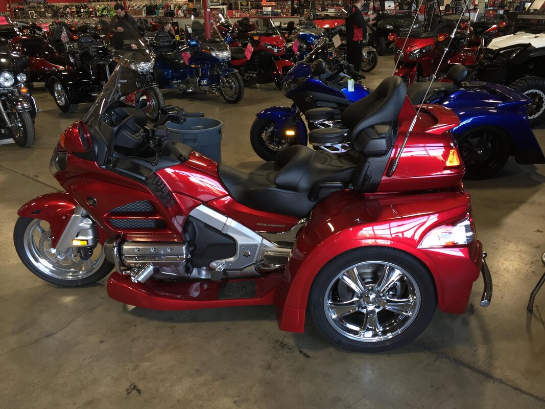

I decided against triking my 2004 Harley and put it up for sale. I am going to the Dark side if everything works out.

You might post a pic of your trike,my friend,before people get the wrong idea. :D
