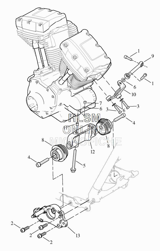

    Are you sure the knock is in the rear?.... Just in case check the two 9 1/16 bolts that hold the steering stabilizer to the front cylinder head.. I had them come loose and when i hit a hard bump it sounded like the shocks bottoming out. If their ok then i would try 40/45 psi in the shocks...

    YES.....the dreaded front stabilizer bracket could be.......

    If thats his problem... # 3 would be the bad guys.... Also it wouldn't hurt for anyone with a Tri-Glide to check them ...Especially 2010/2011 model years...

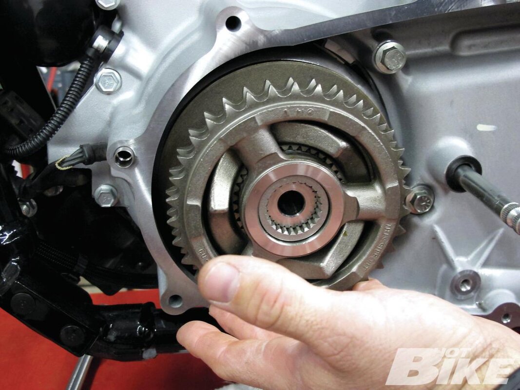

    Are you sure it is not the compensator "clunk" ..... ON / OFF gas get a "clunk". It can also happen when hitting a bump.
