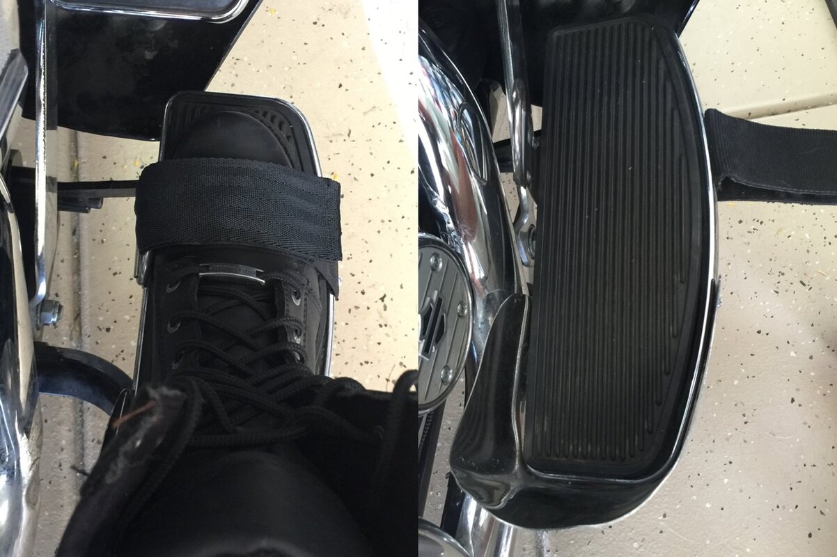

    I'm also one of those who rides with Harley Boots and jeans (or armored riding pants when doing highway miles).

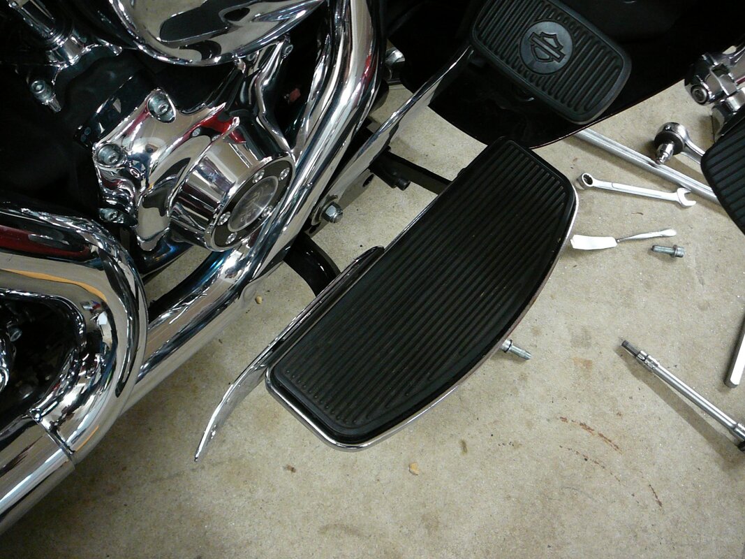

    I also have 1" floor board extenders. I have a set of billet 2.25" floor board extenders (extremely strong) if interested message me for details.

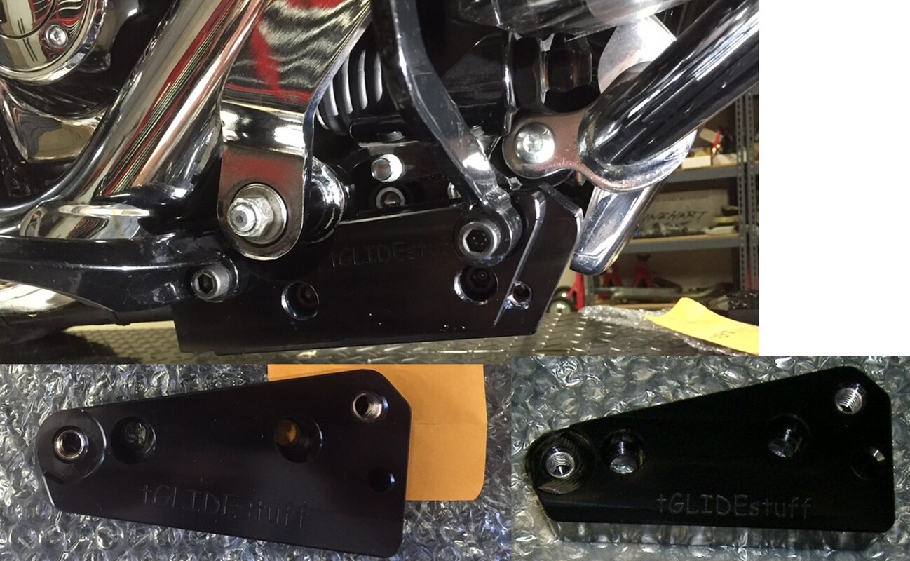

    Here is a setup I saw in a couple of other forums that tglidestuff used to sell. I am not sure if they are still around. But if anyone know of something like this out there, I would appreciate hearing from you.
    I have a design and will ultimately fab something. But is there is something out there to do this... why re-invent the wheel

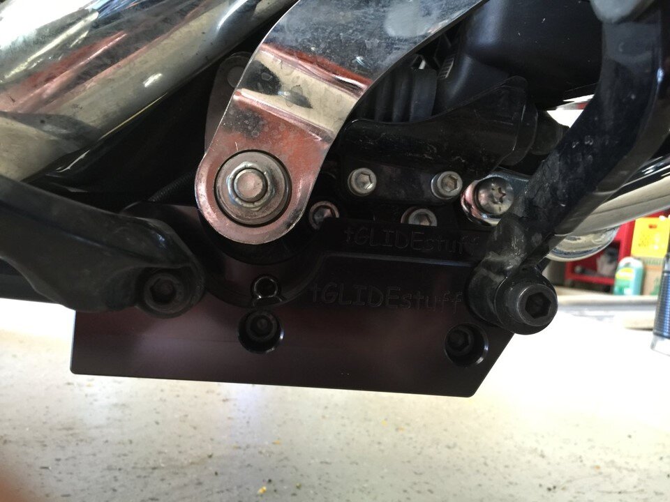

    I still have them. These were a limited run and not available. I will do the pair for $160 shipped. These are NEW units black powder coated with all hardware needed. This where the right will be at. If interested e-mail me impalabob at gmail dot comName:  Right Stock Position top view.jpg
