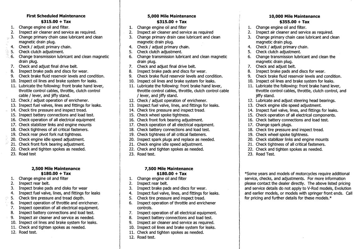

    If you look in the manual at all the things that are "supposed&amp ;amp;amp ;amp;quo t; to be done, it would definitely be a 3 hour job. They came and told me they were finished after 2 hours.
    The service guy said they knew I was waiting so they put 2 mechanics on it. Well, who knows if that was true or not, but I spent several hours going over it when I got it home.
