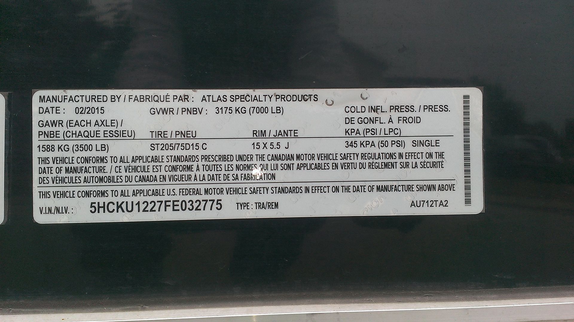

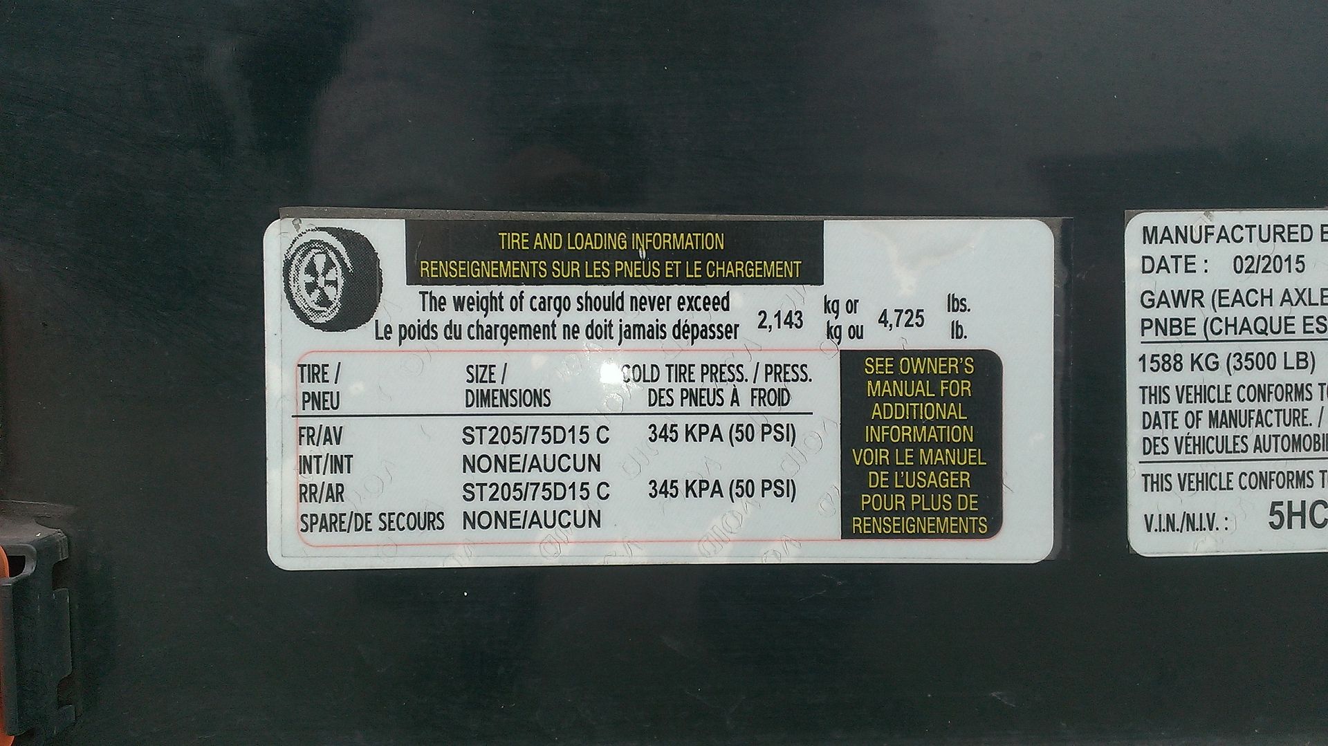

    I appreciate the detailed explanation! I did take a lot of this into consideration before our trip out to South Dakota. The truck had a trailer towing capacity (not GVWR) of 14,000 pounds; I knew we were covered there. The bikes combined were a little under 1,600 pounds & the trailer I believe was 2,275 pounds. I deduced that from the plates on the trailer:
    It says here the trailer GVWR is 7,000 Lbs.
    It says here the cargo should not exceed 4,725 Lbs. Subtracting the max cargo wgt from the GVWR should, I believe, equal the trailer weight - am I correct?
    So - a Freewheeler is just under 1100 Lbs wet, my Limited is about 900 for a combined 2000 Lbs. Although I don't think they would fit into the trailer I just rented (but I would love to hear differently!), they would be well within the weight capacity of the trailer & the tow vehicle.
