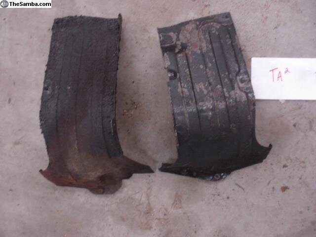

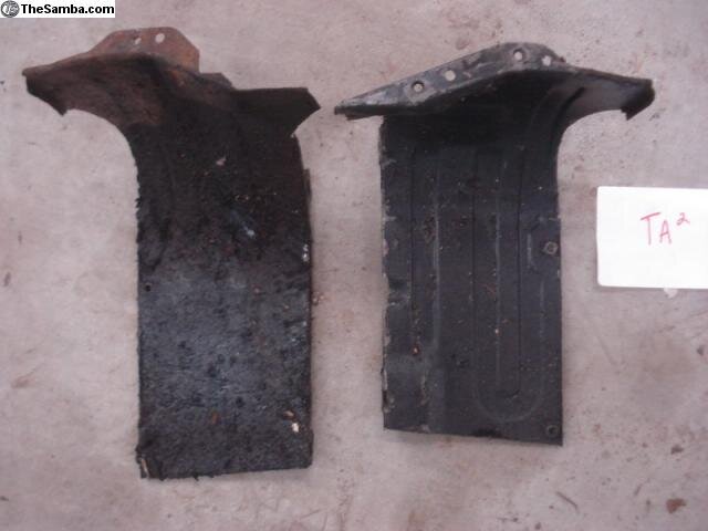

    A couple of thoughts about fans under the cylinders. Incorporate a lower shroud similar to the stock VW car shroud but put the opening facing forward. Mount the smaller pancake fans at the front opening pushing air back into the shroud. This would accomplish 2 things. It would keep the fans out of the engine heated air flow and the shrouds would act as air rams at speed. The air flow would follow the natural convection flow path upward.
    VW cars needed the larger fans and elaborate tin work because the engine was surrounded by a body and they needed to force the cooling air down, against the natural air path of heated air, and out from beneath the body.
    Here is pictures of the typical lower shrouds. They normally hang off the tins above the cylinders with the curve forward and the flat end rearward. This was to direct the heated air out the back from under the car. These are usually the first thing to come off a dune buggy, baja bug, or trike application.

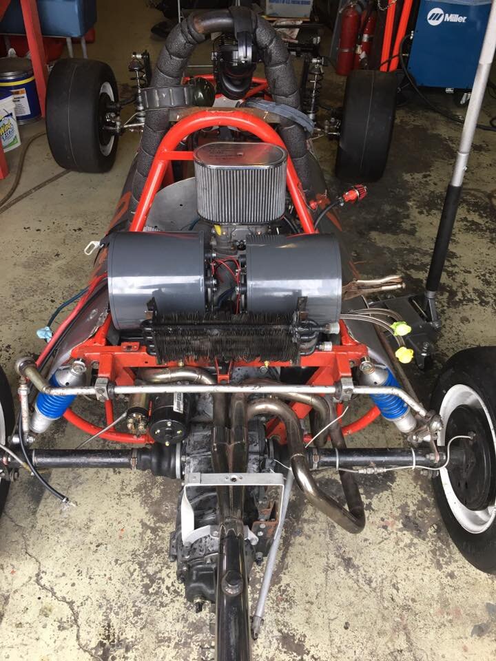

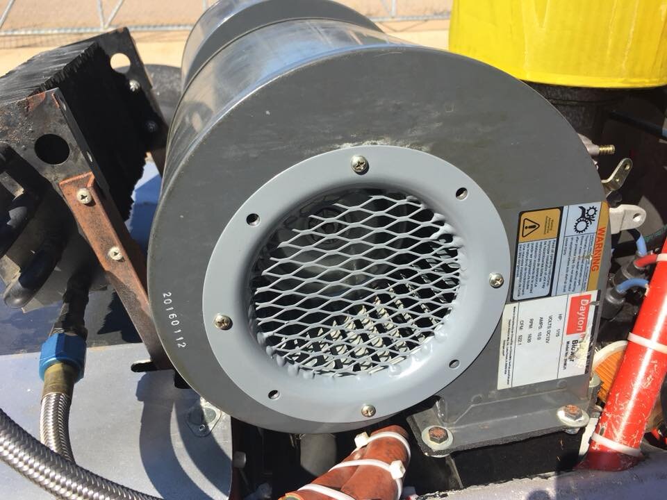

    I did with my formula Vee that I autocross raced with. Name:  06DB1007-CD28-4274-B84C-22AF4465F489.jpeg
Size:  207.0 KBName:  FD3AE495-D202-467E-99DB-D372E4EB54FE.jpeg
Size:  153.4 KBName:  1203F6BD-3D8E-40E8-92ED-92C501CB7599.jpeg

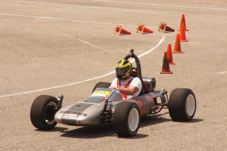

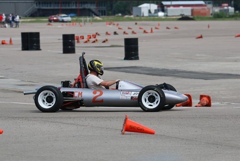

    Here is my old Formula vee that I autocross raced with 2 BIG 12V fns. NEVR overheated on a big motor.Name:  a.jpg
Size:  91.9 KBName:  b.jpg
Size:  90.4 KBName:  c.jpg
