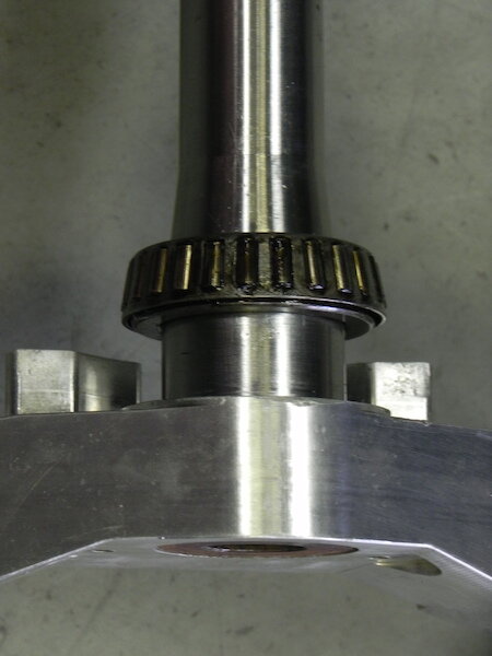

    Default Undersized triple-tree steering stem
    Today I was installing a new set of tapered bearing onto an easy-steer triple tree. The old lower bearing drove off unusually easy. Once the new bearing was installed, I discovered why ... the bearing race spun on the steering stem instead of the bearings spinning on the race. When the customer was notified, he requested that the new bearings be installed anyway ... NOT !!! Sorry, but this is a "no-hack shack."
    Unfortunately, the stem was incorrectly machined when new. The error should have been caught then.
