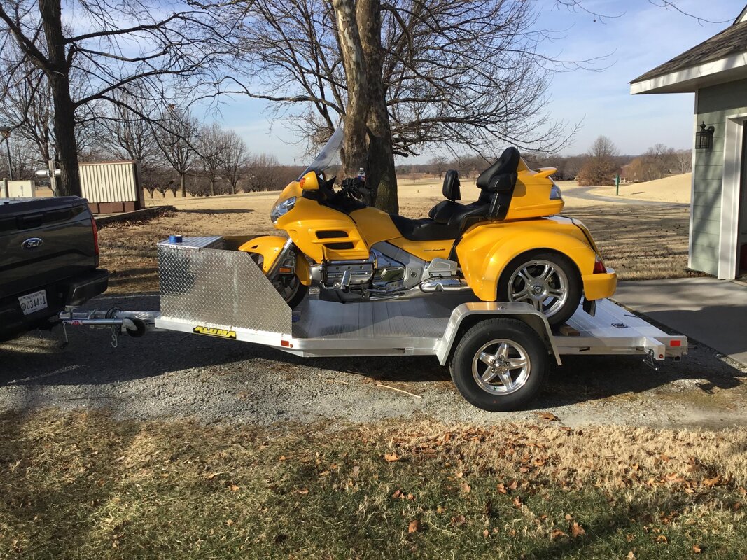

    I went out this morning and bought the Aluma TK1, very nice trailer. They have not secured the front wheel chock to the floor, I have to load up the trike and figure where to mount it for proper hitch loading, any suggestions best way to do this. I'm going to enjoy this trailer, many places I still want to ride but don't have the stamina to ride the trike to get there. The first place I'm heading is the Talimena in Southeast Oklahoma.

    Quote Originally Posted by jayhawkokie View Post
    Here is a very good link to various ways for measuring the hitch weight. General rule of thumb is that the hitch should carry 10 to 12.5 percent of the loaded trailer weight. I have used the bathroom scale version for years and it works very well. A bit of a pain in the butt to set up. On the up side I can do it right in my back yard. Hope this helps you.

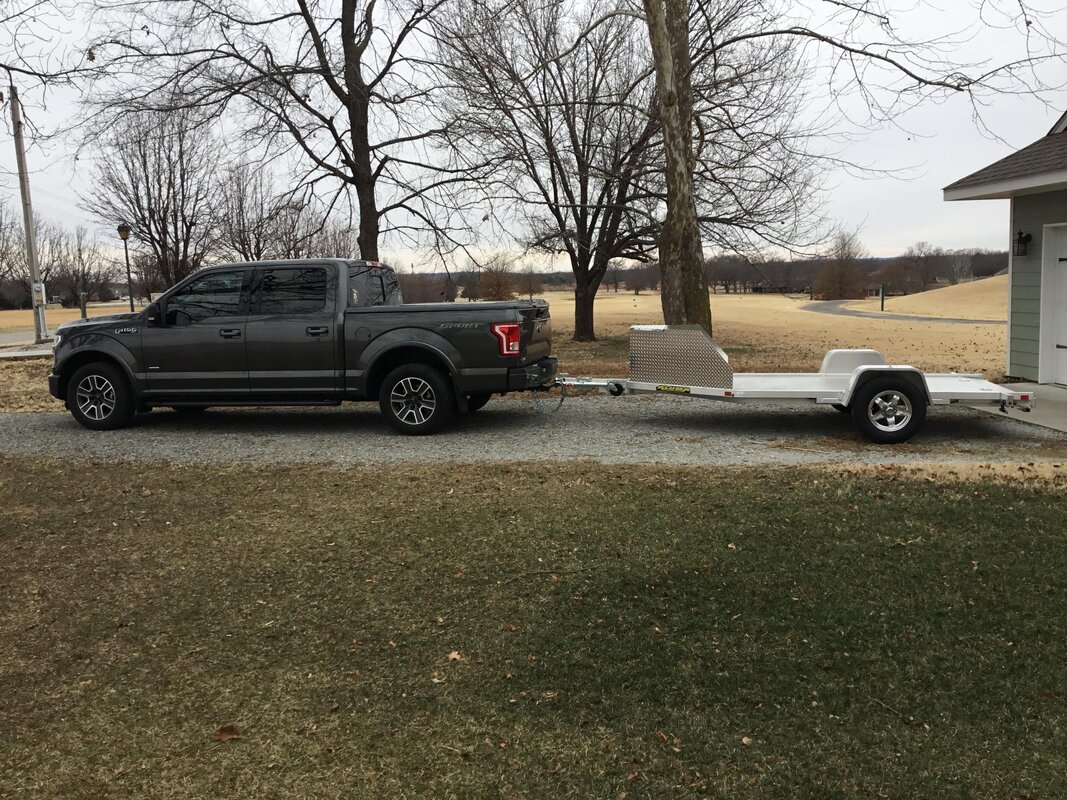

    This little trailer weighs 525# empty, with my trike loaded it will be combined weight of around 1665#, should tow pretty easy behind my F150.
