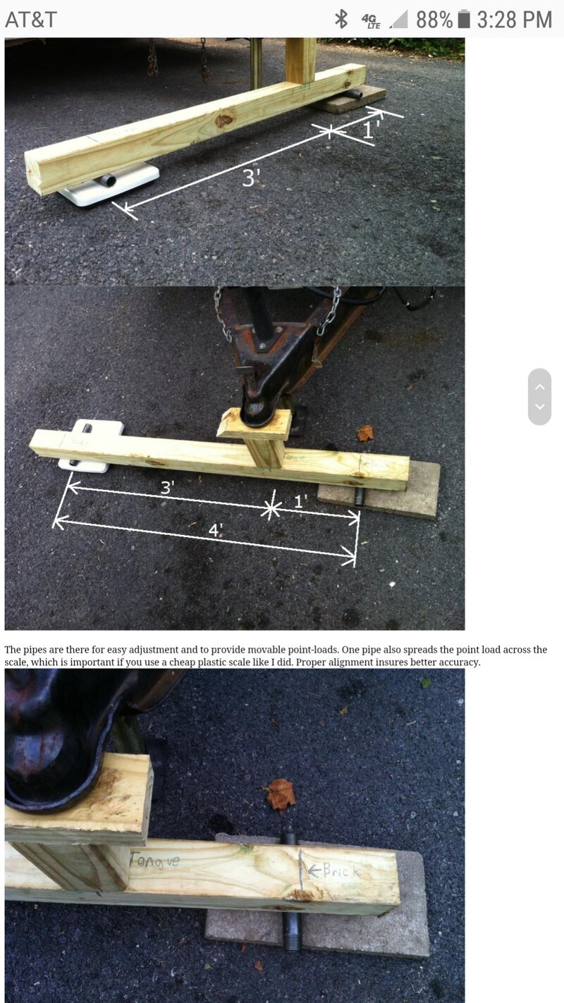

    I used this method. Weighed trailer one wheel at a time and then the tongue. Then pulled trike on and slowly moved forward until the weight I wanted was reached. Set up like this the scale shows 1/4 of the actual weight.
