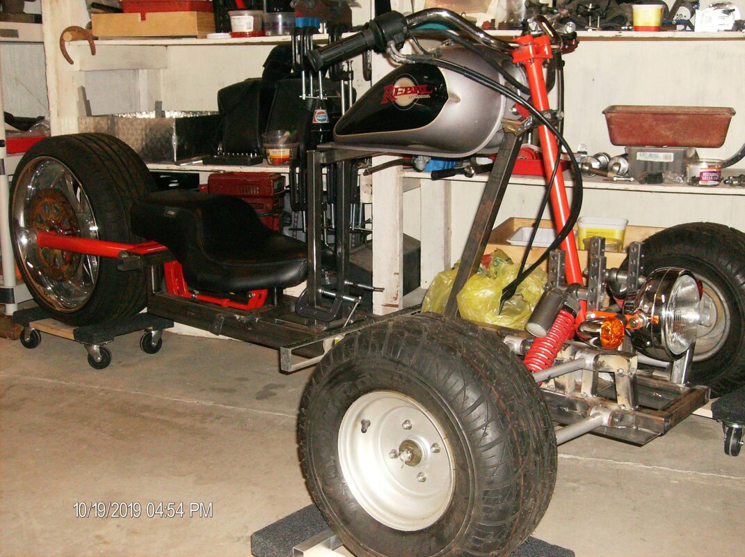

Size:  814.5 KBPlaying with a possible nose?, headlight? see through plastics, vent for engine???

    Love the tank

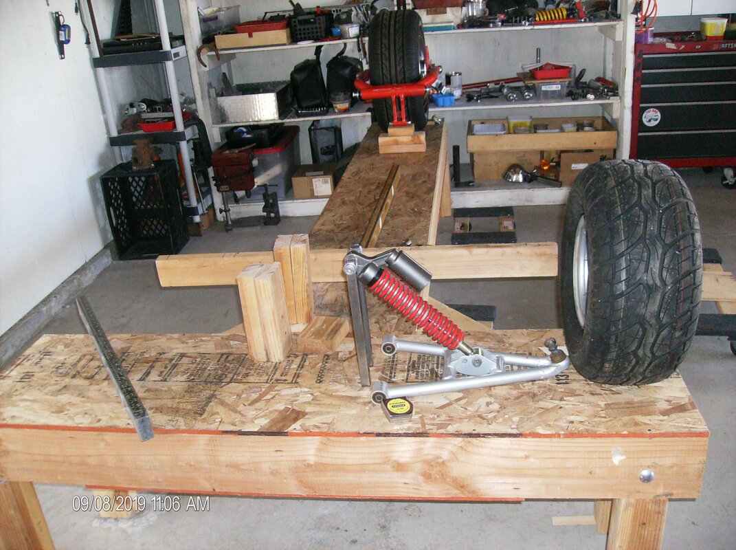

Size:  933.3 KBYeaaa!!! Engine out and ready to set up engine in trike, must remember height for jack shaft...

Size:  790.3 KBTook 5 minutes to put the engine in place and all day to level it out and measure for engine mounts,

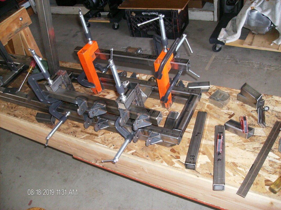

Size:  714.1 KBMotor mounts front and lower rear, single vertical rear frame is out because carb air cleaner will be in the way so duals will maybe work? Or maybe 45 degrees to side? AND maybe test fit exhaust??? HAPPY EASTER, Name:  Rabbit Sex.jpg

Size:  709.4 KBThis 1'sq x 1/8 should work, I wanted a one piece but the carb air cleaner would not work, sooooo!!!

Size:  771.0 KBDamn! Engine mounts NOT square to the width of the engine so my vertical frame has to be offset...

    cant put a joggle in the bracket?

    Did something shift during the move ? Bummer if the vertical frame is off and if it can not be corrected, I am with "can't you joggle the mount brackets so they hide the vertical offset ? It is your project and I am sure you already have an idea on how to correct it all. Hope it does not set you back to far on your progress.
