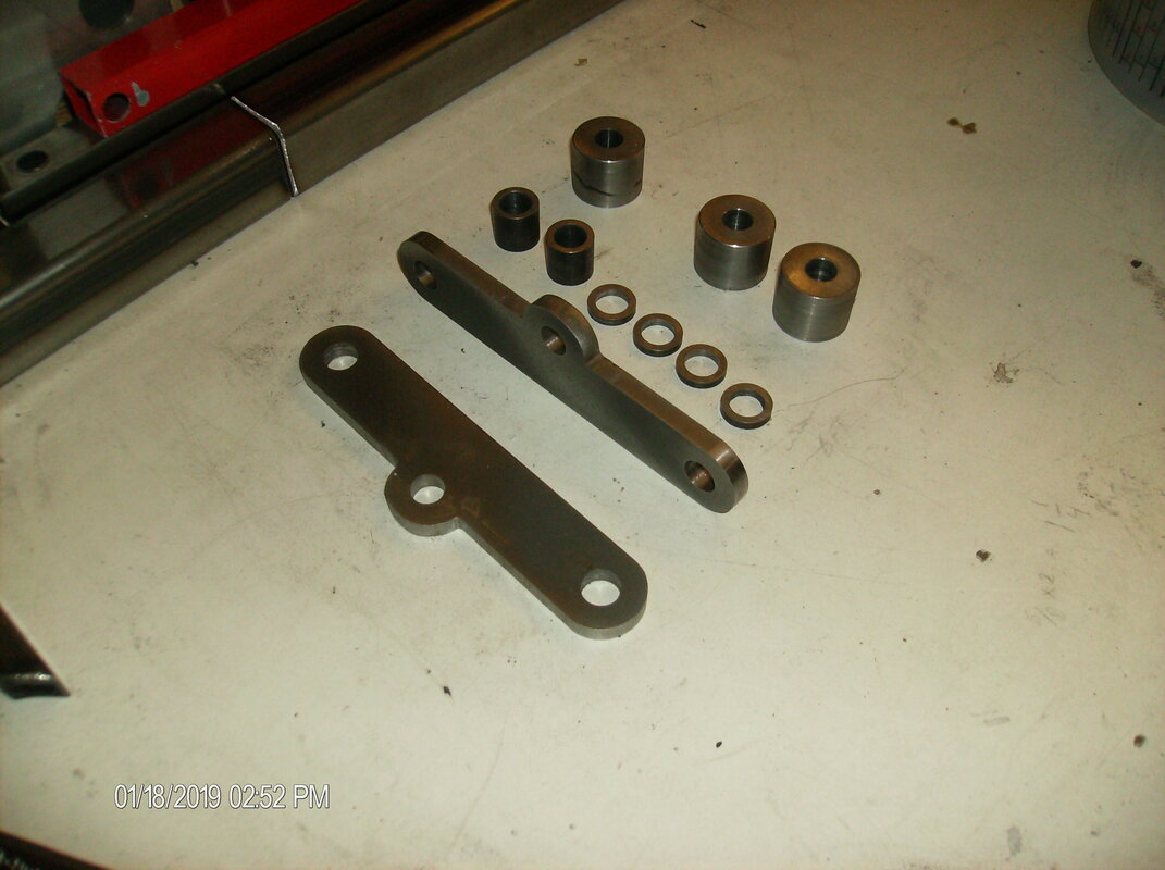

Size:  951.1 KBBack from the machine shop with the countersinking finished and trial fit,Name:  HPIM4054.JPG
Size:  959.5 KBName:  HPIM4051.jpg
Size:  670.8 KBName:  HPIM4053.JPG
Size:  959.5 KBNow I have 3/8 (.375) side clearance form sprocket to swing arm plus 1/2 the sprocket is .150 so this gives me .525 for 1/2 the chain, which is about 1.000 wide total, Measured the length for the axel spacers on each side, now to re-do the mounting bracket since the upper frame rail is going to be wider so that's next with the upper rails themselves widened, then to the jack shaft, more measurements tomorrow (Sunday) then off to my steel supplier for swing arm brackets 3/8 this time? and some tubing for the swing arm push rod and to figure the bell crank,

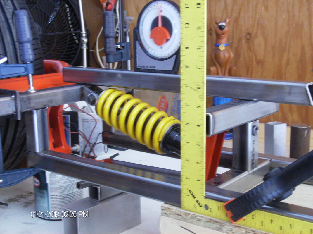

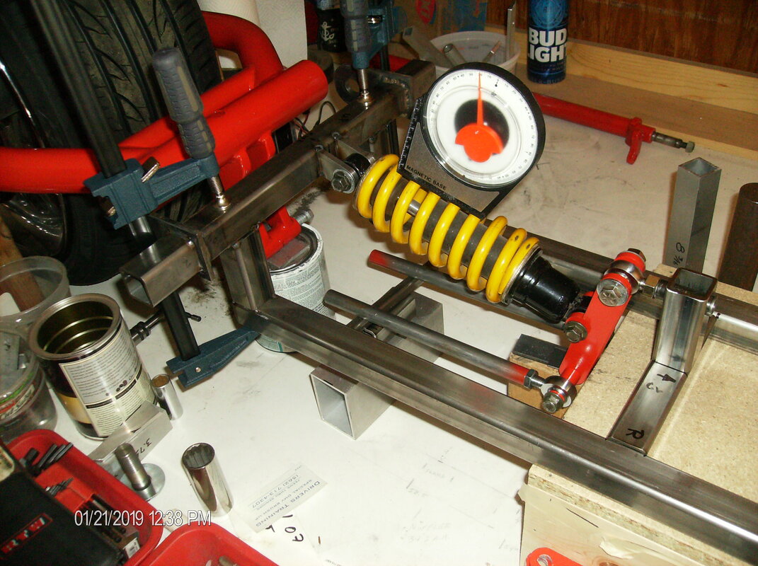

    Machined the axle spacers and paint, Name:  HPIM4101.JPG
Size:  941.0 KBNOT happy with the coil overs location...Name:  HPIM4104.jpg
Size:  729.8 KBThe push rod is a pull rod? BACK TO THE DRAWING BOARD...
    JakeJacobsen@Pinterest.com

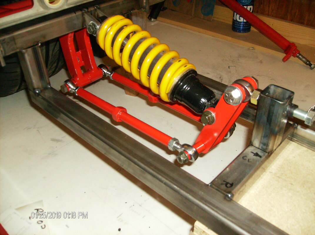

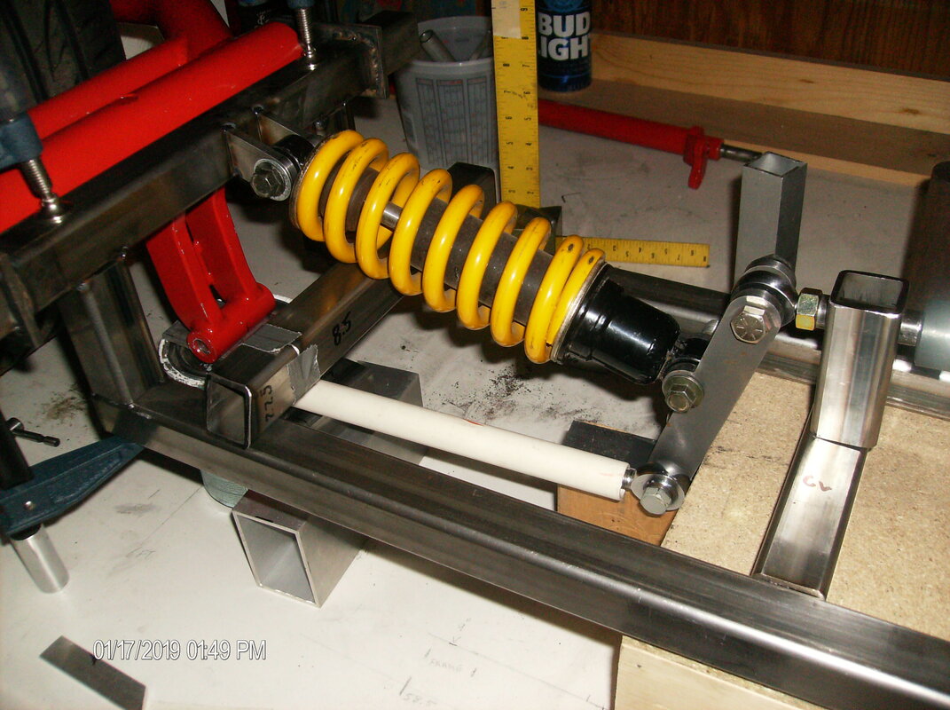

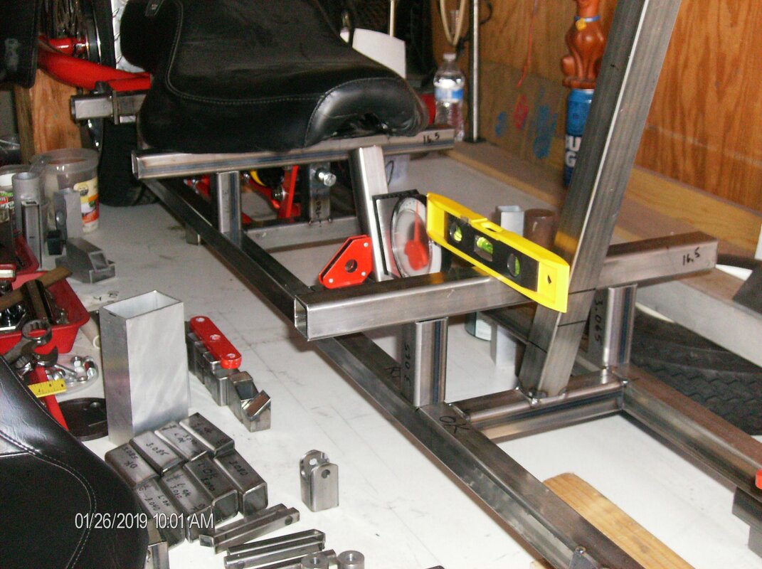

  8. #88
    600+ Posts TomyJ's Avatar
    May 2016
    Hemet, Ca. USA
    639
    Default RebelRouser

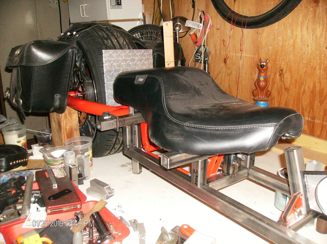

    Damn I hate doing things wrong, That's what I get for NOT being an engineer, (re-work)Name:  HPIM4111.JPG
Size:  950.8 KBThis should work?
  9. #89
    750+ Posts
    Jan 2010
    east windsor ct
    790
    Default
    Quote Originally Posted by TomyJ View Post
    yup that is the right direction one problem i might see is the swing arm where the wheel is attached much longer than the arm where the shock is mounted you need a short through super strong spring...but being light you might be okay the other potential issue the short travel on the connecting rod is so short it will may change the realized spring rate hope that makes sense it would help if you rotate the arm clockwise by moving the pivot to the front an lengthening the tie rod
  10. #90
    May 2016
    Hemet, Ca. USA

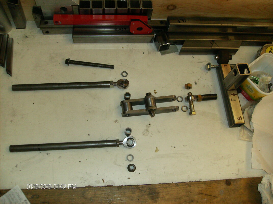

    639
    Default RebelRouser

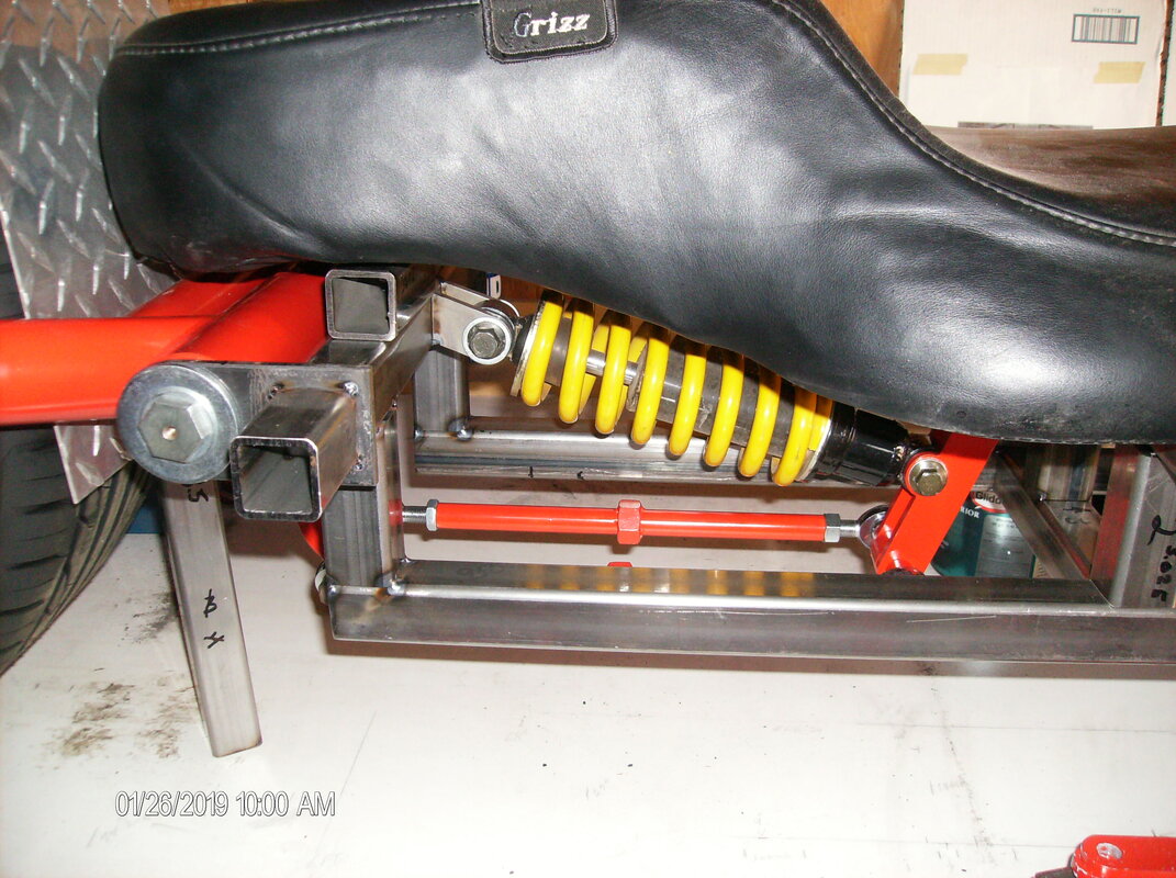

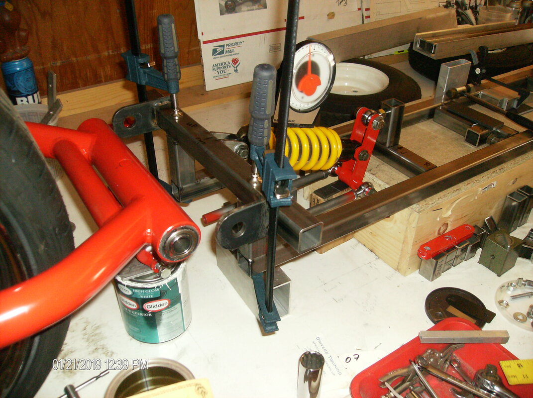

    Name:  RT coil over shock mock up.JPG
Size:  876.9 KBAnother view, OK drawings are made and tomorrow is time to buy material and visit the machine shop...

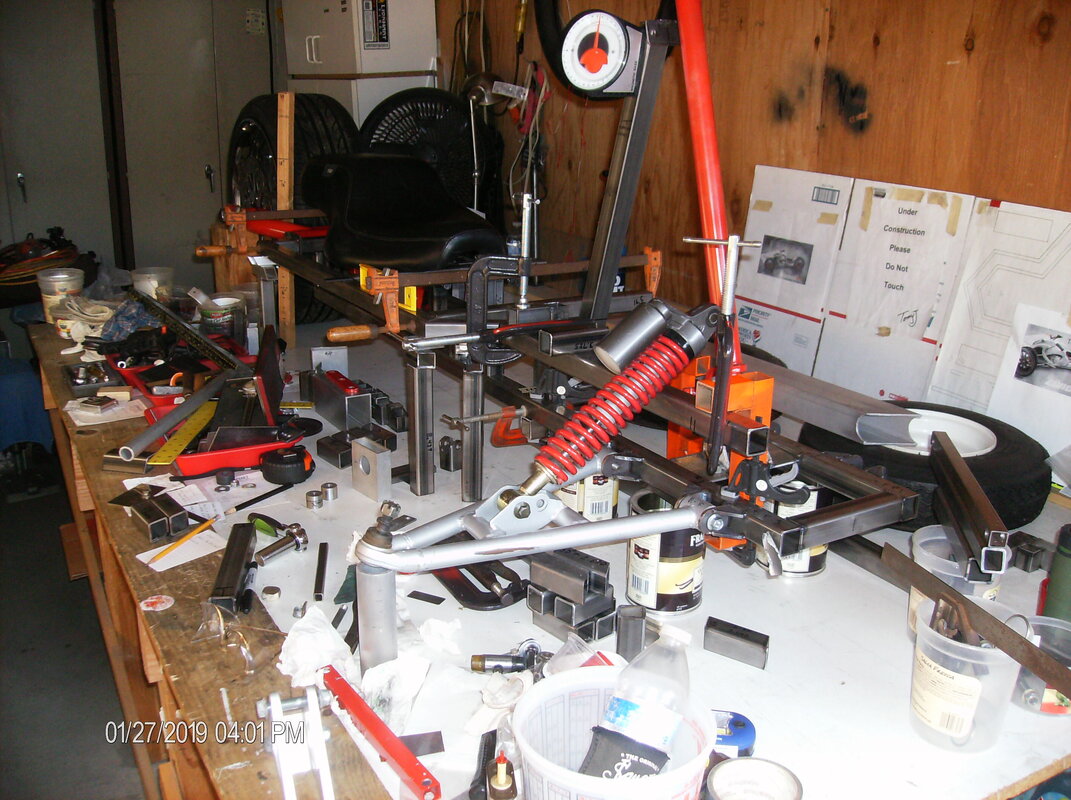

  11. #91
    500+ Posts LarryA's Avatar
    Jun 2016
    milnor n.d. usa
    548
    Default
    couple of considerations you may have already thought of.....make sure spring has side clearance to frame side....it will have a sideways rocking motion......maybe have spring cross member adjustable to fine tune ride height? or maybe your rear heim jointed link does that already?
  12. #92
    May 2016
    Hemet, Ca. USA
    639
    Default RebelRouser

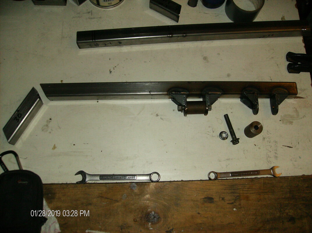

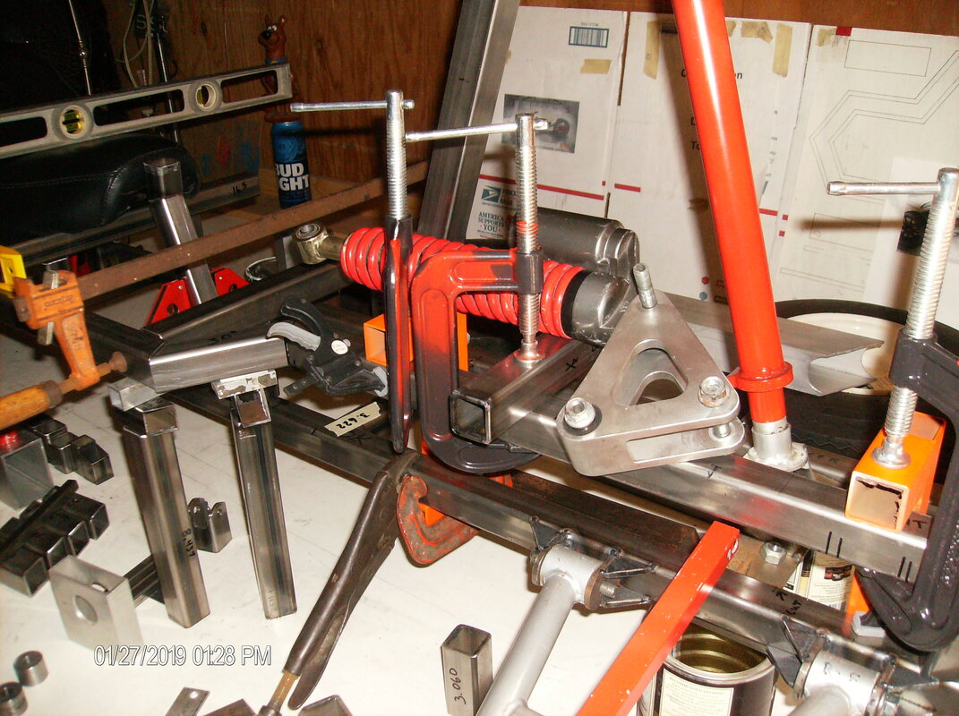

    Getting closer...Name:  HPIM4116.jpg
Size:  727.2 KBTying in the upper rails are next...
  13. #93
    May 2016
    Hemet, Ca. USA
    639
    Default RebelRouser
Size:  675.3 KBThis is going to take some time and maybe a rocker type end on the shock top for more clearance?

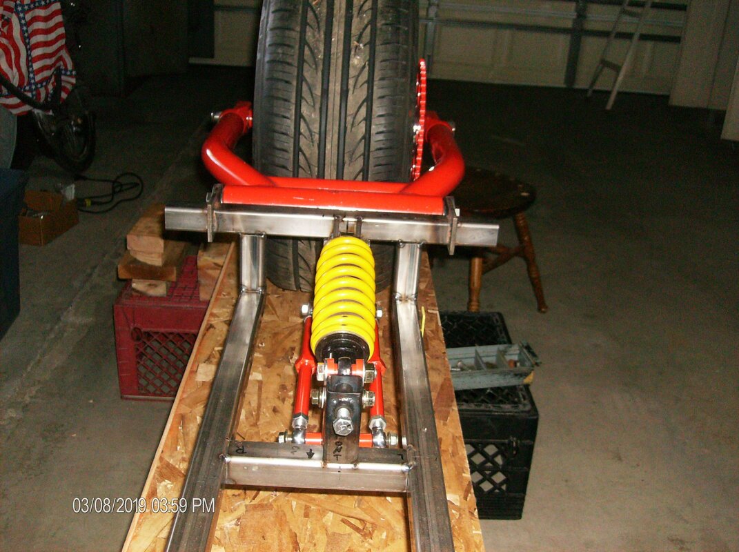

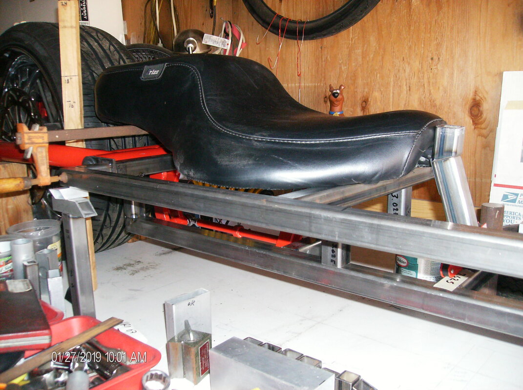

  14. #94
    May 2016
    Hemet, Ca. USA
    639
    Default RebelRouser

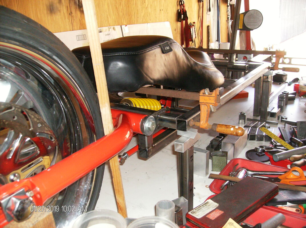

    More mock up, Things to do this week...Name:  HPIM4128.JPG
Size:  654.6 KBName:  HPIM4129.JPG
Size:  906.9 KBName:  HPIM4133.jpg
Size:  675.1 KBName:  HPIM4135.jpg
Size:  766.8 KBMaybe I should install the upper rails then the coil overs?

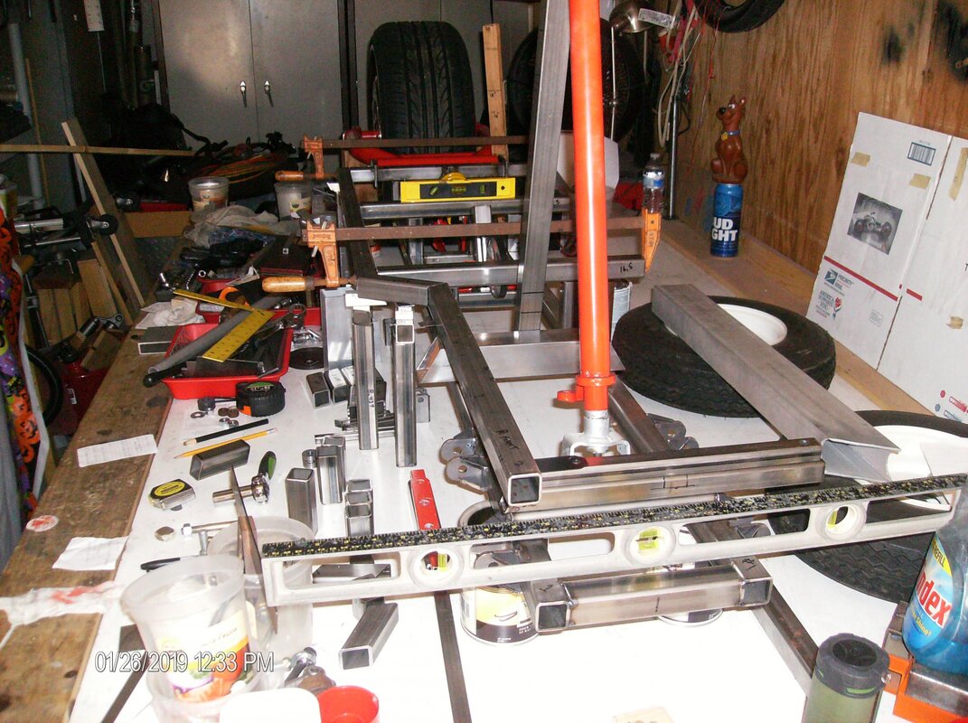

  15. #95
    May 2016
    Hemet, Ca. USA
    639
    Default

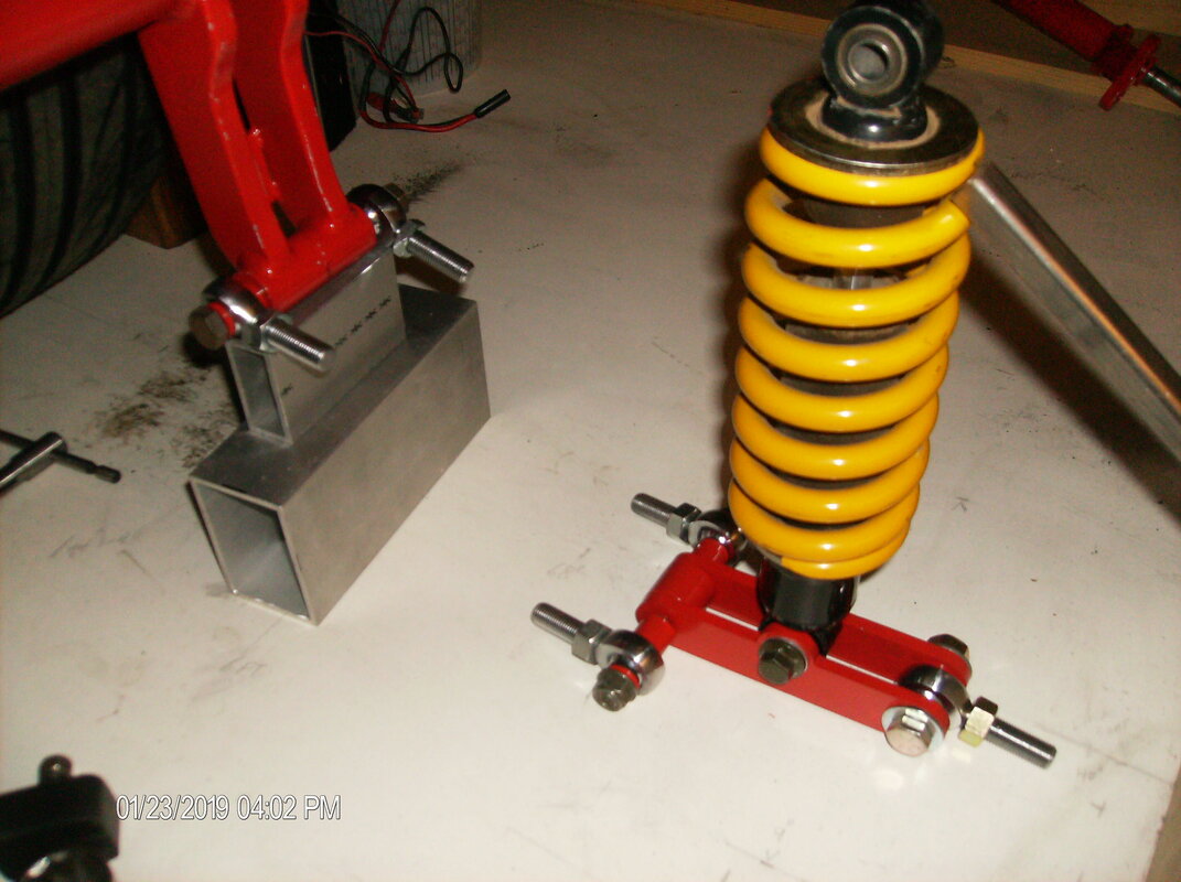

Size:  960.7 KBName:  HPIM4138.JPG
Size:  973.5 KBThis one is simple and much weight and height.Name:  HPIM4143.JPG
Size:  824.2 KBName:  HPIM4142.jpg
Size:  706.9 KB This is lower and compact to the rear and the weight of the shock is also supported close to the frame, I think I will go with this one? Please feel free for input...
  16. #96
    Jun 2016
    milnor n.d. usa
    548
    Default
    do agree w/staceyb about linkage ratios, thinking, for the long swingarm lever the 2 red coil overs looked as they had travel that matched the lever......another disadvantage with the rocker arm setup is 5 pivot points vs 2 with the red shocks.....true, will have higher cg and space taken up that may be needed by some other component. one idea... swing arm turned over with red lever pointed down..... yellow shock fastened to center of swing arm crossmember, shock angled forward and down......link rods fastened to red lever ( that is now hanging down) link rods travel forward and up to meet a pin that ties link rods to both sides of shock, a guiding tube or mechanism would control the tie bar, some what like a crosshead on a steam engine, as the shock pushing forward pulls the link rods forward,which pulls the red lever forward which pushes the rear wheel down, thus suspending the frame.... LOL hoping this makes some sense?
  17. #97
    May 2016
    Hemet, Ca. USA
    639
    Default
    Quote Originally Posted by LarryA View Post
    ...You just gave me a headache...
  18. #98
    Jun 2016
    milnor n.d. usa
    548
    Default
    TommyJ......lol....I had a headache when I wrote that post, it got worse later!......very unconventional to say the least. but basically an >- with the shock on upper part of the > The strut rods on the bottom pulling the swing arm lever forward, and the - a stabilizing guide to keep the junction of the shock and rods from moving up/down or left and right, but only forward or backward. there would losses because of the angle of the shock to the rods, the guide mechanism would have side forces also......all things considered, this idea should perhaps be headed to the trash bin!
    PS I have not seen this idea used before, probably with good reason!

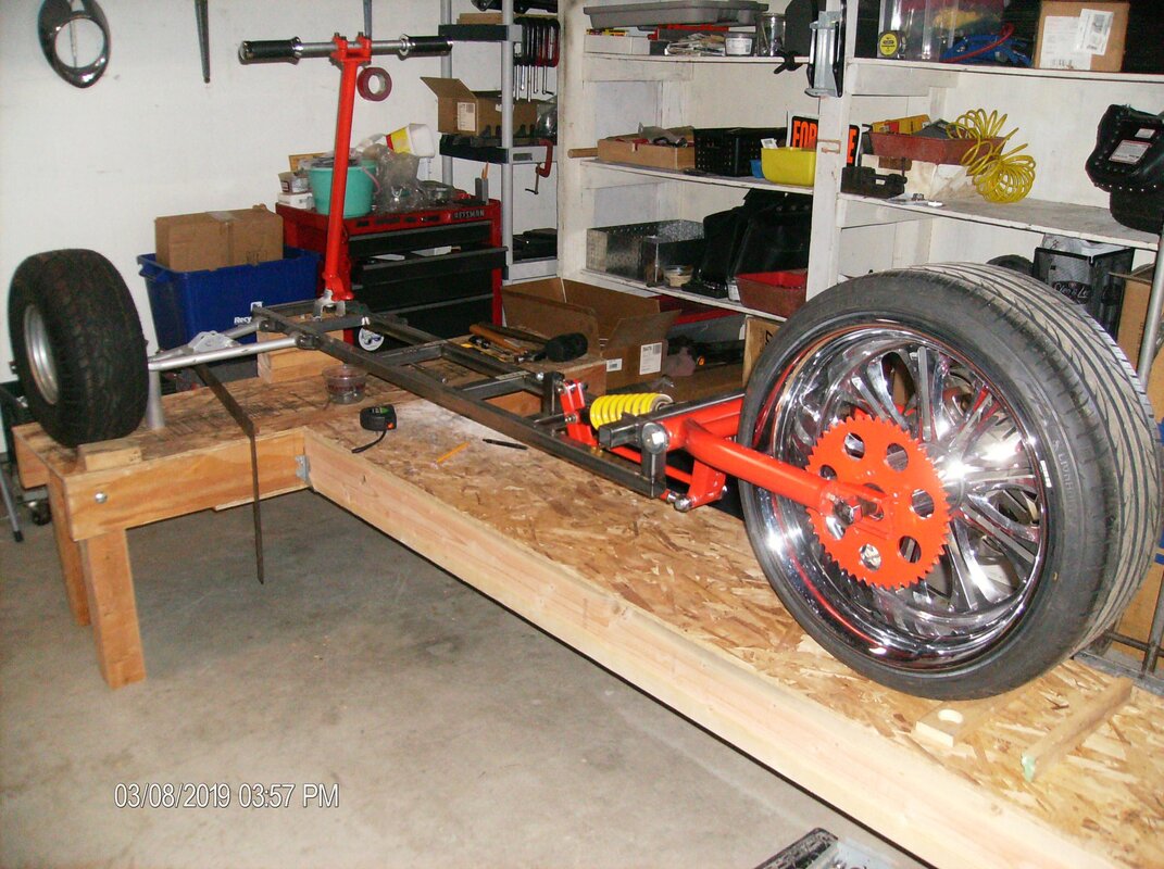

  20. #100
    May 2016
    Hemet, Ca. USA
    639
    Default RebelRouser
    Name:  1-Merry TrikeN Christmas.jpg
Size:  552.8 KBOK, OK, Ok... One more mock up, then the upper frame rails and upper control arm brackets, then mock again with steering, And will be on the ground at this point. Dec 30 is motorcycle swap meet, I'll be looking for twin shock and jack shaft sprockets, 3.5" and Harley 530 chain and Honda 520 chain AND...
    To all of you my friends Thank You and Happy New Year... With all our trikes running in 2019
