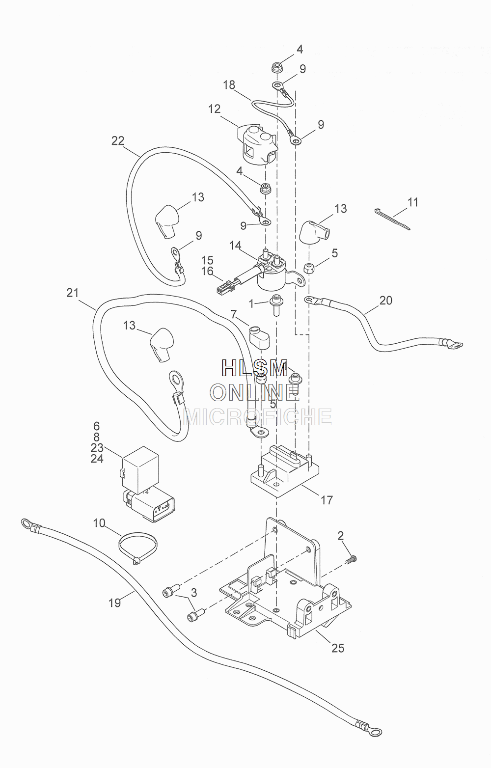

    Having a problem with my reverse; engine running, in neutral, press reverse button and wait for it to light up steady. Once it does all I get is a clicking from the RCM solenoid. Breaker not tripped, checked voltage before and after breaker and RCM solenoid while pressing the reverse button and getting a little over 14 volts.
    Pulled reverse motor and bench tested it and it seems to operate fine, checked voltage at the reverse motor connections and still getting a little over 14 volts with the motor running. Cleaned all of the connections and reinstalled, same thing just a clicking at the RCM solenoid.
    Any ideas?
    Thanks in advance for any suggestions,
    Red

    Do you have the trike service manual?The reverse motor diagnostics are in there along with beautiful diagrams that I could study for hours.Okay I need a life.One of tips given is to raise the rear wheels on jackstands before testing.Clamp an induction ameter at the + cable next to reverse motor,start engine -turn on reverse motor, draw should be 90A not exceed 150A.

    I'm confused. How can the reverse motor draw 90 amps when it's on a 50 amp breaker?

    I'm seeing a 150A manual reset circuit breaker [252A].Are we talking about the same thing?

    My Freewheeler has a 50 amp breaker for the reverse motor under the right cover where you air the shocks.

    My 2017 Tri's circuit breaker is rated at 150 A....#83869-09.....

    You really think there's a circuit on these trikes drawing 150 amps?

    Stop being coy.Im not an engineer. I drive a big truck cause I flunked rodeo clown school.If you think the service manual is wrong please tell us why.

    It's electrical common sence. If you take the right cover off and look at the breaker, it says 50A on it.
    I don't have a service manual yet. I'm talking about the trike, not a book.
    I'm not an engineer either, but the military sent me to the college of electrical knowledge. Look at your dwelling breaker box and see how many 150 amp breakers there are. Maybe the main, but that would be it.
    Look at your trike.
  17. #17

    A 220 volt 3 phase 60HP motor draws 150 amps
    (just offering a point of comparison.... I am an engineer )

    While I slept last night aliens descended onto my garage. They implanted this strange component in my FLRT.It has weird markings-here they are:HI-Amp, Buss,150A.Waterproof(sure), 1855150F. Oh please tell me what could it all mean???
