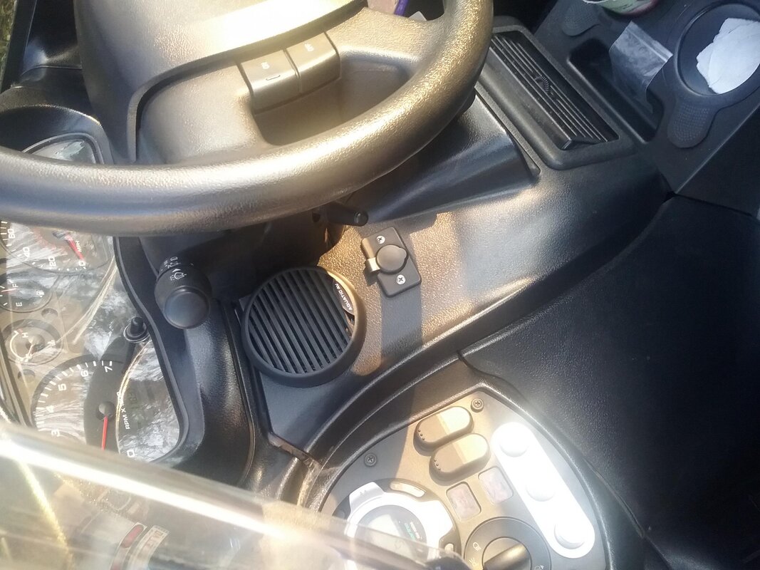

Size:  488.4 KB For some reason I cannot get this photo to rotate? My lighter plug is under the steering wheel. Tomg

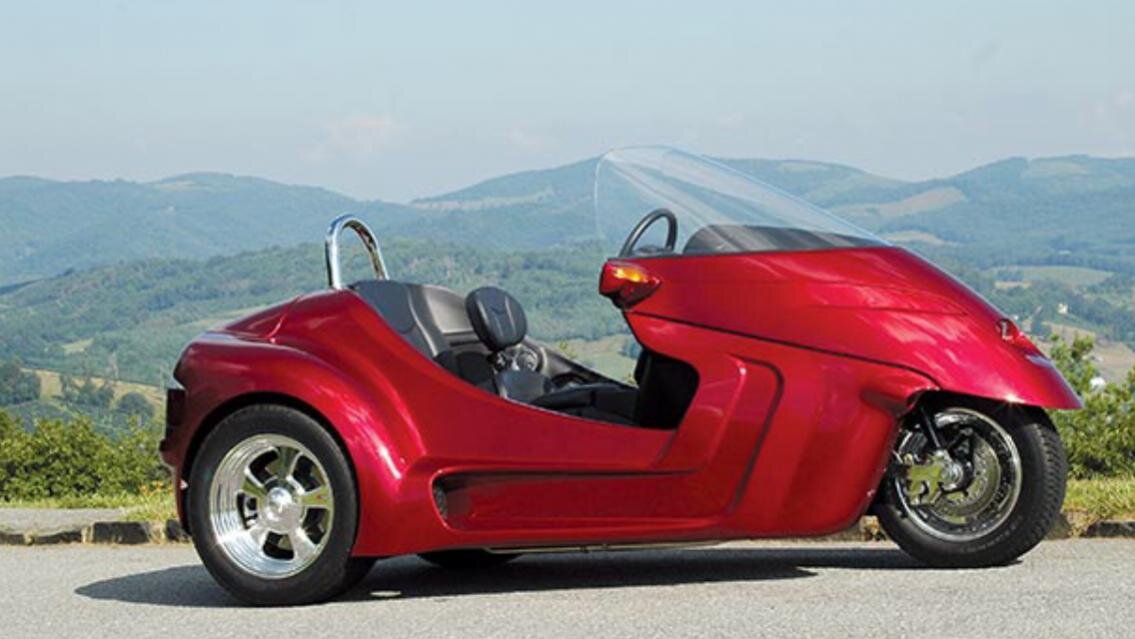

Size:  71.6 KBThis is a Stallion

    Quote Originally Posted by trikervet View Post
    Burnerboy, if you do a search "Stallion Trike" you can read all kind of info on them including videos on Youtube. Also you can do a search under "Thoroughbred Motorsports."
    here mine

    Quote Originally Posted by tomg View Post
    Did you install the lighter plug or have it installed? If you installed it or maybe you can answer this for me, how do you remove the panel that your lighter plug is installed in? Also is that a speaker in the picture above the plug? If it is a speaker, is it water proof? If yes where did you find a smaller one like that?

    Quote Originally Posted by Greg336 View Post
    Thanks,
    Greg
    I installed it. Open hood, 2 screws on each side top by steering wheel , take out drink holder and remove screws, tilt steering wheel full up, remove center section carefully as there's wiring for the light connected (on 09 and up year but not sure about 08). I ran a hot wire to the fuse box and ground wire to a bolt on the frame. Make sure to measure location for the plug as there is framework to get it in between. Bought the plug at Ace in the boat section. Hope this helps. Yes marine speakers from RocktheBoat.com tomg
