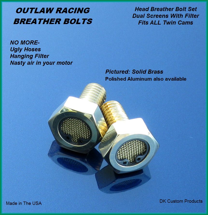

    Default This is an older thread, but have another question....
    DK offers brass breather bolts so you don't have to have the EBS with hoses and a filter at the end of them. How do these breather bolts work? Where does the 'gunk' go to once it reaches the end of the bolt and filter? Do these have to be cleaned more often than the 'normal' EBS offered by DK?
    Thanks!

    These have a foam behind the screen. Remove the snap ring and clean them, re install. The oil and vapor will exit thru the foam and screen. Depending on how tight your engine is and how well your oil pump works you should not have too much mist coming out of these breathers. I have them on my M8 FLRT they work good

    um yeah.... shows you have a 2018 triglide - not the bolts you need the breather kit. The bolts won't work. So you route the hose from the kit up to the frame under the tank and run it under the seat to end up in the 'tray' that is under the rear seat. I highly recommend getting the new version of the can when you get this.

    Jack, thanks for the reply. So I'm assuming I was correct in thinking that if I use these, then I won't need the hoses and hanging filter. What's the drawback using these? It seems like it would be much simpler and a cleaner look. Maybe it doesn't work quite as well or cleaning would have to be done more often?
    I've got a 2018 with just under 8,000 miles and stock as far as engine/headers/exhaust go. I have done all the cooling mods with the exception of the oil filter relocation kit and want to add the stage 1 air cleaner from DK.

    Thanks for the feedback. DK's site says that these work on TC and M8's. Is there something I'm missing?
