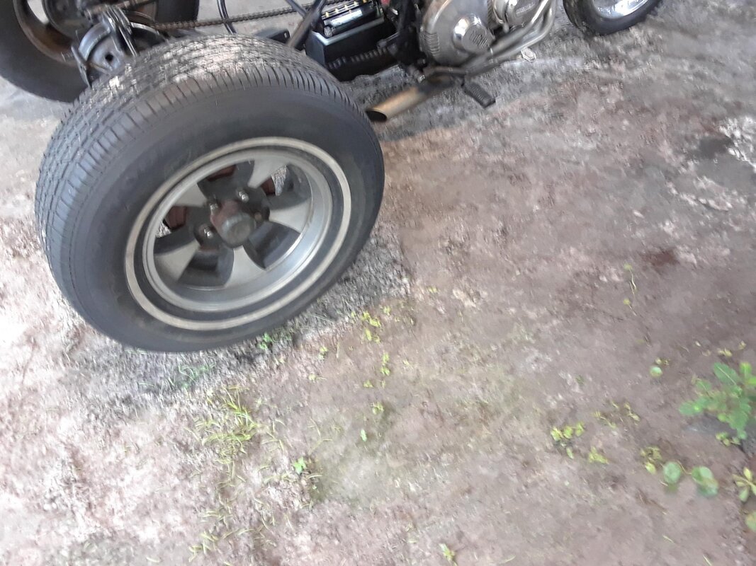

    I have not posted on this site in a very long time. I sold my bikes and my trikes and all I had left was a couple of helmets. Well now that has all changed! This past Sunday I got an Amen Savior Frame Honda 750 and Monday I got a 1978 750 Hondamatic front frame attached to a 1956 Harley Servi-Car. If you're gonna spend your money spend it on something good. My oldest son wants the Amen and I plan to keep the Half & Half for myself. Just buying parts and trying to learn where to put them.Name:  PHONE PICTURES 117.jpg

    There are no brakes on it at the moment. I ordered new wheel cylinders and master cylinder for the rear as well as some parts for the front disc brakes. The rear wheels are at Tire Kingdom getting new rubber and I need to get a front tire too. It needs some wiring and tail lights. I think I will be busy.

    I got all the brake parts on and bled. I still need to do it again sometime in the near future to make sure everything is good to go, or should I say whoa. I mocked up the back, the fenders, a different tank, the red one, the springer, and the spoke 21" wheel. Getting there mainly waiting for stem bearings I ordered yesterday. I don't know why the first picture is upside-down. I think I like the style of the red tank better. It won't be red long if I do use it.
